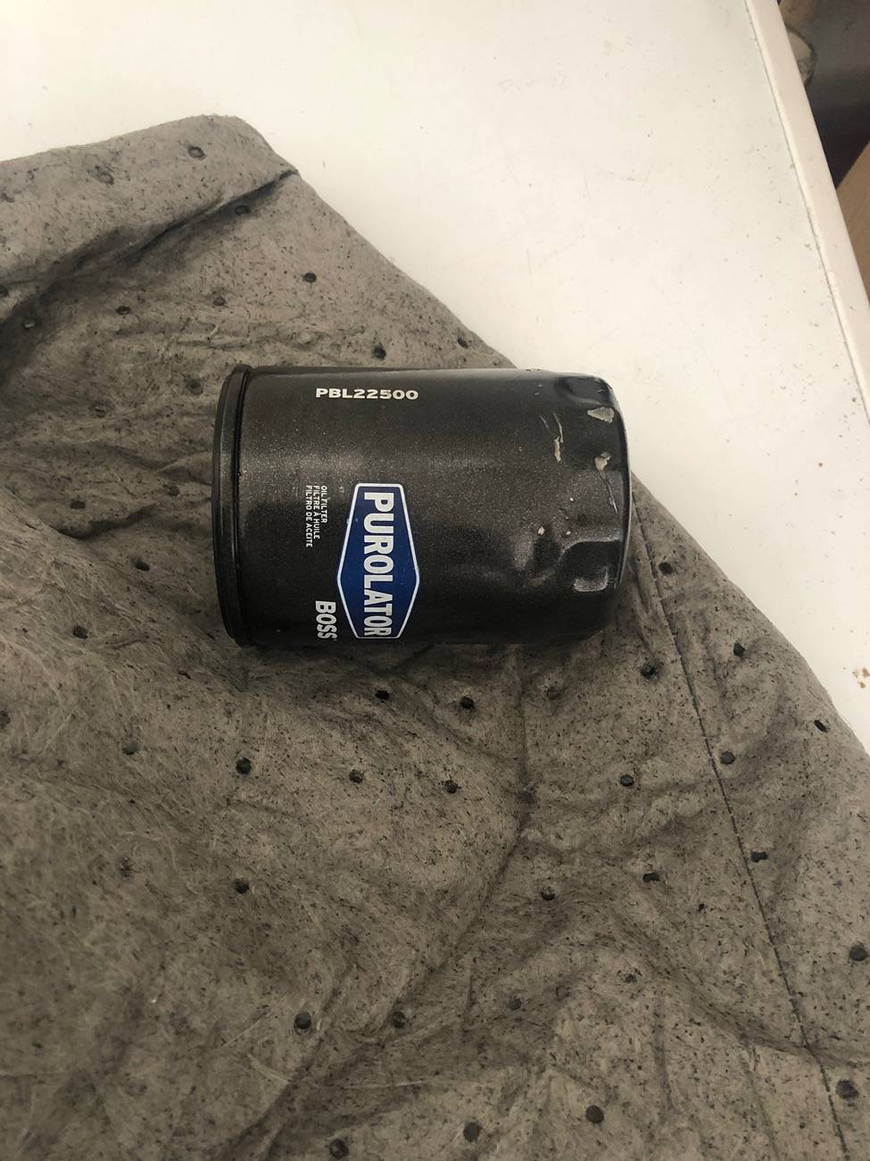

Hello! So I just did my oil change on my preowned 2017 Mustang GT, I put on a new filter, tightened to spec, drain plug to spec, everything. Filled it up with 8 quarts of oil, started the motor for 10 seconds then shut it off and checked my oil level. Seemed good! After a little bit of driving, I got back home and could have sworn I heard ticking coming from my motor. And I know this sound is new so I’m worried, I checked everything for leaks when I did the oil change and an hour later after driving to the store and back, and nothing. It’s the lightest little tick but it’s noticable since I’ve never heard it before, what could it be?
(To answer prior questions, total miles rn is 34000, auto, I’ve done a few mods and gotten a lund tune)
Does yours tick like this on the video? If it does, I got it fixed by using this filter at each oil change. No more problem.

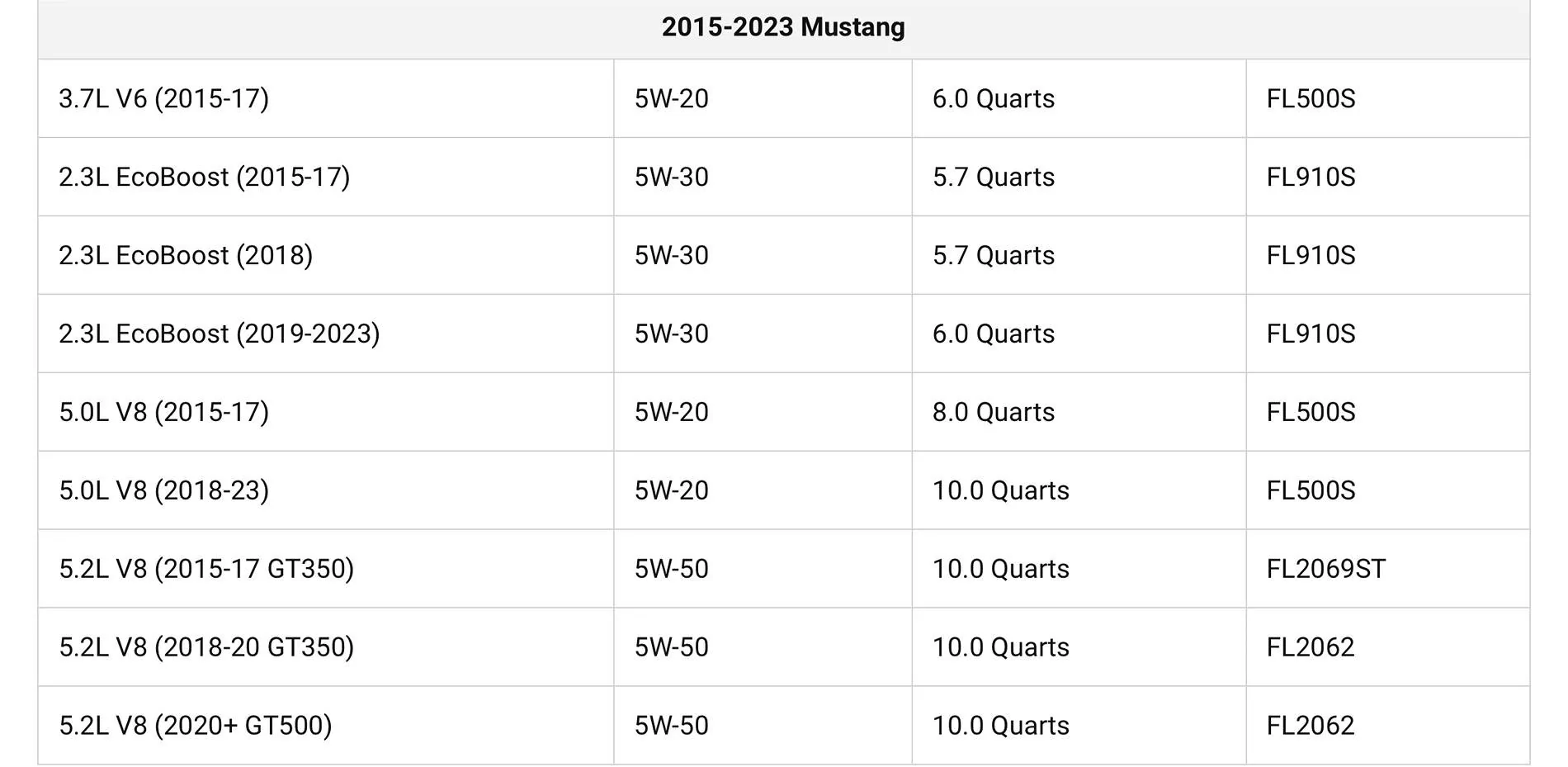

GT takes 10 quarts of oil and you put in 8.
