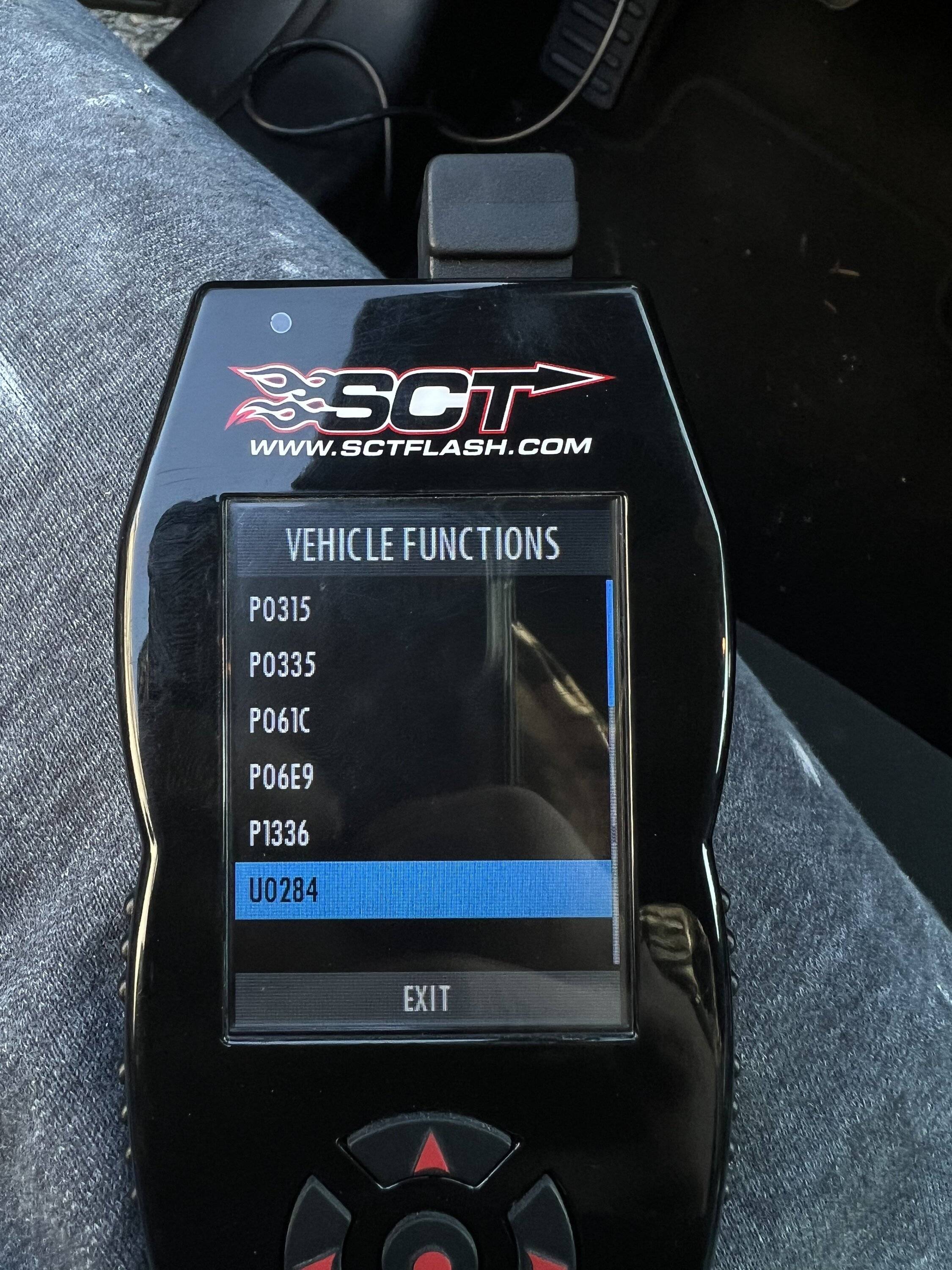

I cleared all my codes and started the car and proceeded to do a crank relearn. As I was revving up, around 4K rpm it wouldn’t let me go any higher unless I actually give it way more throttle. The engine sounds fine until I rev up to 4k rpm or higher, then it misfires. Also crank relearns keeps failing. Not sure why. Could it be bad flywheel?
This is what the engine sounds like on idle. Is that engine knock I’m hearing? (Smoke is from oil dripping onto the headers)

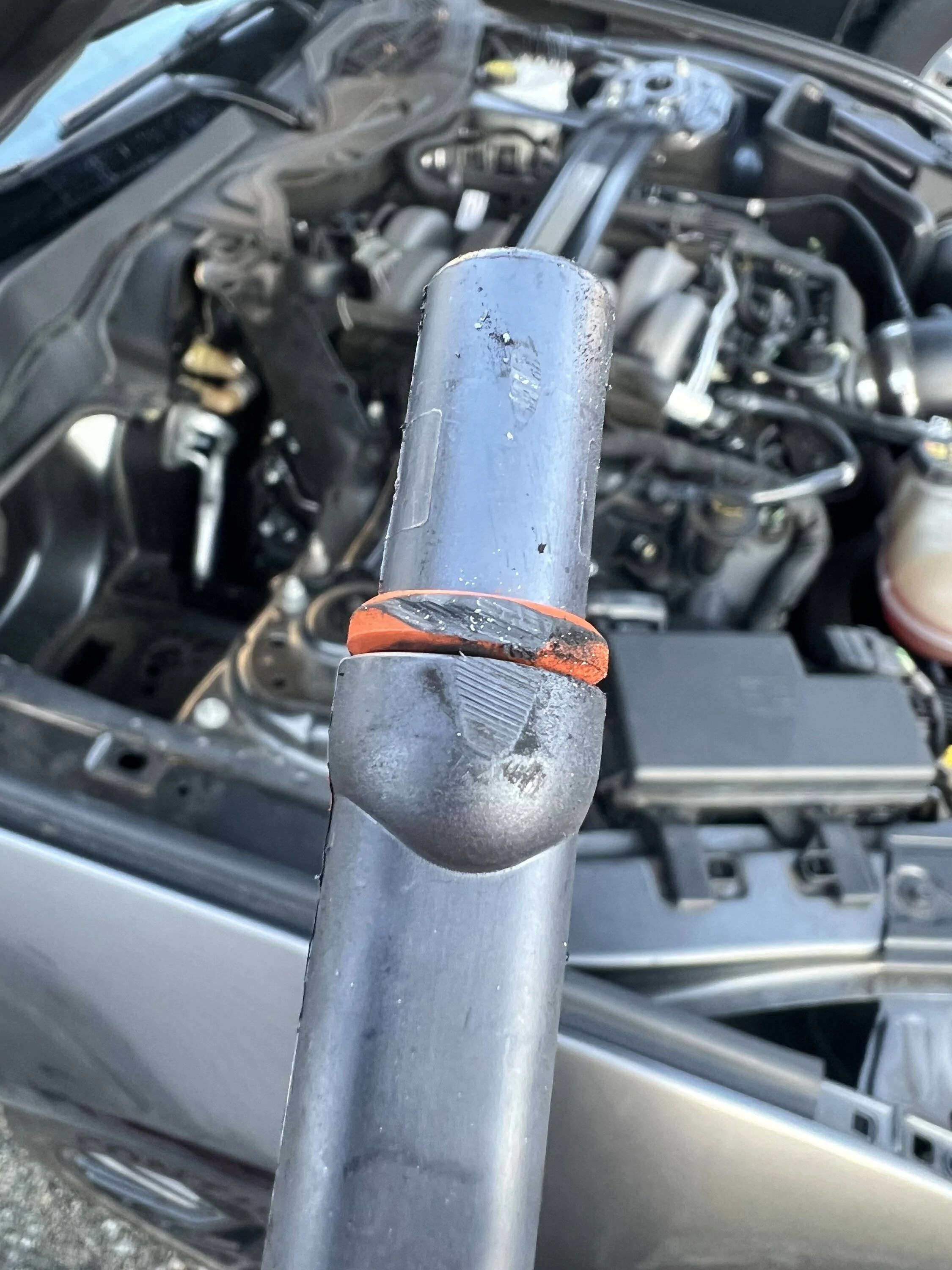

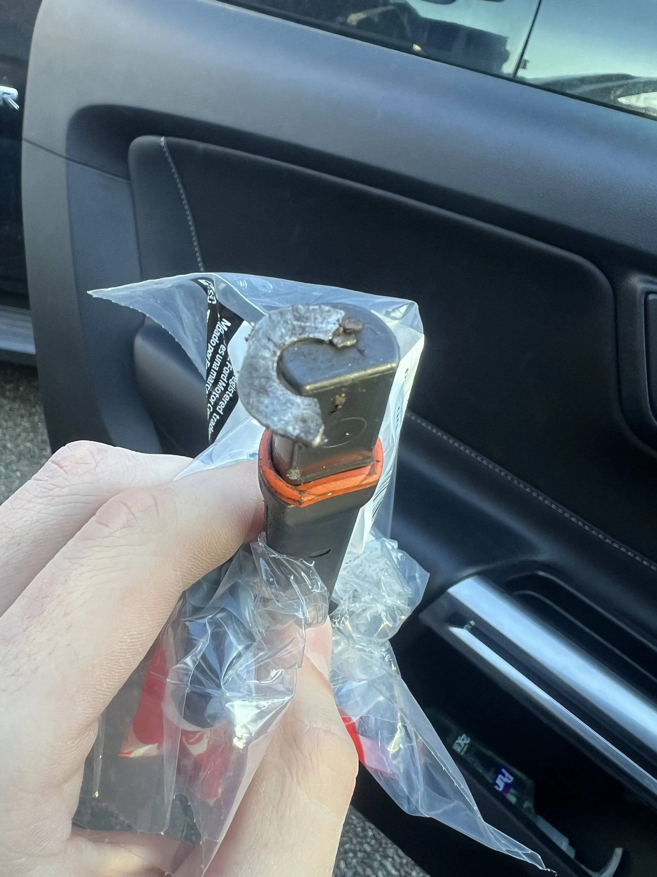

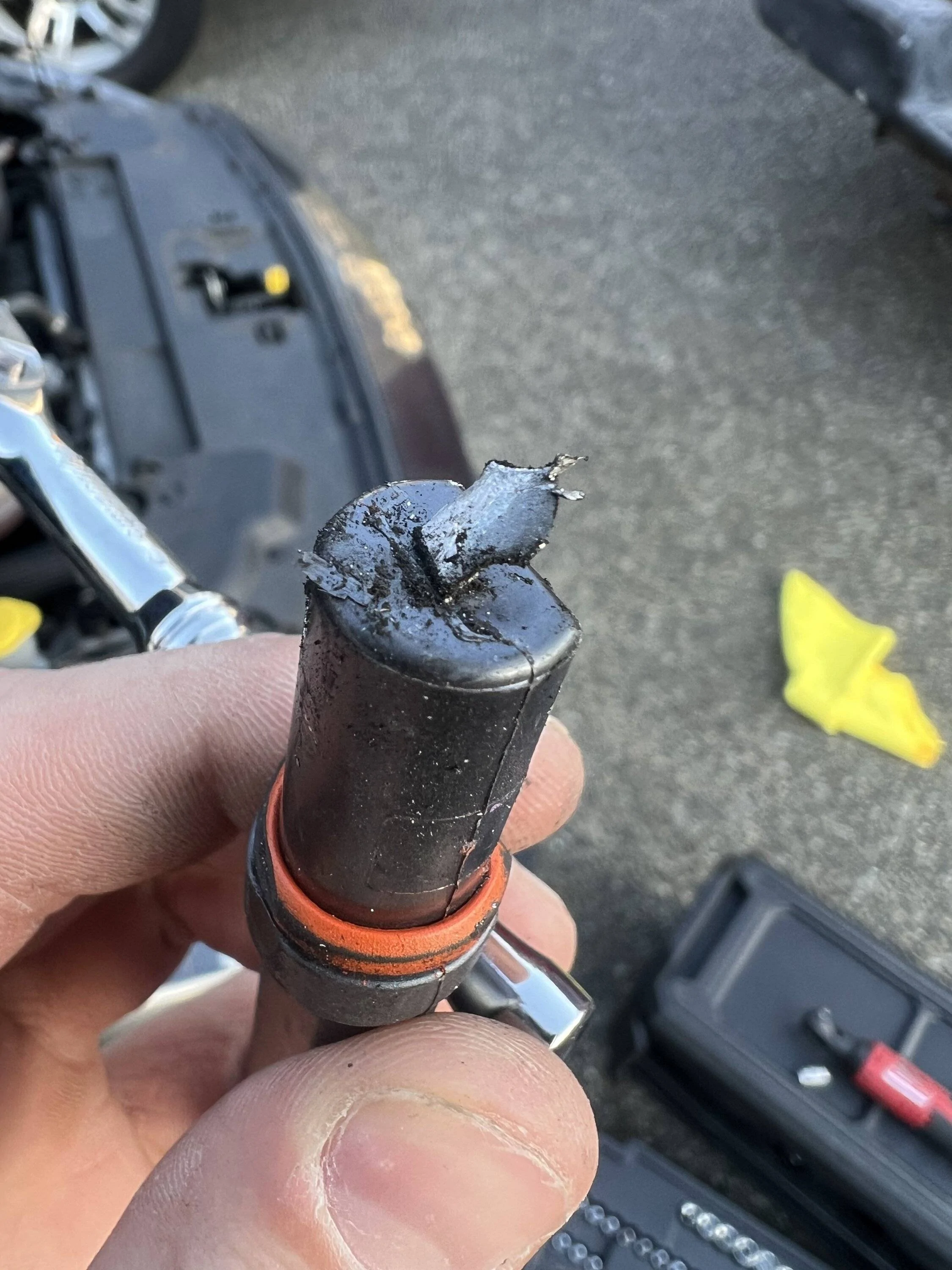

Also attached pictures of the new crank sensor after trying to do a crank relearn. It looks like a washer stick to it maybe? I’m not sure what that metal shaving can be. Also the new sensor looks like it got shaved down a bit? Not sure what my next move is here… (besides towing it to the dealer to figure it out)

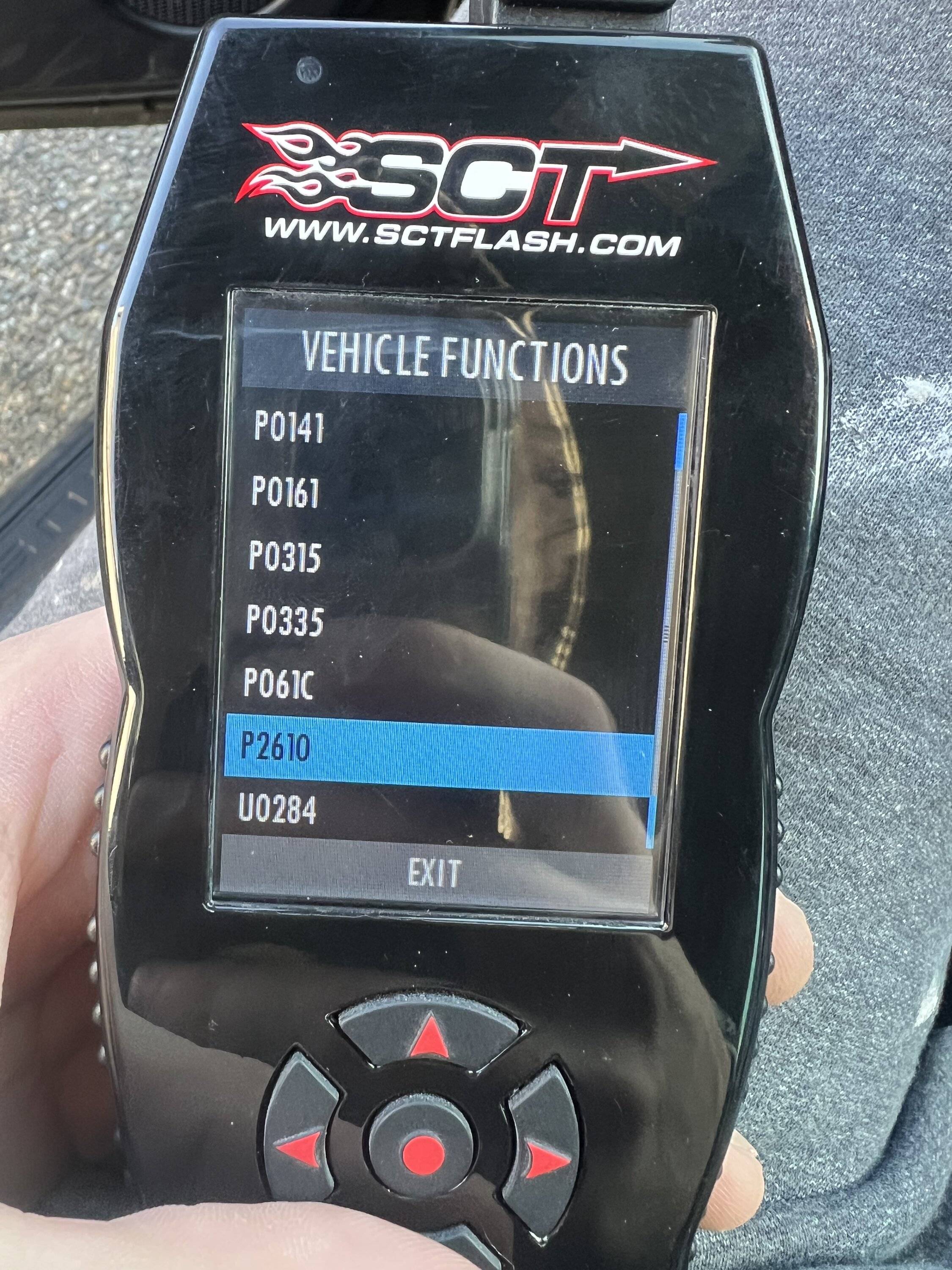

New codes pictured below. (I’m aware of the O2 sensor codes / Shutter grille code)

Update: I installed the sensor (yes in the correct position) and started it up. Same results… I checked wiring with a multimeter and everything looked good.
1) Is the sensor you purchased a Ford sensor or aftermarket? If aftermarket, is it longer than the original one you have removed?
2) There should NOT be ANY any major debris stuck to the sensor, embedded into it - or that the sensor comes out “shaved” or damaged. Yes, normal wear will have minute metal particles stuck to it, like “fuzz”, but definitely not large pieces of metal as seen in your image.
Seeing your image of the shaved sensor, I’d suspect at this point, without actually seeing the tone ring, that the tone ring is possibly damaged…. I am unable to determine what that debris could be from, but if you have an MT82, possibly from the clutch assembly? Or maybe a washer from the tone ring?
Once the tone ring is damaged such as coming in contact with the crank sensor, a new crank sensor won’t matter because reading of the tone ring teeth will inaccurate.
See this thread for Tone ring info:
https://www.mustang6g.com/forums/threads/p06e9-dtc-no-start.150022/page-2#post-3066365
To replace or service the tone ring requires removal of the transmission.
See this thread; the first image in it, the round circular toothed object on the floor directly below the engine - that is the Tone Ring. It gets placed onto the back of the crank so the Crank Sensor can read it (also seen in the image):
https://www.mustang6g.com/forums/th...utch-install-and-flywheel-bolt-warning.87130/
OEM sensor from Ford. Thanks for the heads up on the tone ring. I think I’m giving this job to the dealer to handle. Too much for me in my driveway.

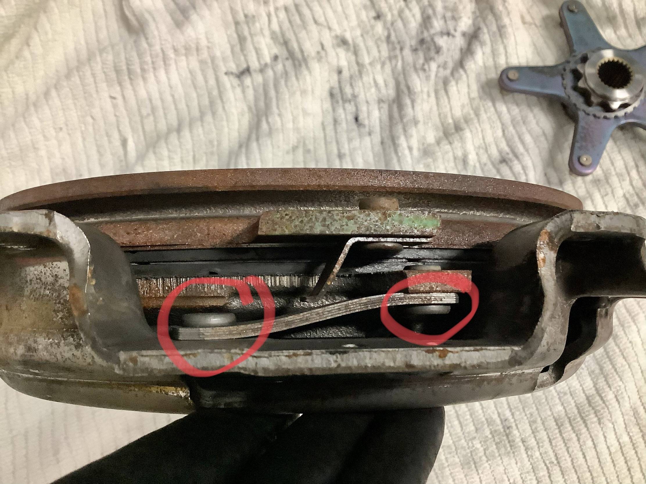

Based on the photo of the washer looking piece that’s attached to the crank sensor, I’m going to guess that one of your straps broke (area circled in red) and that’s what you’re seeing on the end of the crank sensor. Of course some of that debris could have also taken out some teeth on the crank trigger wheel as well.

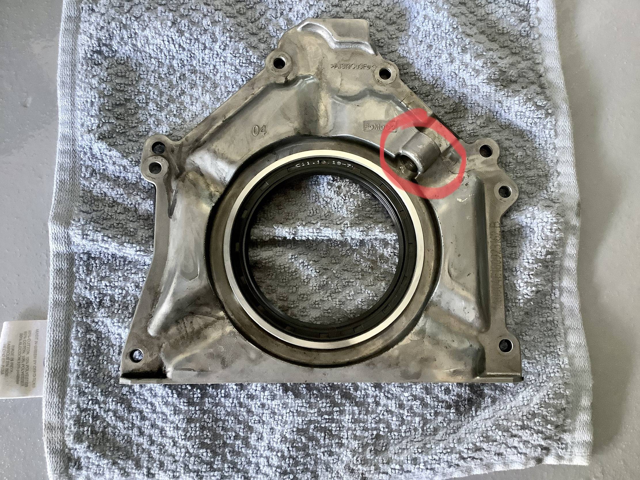

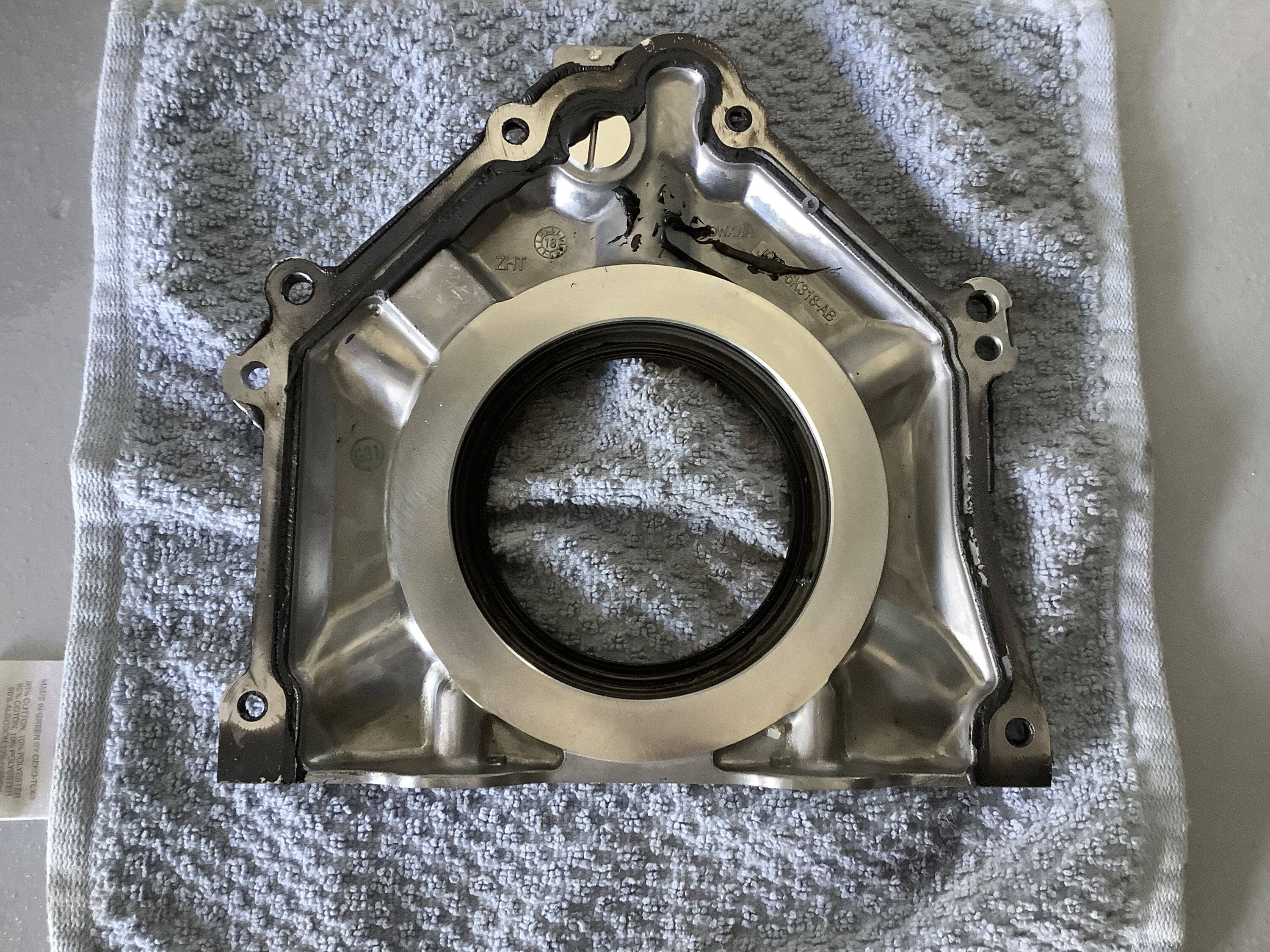

The other thing I see is, the damage to the crank sensor could have been caused by inserting it into the sear main seal plate at an angle. Here’s what that factory plate looks like.
Rear view
Front view
Rear view
Front view
