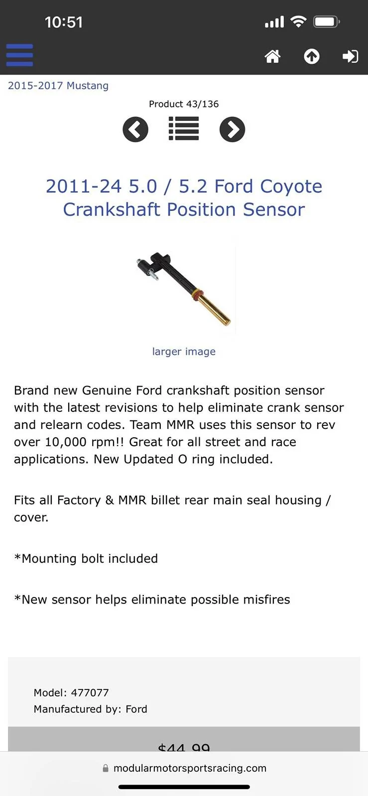

MMR has a crank position sensor that's supposed to help with that.
