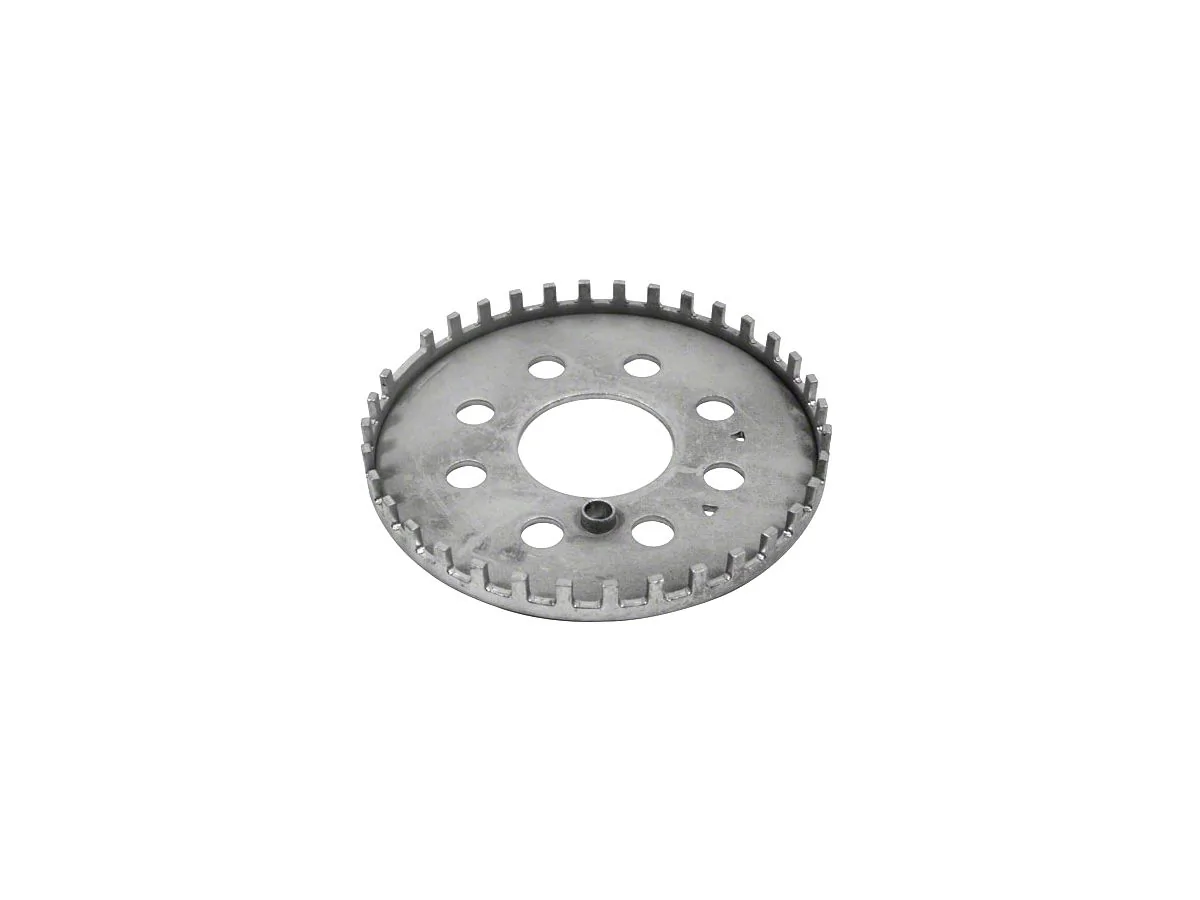

Dennis - attach a pic of that tone ring for future reference if you have not already reinstalled.
Sorry for the late reply but here’s the tone ring cheers!!
