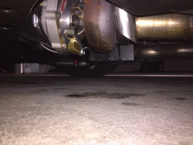

Well, I did find an oil leak coming from the drivers side Turbo lines today I didn't notice Thursday. Not sure if that would cause all the codes and for the car to go into Limp/Safety Mode.
Don’t think an oil leak is the issue. Bank 2 is the drivers side and your misfire is also drivers side.
If your SCT can do a crank relearn, I’d try that if engine running now, or carefully check the wiring harness on the drivers side and check that everything is plugged in and no wires pinched or broken. Clear codes, if they come back you probably got more serious issues.

Looks like you need to get under the car and tighten all of the oil drain fittings, that's not a big deal. An oil leak is not causing all of those codes though, something else is going on. I have a sleeper kit on my 2016 and have never thrown a single code (knock on wood).
