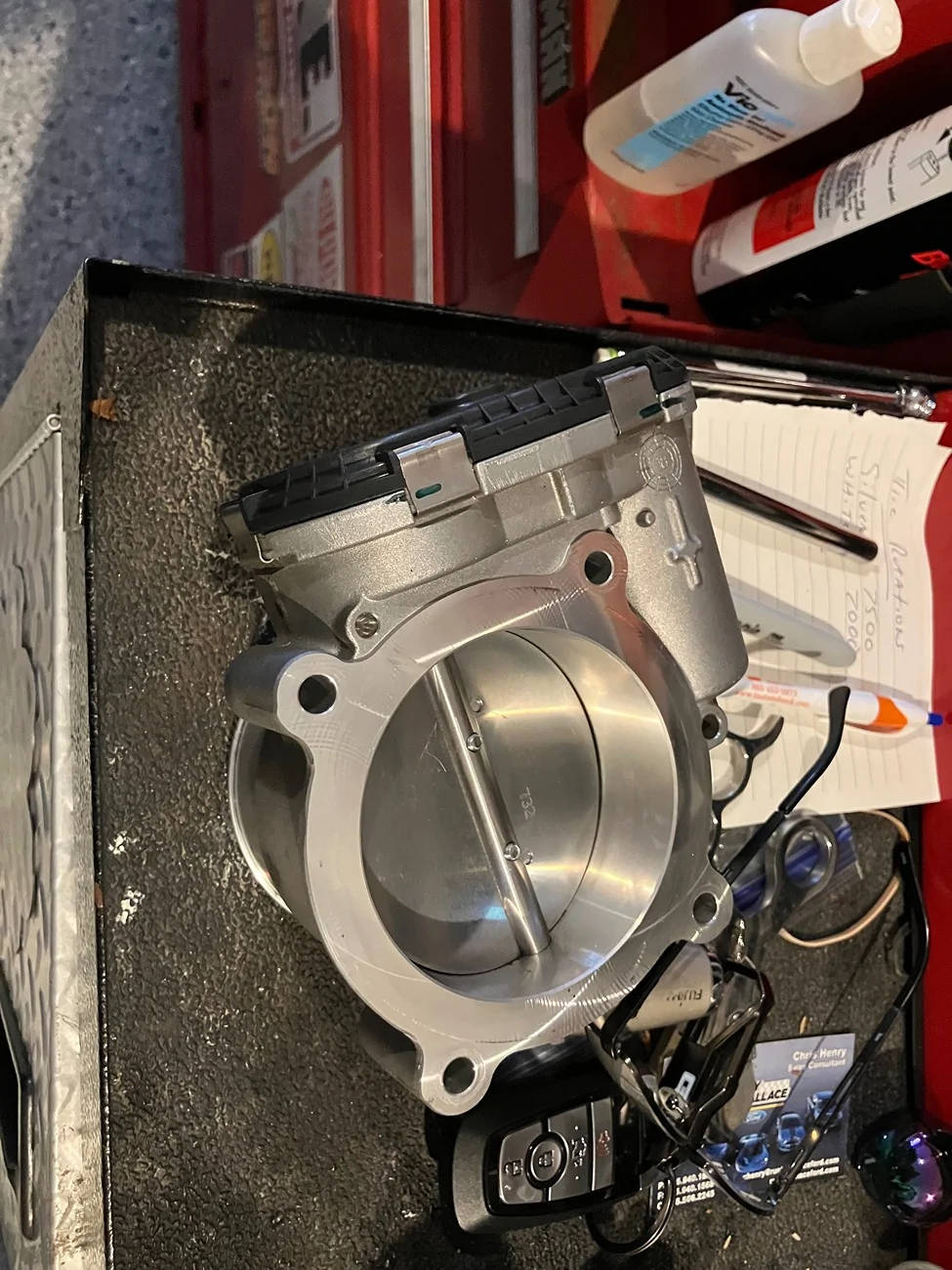

Is there a link for a throttle body relearn after taking it off and cleaning it?
I did a search and can t find what I m looking for , thanks.
The best I can find just says to let it idle from cold for about 10 mins, then driving for trans shift point but I have a 6 speed so that s it?

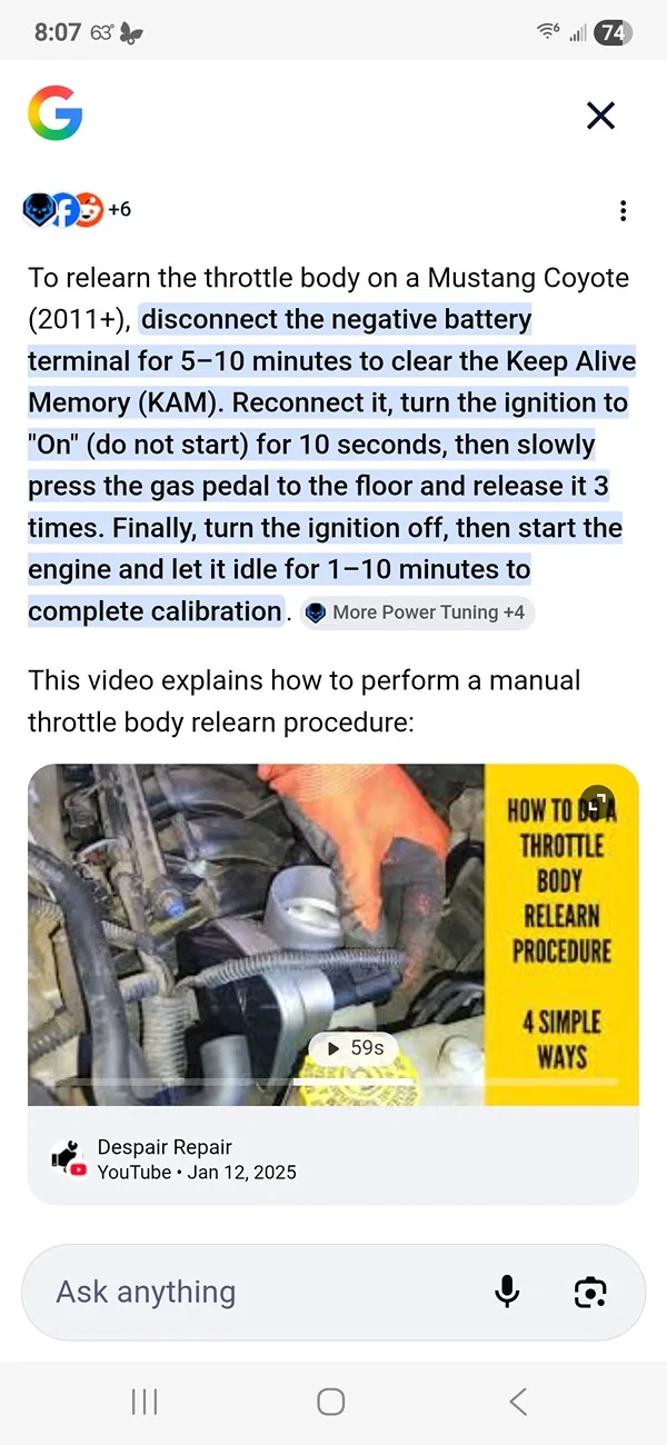

I have no direct experience with tb relearn but "she who knows all" (google) gave me this.

I let it idle for a while and then took it for a romp. Ran strong, smooth idle. I think the pedal reset was from 2011-2015s?
I did battery disconnect during the removal and installation anyway.
