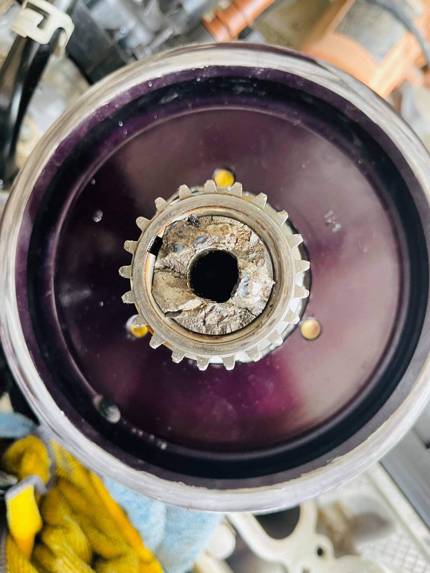

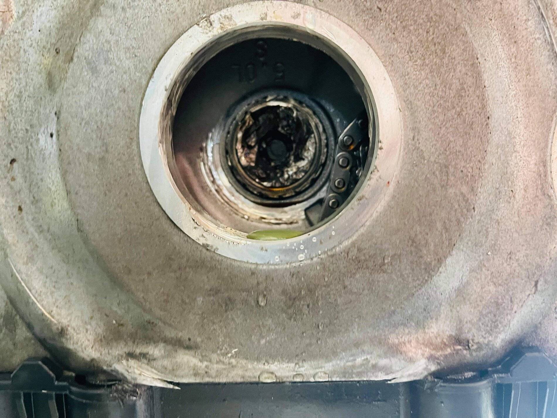

Sorry for the headache…. Which Procharger is that? Looks like the blower crank pulley is on the radiator support in the last picture. Did the bolts that attach it to the balancer snap?
Mine is a d1x. The stage two pulley is still attached to the factory balancer . Those bolts didn’t break, though I’ve previously been down that road. The crank snout snapped clean off and actually the balancer and pulley came to somewhat of a peaceful rest behind the sway bar. What happened inside of the engine when the cams lost time with the crank, not so peaceful!

turnswrench
turnswrench
Apr 2, 2018
43
1,941
1,445
MN
Bowman
F-150, WK SRT
Orly6
Oct 6, 2020
48
Orly
2020 Mustang Gt
Where's the crank key in all of this? Was it still lined up properly?
Yes sir was still lined up, that’s the back side of the crank pulley in the picture. The exact same thing happened to mine, crank broke threw it out of timing & the heads took a huge crap. I haven’t checked the bottom end just yet.

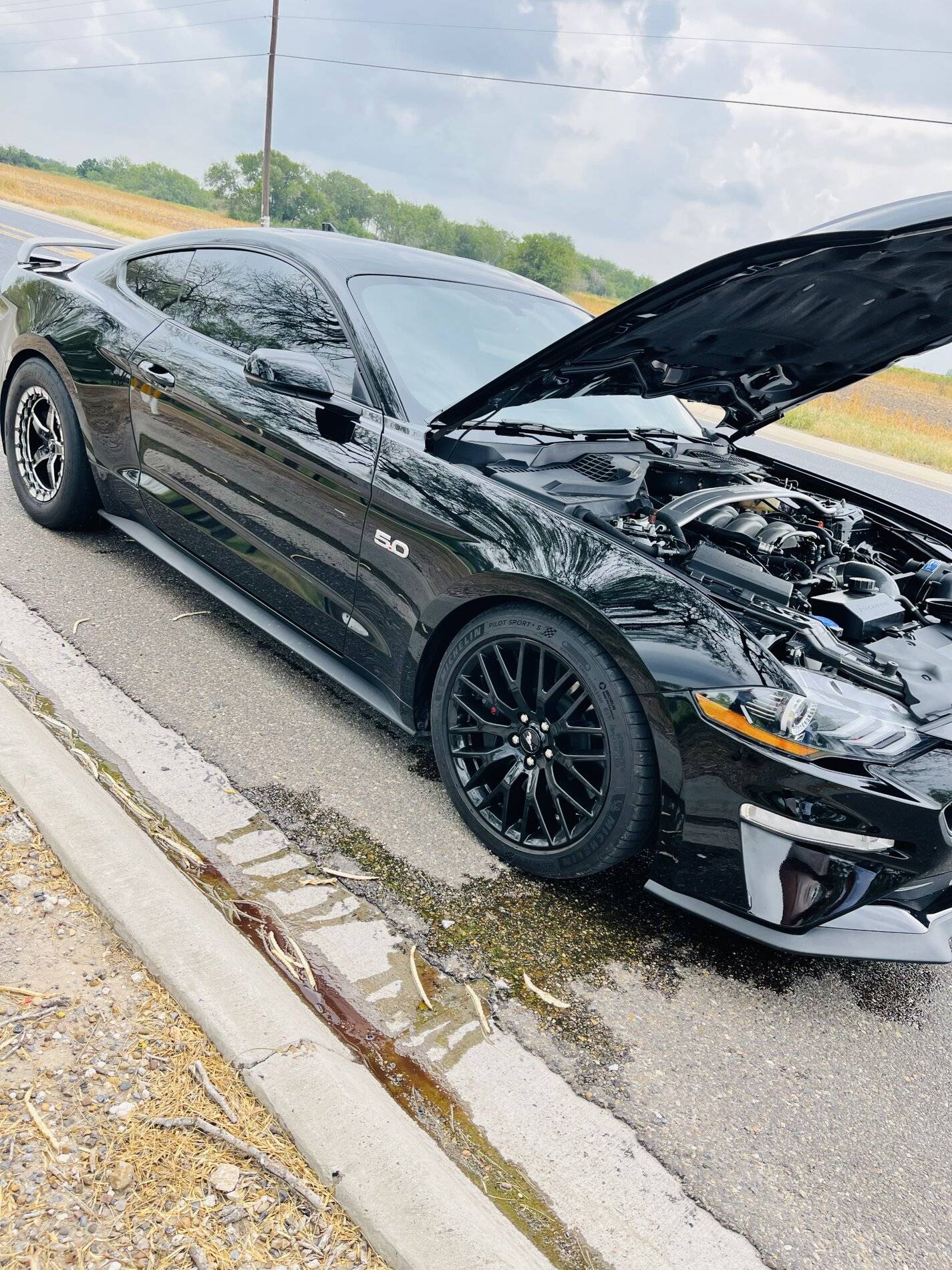

In the pic of your car on the side of the road it looks like the blower crank pulley up on the radiator support area.. wasn’t that bolted to the balancer?
Orly6
Oct 6, 2020
48
Orly
2020 Mustang Gt
That’s actually the water pump pulley, the crank pulley & balancer hit it off & broke my fans & radiator as well.
