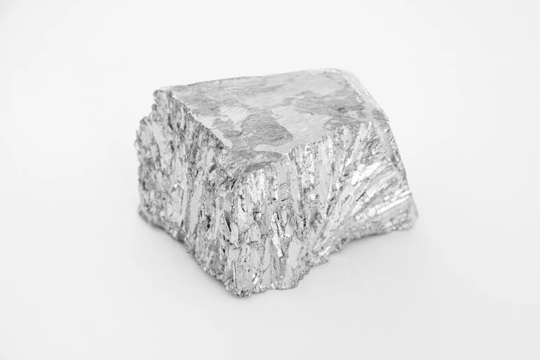

What is the primary anti-wear additive in motor oil? Zinc Dialkyldithiophosphate (ZDDP), which is Zinc bound to the anion of a dialkyldithiophosphoric acid. What does pure zinc look like? Like this:
Or this:

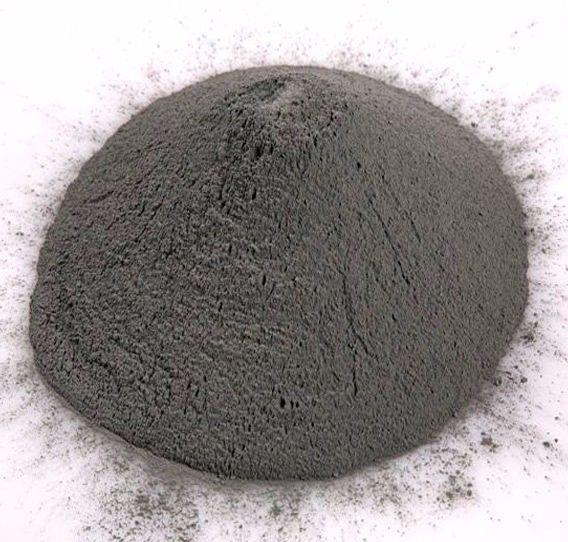

So, what's that "fairy dust" or "gold dust" as it's been coined in the catch can? I believe it to be zinc that has decomposed and separated from the metal surfaces due to heat and pressure or possibly being pulled out of suspension in vaporized oil that is now chemically broken down (that which is in the catch can). The tribofilms formed by ZDDP on load surfaces form much more rapidly than something like hBN or MSH tribofilms, but they also break down much more rapidly as well and the ZDDP DLC needs to be re-applied with every oil change, hence why your motor oil uses ZDDP in various forms.
It's possible in my case that TriobTEX may increase the zinc formation as it's taking the place of the function of zinc as an anti-wear additive in the oil, so the ZDDP is no longer forming tribo-films on the surfaces due to the presence of MSH films, hence I'd expect my oil to contain an unusally high concentration of zinc which normally would be used up more rapidly over the oils service life and the oil depleted of zinc towards the end of it's life. So instead of bonding to the bearing surfaces and forming a sacrificial tribofilm, it's just sitting in the oil unused.
In one of the threads above, a vette owner with a lot of the "fairy dust" (the corvette one looks about like mine as far as how much) also had Used Oil Analysis done which came back with stellar results from BlackStone, more or less they said wear analysis showed very low engine wear rates that would not indicate any issues. This further backs up the theory of the "fairy dust" as being zinc from the motor oil. His car was frequently beat on in Auto X and with over 19,000 miles on it already.
Almost all of the rod bearing failures I've seen occur within a few thousand miles unless some one installs a big power adder like a super charger and then throws a rod bearing. Other than that, if it's gonna blow it blows sooner rather than later after tens of thousand of miles of use.
Keep in mind this "metallic dust" is always non-magnetic in all of the cited examples above, mine included. So unless the rod bearings or pistons are just wearing away rapidly (I'd imagine 22k miles of frequent WOT and high RPM use would have spun one by now and dropped my oil pressure as well as severe knocking, none of which occur), the only possible explanation for continued dust content of that magnitude is zinc in the oil.
It will obviously get replenished every time one changes their oil as well, so it will continue to occur to varying degrees over the life of the engine. Depending on your oil and engine loads, you may or may not notice any, but it's fairly common to see, especially in cars that get driven hard. There's a lot of oil formulas out there with varying degrees of ZDDP, however the EPA and API standards allow of 0.08% wt of ZDDP in motor oil.
8 quarts * 946 grams / quart * 0.0008 = 6 grams of zinc, which is actually quite a bit if you accumulate it all in one place.
Here's an example of how much just 5 g of zinc can appear to be in a small container:
