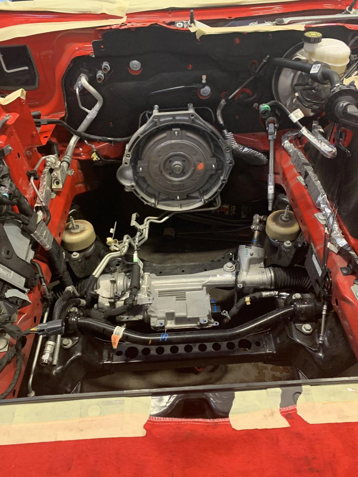

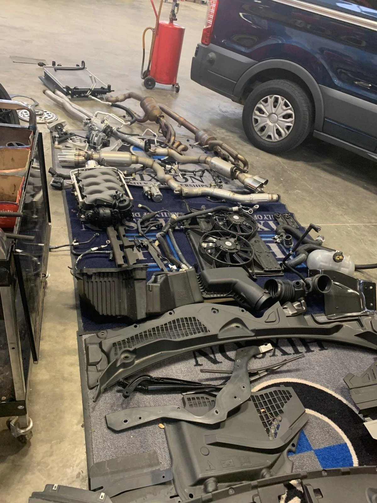

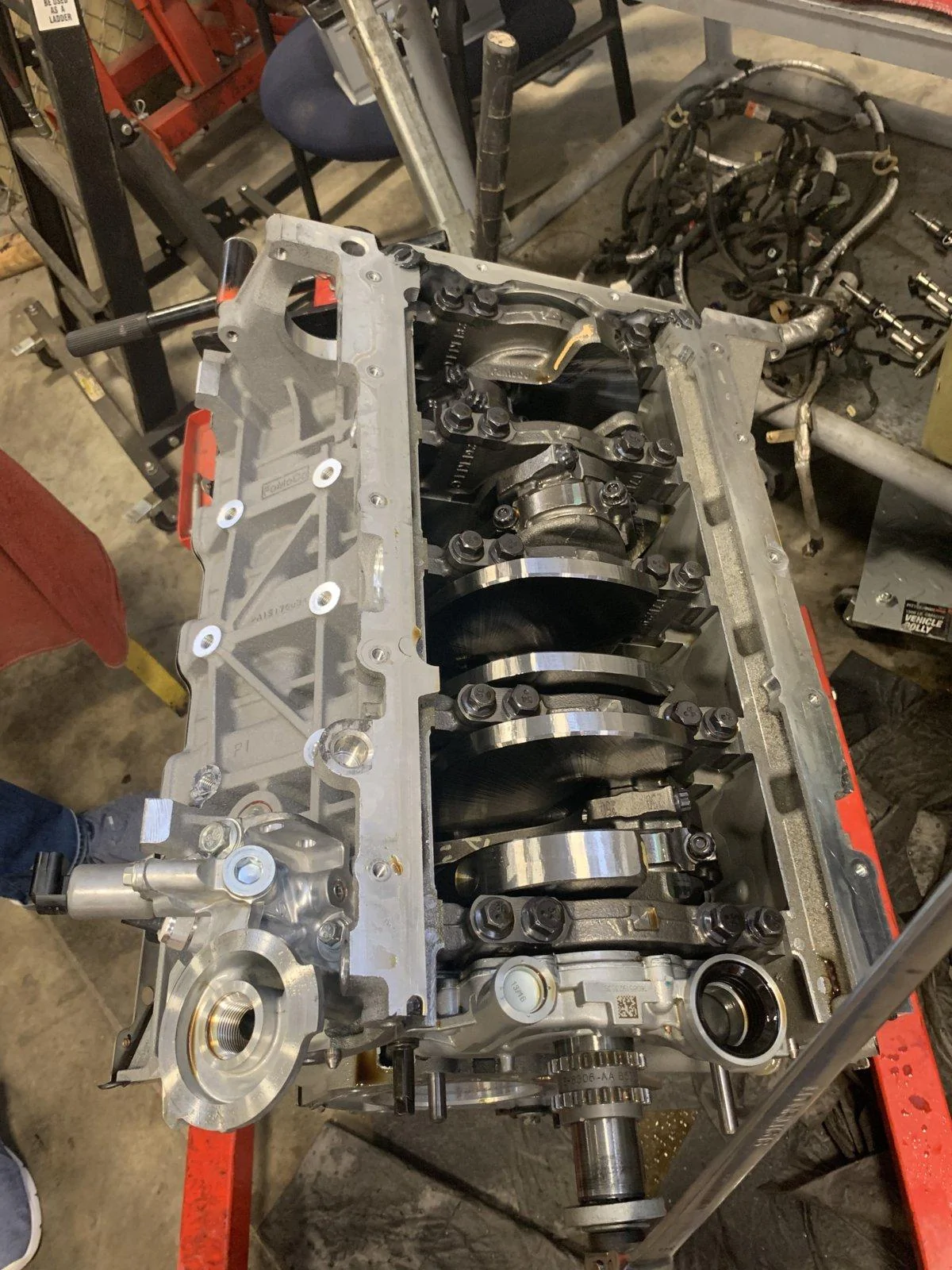

My car went into the shop for the typewriter tick about a week before the tsb was released. Glad I brought it in when I did. The engine is out and apart and the tech determined that it was excessive rod side clearance. After measuring he found that the rod side clearance was over double spec, on two different bearings. Spec is .325mm to .5mm. Two of mean measured close to .9mm. He showed it to me and it was very evident. Had a lot of side to side play and made the exact typewriter tick noise when moved side to side by hand. Ford approved a short block. On the plus side, my tech really knows his stuff and is very clean, organized, and careful.
Yep ... I think it's pretty likely that excessive rod side clearance is the cause of the BBQ. That's why Ford now says it's "normal" and won't lead to any engine damage, etc. Well, that may be true ... but it's really not "normal" if parts are out of factory specifications IMO.

Did they find excessive wear marks on the sides of the big end or crankshaft?
If not, was the tick always there, or did it develop over time?
I ask, because I can't see very well, and it doesn't look like it has a ton of wear marks on the crankshaft. If it has no visible wear, then the excessive clearance was there from the factory, so the tick should have been there from day one of ownership. If the tick developed over time, how the heck could the noise be that?
