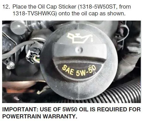

Bottom of page 2: 5W50 oil is required.
https://www.roushperformance.com/media/parts/manuals/422090-instructions.pdf
Also, look at page 73. 5W50 required for warranty. A "5W-50" sticker is put on the oil fill cap to warn someone not to put thinner oil in the engine.
I stand corrected on that one. Must not have shown up in the PDF search because it's an image, not text block. However their crate motors spec 5W-20, says right on their website. And Ford Performance also does not call for a viscosity change with their SC kit that I can find including in the pictures....I also downloaded the user manuals for the F-150's (regular, police and Raptor). None of them call for a viscosity changed except for 5W to 0W for cold climates. They still call for the same hot grade.
