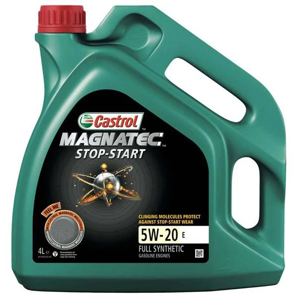

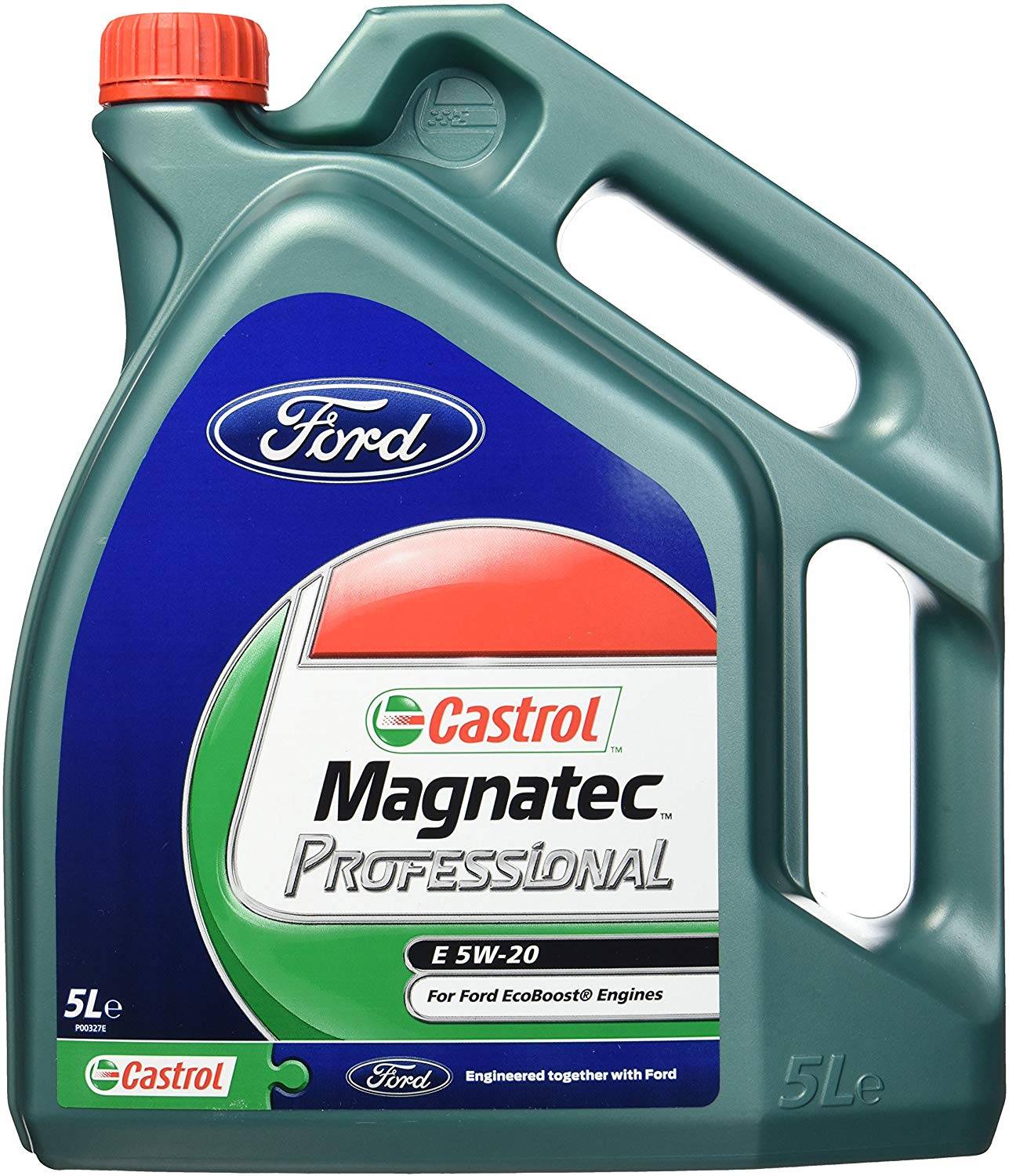

Castrol Magnatec 5W-20 E, spec WSS-M2C948-B is the default oil used at Ford dealers and what is recommended by auto parts stores for the 5.0L Mustang and Ecoboost in the UK. No ticking issues over here.
Magnatec apparently makes the engine run quieter at idle as well.
Motorcraft brand is not really used or sold over here.
wonder what oil comes with new engine in UK. Doubt it is not Motorcraft.
That's a good question. Probably no easy way to find out.
The oil I referred to in my post is what comes in the cars in the UK and what all Ford dealers service Mustangs with.
One non-scientific guess is that the clinging molecules technology is what helps prevent the tick. I am sure there are other oils that have that tech of course.
https://www.opieoils.co.uk/p-79184-...eco-boost-fully-synthetic-car-engine-oil.aspx
Consumer Version
Professional Version (same thing but what is sold to businesses)

All engine oils will drain to the bottom of your sump when your engine is off but Castrol Magnatec's Intelligent Molecules keep clinging to critical parts of your engine ready to protect when you start your next journey.
now, tell me this is not similar to mos2 that also provides protective coverage while oil is not in place.
It is similar in how it functions. It's has an enhanced polar molecule additive in it which clings to metal and ensures parts remain lubricated when off and when under low oil pressure situations. It even lasts through an oil change if you swap out to a different oil. It functions exactly like Ceratec but Ceratec is probably more concentrated with its metallic-based polar molecule additive than what is in Magnatec - no proof to that statement however. Anyway, they are designed to achieve the same thing.
Magnatec is a full synthetic nowadays up to 5W-30 so should be good for 7,000-10,000 miles.
