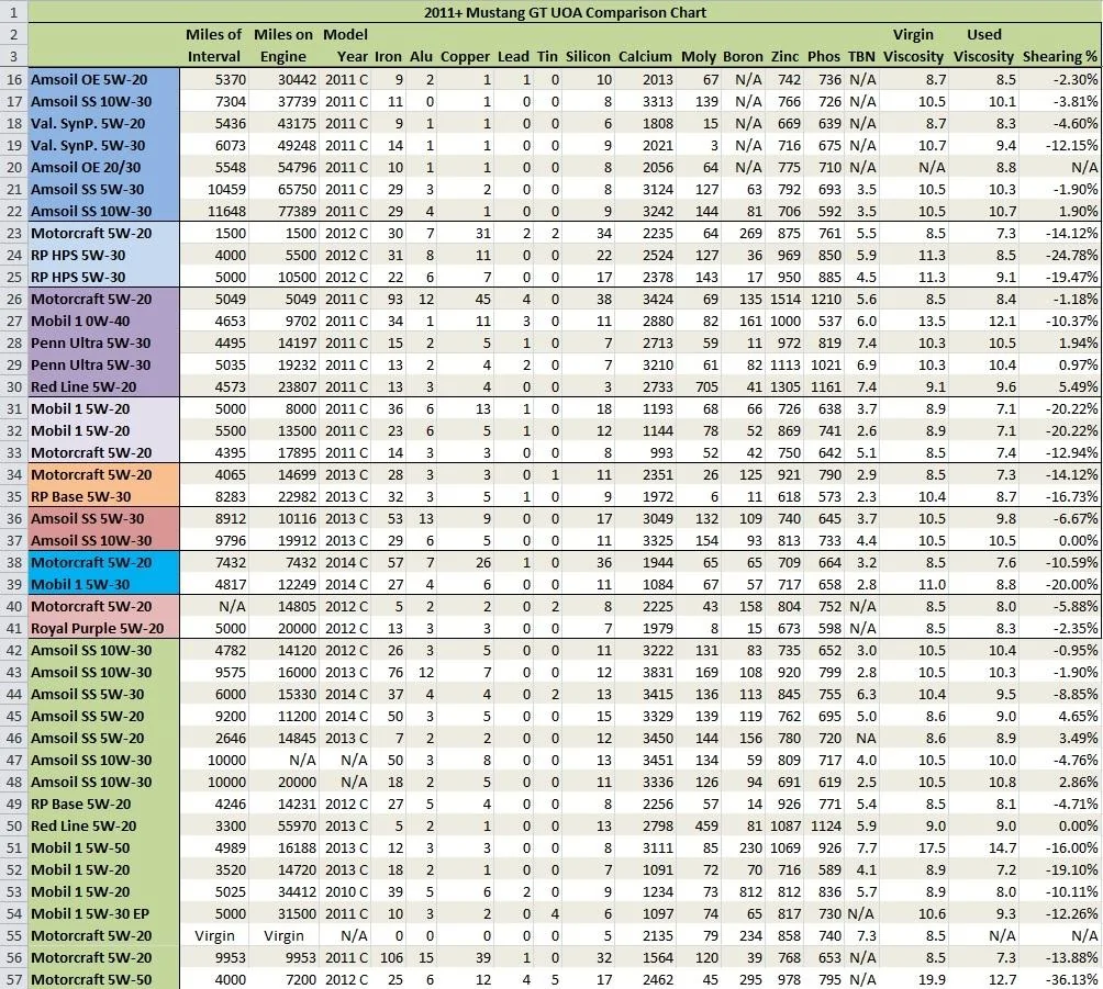

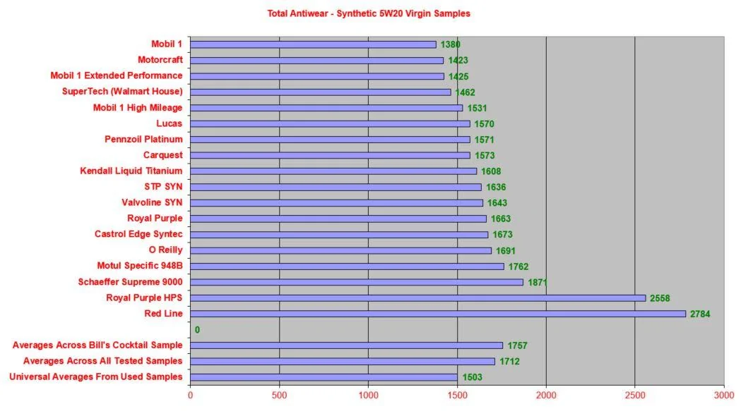

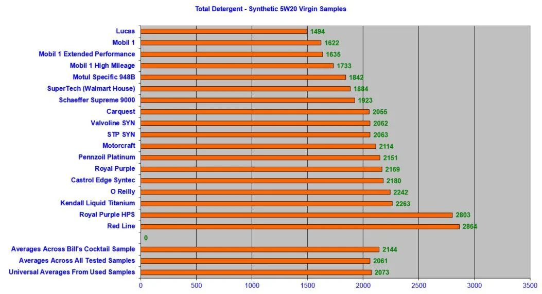

This is the kind of oil data I use to pick an oil - VOAs and UOAs. Virgin Oil Analysis and Used Oil Analysis.
I like to look at how much the oil viscosity shears down in the UOA, and also look at HTHS (High Temp High Shear) viscosity and Noack numbers. Going with a 5W-30 is the best way to bump up the HTHS into a safe region.

Anyone know of which type of metals to analyse for when sending a oil sample out. My work does it but need to know which type of metals to look for.

They are listed in the UOA summary table I posted just above your post.

Looks like AMSOIL and PUP actually thickened up in a few cases. Even AMSOIL OE which is a Group III+ blend does very well. I'm surprised at Mobil 1 considering how many OE's spec their oil, also their formula then is not the same formula now, so that data is not accurate given the age of the data...I've been thinking of going back to PUP myself however as their new Dexos 1 Gen 2 formula is out. I have a hard time believing Mobil 1 could possibly meet Dexos 1 Gen 2 certs and shear down that bad....maybe the old Gen 1 formula allowed for that?
Yes PUP does have a new Dexos 1 Gen 2 certified oil, it's on the shelves with the Gen 2 label on it. That's why Dodge used PUP as their factory fill because of it's supposedly excellent resistance to shear which was a particularly big problem in the V10's in the Vipers and super charged 392 Hemi's. I've been changing at 5k intevals and am fully coated with TriboTex now, so even with the shear I"m not too concerned at this point having only run Mobil 1 for a single oil change, but it would be nice to have more stable oil performance if their current formula shears as badly as their old one!

So I just need to spin the wheel of oil to see what's next...one thing is for sure, AMSOIL Signature Series in ALL cases above performed very well in shear even over 10k interval and in some cases even thickened up a tad which we want for 5W-20. But it also looks like PUP performed pretty well in the two sample cases. Vavoline was a mixed bag, 5W-20's only case did well, but their 5W-30 sheared down quite a bit. MC was not too bad over all and OE is always a safe bet!
Biggest surprise was Mobil 1...especially considering how many corvetts / camaro's and even exotics run their oil as a factory fill. I'd really like to see how their current formula stacks up. Problem is this is all old data and the formulas are all different now then they were 7 years ago before the new standards.
Mobil 1's HTHS viscosity is 2.75 vs. Amsoil SS at 2.67. But how well does Mobil 1's current formula hold it's viscosity, if it shears down that badly even with their current formula...oh boy!

Also looks like RedLine has excellent shear resistance and very good HTHS viscosity. Their 5W-20 is as good at HTHS as some 5W-30's....very similar in price to Driven's/AMSOIL's 5W-20 formulas. Both Driven and RedLine are Group V Esters. AMSOIL is a Group IV but also performs very well. PAO's and Esters rule and there's no substitute, but PAO's do slightly better at low temps while Esters are slightly better at high temps (not much). Esters do blend better with additives as opposed to PAO's. Most often PAO's and Ester's are mixed with each other in different proportions to balance them out.
Redline is the only one however of the three that meet's Ford's OE spec for 5W-20, which is Ford WSS-M2C945-A for those that care about warranty (I've only used oils that meet or exceed the OE spec). While AMSOIL and Driven would likely have no issues actually meeting the spec and just as good of performance, I don't believe either is certified for it so you could run into warranty issues should you ever have a problem. But given the performance of Esters, at this point I'm thinking of just biting the bullet and running an expensive ester base oil that meets the OE spec at the factory 10k intervals given the outstanding shear performance and the fact that TriboTEX will only improve upon the shear by further limiting oil dilution due to blow by (which I've already witnessed). CeraTec or Archoil will have similar benefits.

Valvoline was a mixed bag, 5W-20's only case did well, but their 5W-30 sheared down quite a bit.
Are you are referring to the UOA collection table I posted above? As you said, that is probably somewhat old data, and that Valvoline was probably their old formula "SynPower" before they started calling it Valvoline "Advanced", which has the dexos1 Gen2 SN+ rating. I found a couple of UOAs on bobistheoilguy (links below) of the new Advanced formula in 5W-30, and the shear down was basically zero.
I went with Valvoline Advanced 5W-30 and my engine sounds quieter on it than it did on Motorcraft 5W-20. My engine is not a "ticker", but the valve train sounds a bit quieter to me on the Valvoline.
