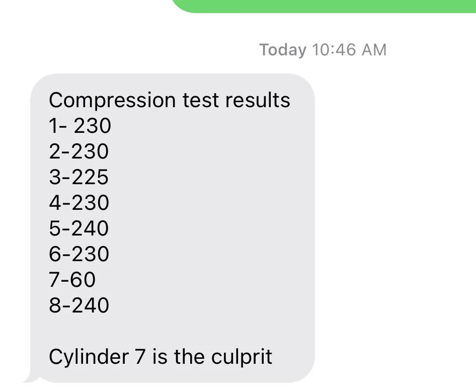

That’s why I keep “spare “ motors now .... i may let you join my club “coyote killers “ .
Thanks for the explanation of the leak down test .
I went back and guessed right what the issue is .
I usually stop at the compression test (I know it’s inadequate alone ) .
Most times it tells me “time for that spare “ LOL
... like my 18 OEM motor ... finally gave out at almost 30,000 miles (longest serving motor I have had ) most boosted, over a 100 passes and over 900 whp. I knew it was on borrowed time , had the spare already but debated whether to take it out while it was still alive .
I rolled the dice and lost .... but still she had a good run .
PBD tuned also by the way and have no complaints . Running E85 with 21.5 * timing and 2.75 6 rib pulley .
I suspect it has been down on power for a while (running same ET as others with bigger pulleys )
# 7 was slightly down last year ... guess it finally gave out .
Moral of my thread jack .... Build a spare at your own pace while your motor is alive if you want to avoid prolonged down time /paying for it all at once .

since Ford performance is offering to pay for shipping , I would use another builder. At least you get a second opinion .
if you need them I have 7 pistons out of an old alluminator.
I actually have 8 , after Mahle had shipped me a replacement for the one that had a hole .
Even though they say it’s the same spec it looks slightly different

False knock could be from a catch can/oil separator rattling around or better yet, a longtube header vibrating up against something.. just saying.
By looking at the pics of your spark plugs, is that anti seize on them?
stang17
stang17
Jun 5, 2016
669
307
Wilkes Barre, PA
2017 GT Premium PP
Yeah antiseize. The plugs came with the crate engine and instructed the shop that was doing install to gap them to .028. Ford motorcraft 1 range colder.
I've heard of not using anti seize on NGK plugs as it can potentially cause conductive issues and changing the heat range of the plug.
