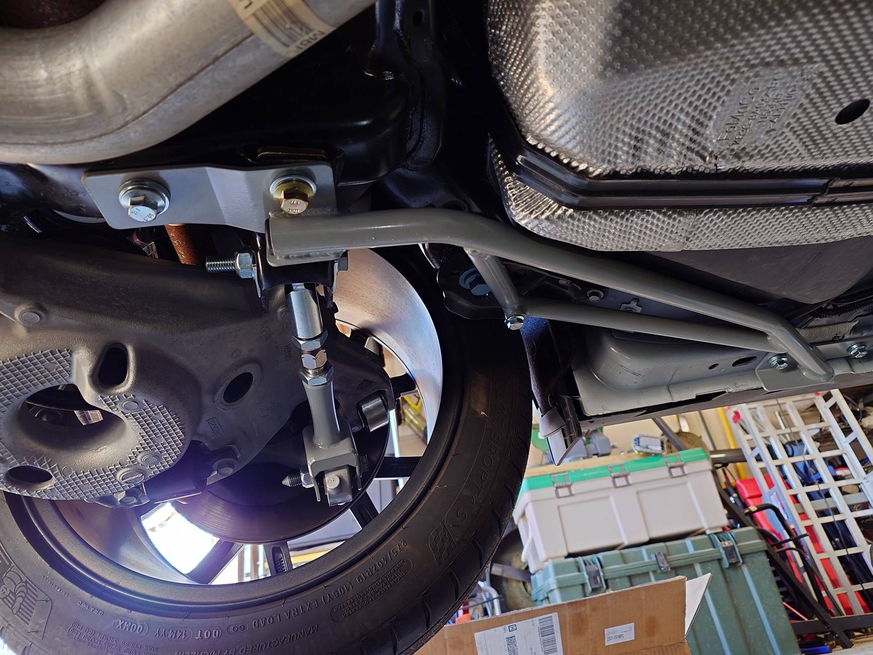

For those of you adjusting your rear toe to 0.12 in per side, what toe arms are you using? I ordered the Steeda Ultimate Handling kit and it should be in this week. Allegedly, the bushings in their toe arms have less deflection than stock. Would I still aim for 0.12 in per side with these?
OEM for me. I haven't gone down the path of replacing all the rubber joints in the suspension yet.
And yes, still same alignment.
Yes. .1 degree toe in, in the front also helps with stability. .05 per side.
I like -1.8 to -2 camber in the rear, any more and the car feels weird.
I've got the ultimate handling kit. I'm at .12 feels good.
