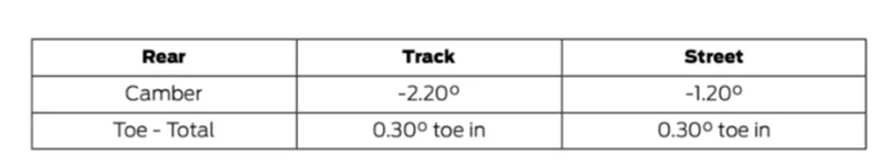

I reached out to BMR to get recommended alignment settings for my set up and got some info back from them. Wanted to run this by you guys and see what settings people are liking for their cars. I’m also open to recommendations on parts to further improve handling. It’s my daily driver but this season will be my first HPDE.
Attached are the settings that BMR sent my way. they recommended Street settings for a daily

For NT555 G2's the street settings listed will probably work pretty good. As you put more of a track tire on it you will want more camber. As you gain experience on the track you will probably want less toe in on the front possibly even a touch of tow out, but for first day on your tires stick with street settings listed.

The right camber for the NT555G2 is °90, laying on their side on the curb waiting for the trash pickup. yeah, I said it. :p
For track you probably want up to 3 degrees. For the street, driving in a straight line and never taking any corners hard, you want like 1.5 degrees.
2 degrees isn't much. I'd recommend like 2.4 front (if you can get that with camber bolts and retaining the wheel/tire to strut clearance you need.
Rear camber would be ~0.5 degrees less than the front camber, but not less than factory specs, and not more than about 2 degrees. That gets the car to balance nicely. BMR is saying to keep the rear camber more than the front, which is favorable if you want to keep the car safely understeering IMHO.

The shop aligns it to factory specs which they look up in their database. Generally a random shop will just make sure its w/in a very wide range of tolerance allowed by the factory specs.
If you're just driving around in straight lines, then mostly you only care about the toe (which is now the tires are turned in or out subtly from the direction of travel. No, the tires are not all 'straight' with the road, its common for them to be turned inward ever so slightly, and occasionally they can be turned out.
Then there is camber (tilt) and on the front you have caster angle as well.
In a corner the amount of camber on the front versus the rear will have an effect on how tilted those tires are relative to each other, which will have an effect on how well those tires are holding the road at each corner of the car.
So there's a lot more going on with alignments than just making sure the car tracks straight when the wheel is straight.
