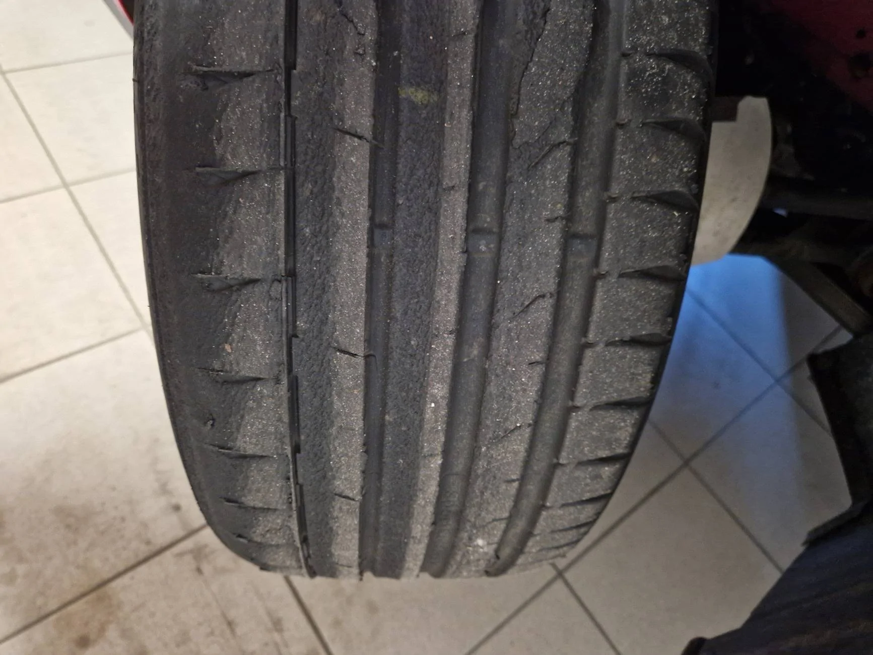

I know that the best alignment settings are based on the tracks you run at, but I'm looking for a good baseline.
I have a 2017 Mustang Ecoboost with the performance package. My use is track driving and spirited weekend driving, not a daily.
My new tires are 200tw Yokohama AD09 255/40 R19 square setup.
The outer edges of my tires are really suffering on track, the middle and inside look new while the outside is close to cording.
I know that I need more negative camber, as much as I can get, so I installed camber bolts. I can get the camber to about -2.2 degrees in the front with these bolts.
I don't really know what I should do with toe and caster?
I like the handling of the stock alignment, I am doing this purely for better tire wear but I would still like the car to be stable and controllable.

Picture of old street tire:
NightmareMoon
Nov 22, 2015
7,207
6,503
Austin
2016 Mustang GT PP w/ Voodoo
2.2 is still complete inadequate to protect the tires. You’ll still have massive wear on the shoulders. Shoulda gotten camber plates!
As for the rest, 0 front toe. Caster isnt adjustable. Rear neg camber around 1.8-2.0 and rear toe IN between 0.24 and 0.3 (total combined both sides)
If I run -2.2 camber in the front, is -2 in the rear fine? Or is that too much in the rear compared to the front?

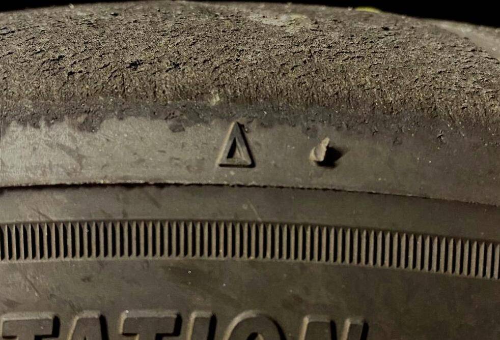

My last track day on the tires pictures above, I really tried to listen for them screaming as well and tried to minimize as much noise as I could.
Before I was probably overdriving the tires and turning too much. Now I focus on being as smooth as possible and going slower instead of turning more.
I'm only off by about 2 seconds on my best laps but I'm seeing much better tire wear. I also do 15min sessions now instead of being 30mins on track until the oil temp warning is nearing yellow, that is probably also helping for the tires.

I think I'm about 34 hot. Tire wear is a good indicator especially with minimal camber. If you see wear on the sidewalls, up the tire pressures.
Use the triangles on the sidewalls as an indicator. The wear should come right up to but not past the triangles.
