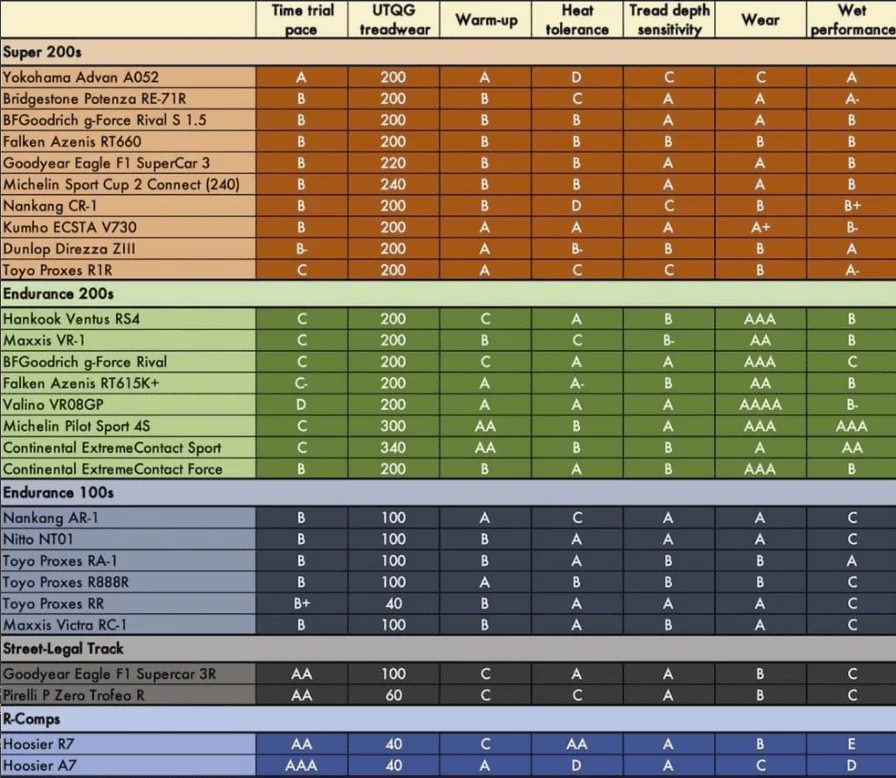

I think this needs to be shared...
I looked at this table probably 20 times so far, it's getting close to analysis paralysis :crazy:
I cannot make sense from some of the data points either, for example rival S has 3 times better wear rating than rival s 1.5, how does that make sense? It's hard to translate all those A's and B's to real life experience. What I can deduct from it is that Kumho is the best super 200tw for hpde, which is quite surprising.
I know that RS-4 are exactly what I need, but they are nowhere to be found at a reasonable price. And the table is missing Federals, which are the most reasonably priced so far... decisions, decisions..
The table is close but wrong by my account - in a couple of spots, buuut. Just pick one and try it, next time you can re-up or pick another.
Falken RT660 is a good one. Lots of those in the grid at CotA HPDE a week or two ago. Lifes too short to run endurance compound tires :). Buy a Miata if you want to save money on consumables.
Yeah, I'll probably end up just picking one once it gets closer to an actual event. It was +5 F and snowing outside my window just yesterday, so I still have some time 🥶
Interesting opinion on endurance compounds, thanks for sharing. I'll give it some thought. Oh, and getting GT86 is high on my list as next daily beater 😁
Rival S 1.5 is a much faster tire and therefore wears faster. The non-1.5 has a harder compound...slower but lasts longer. That all adds up just fine.
The letter grade is just a comparison between tires. So a tire with a wear rating A is going to last longer than a B tire and so forth.
