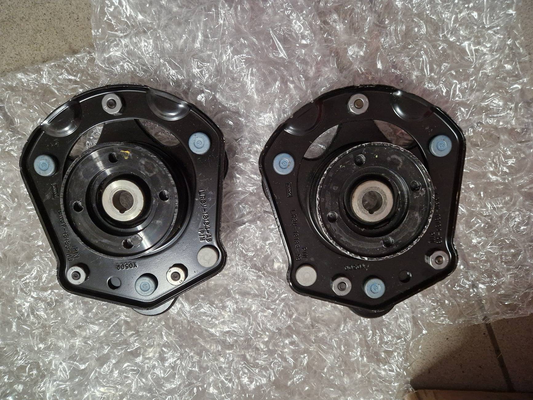

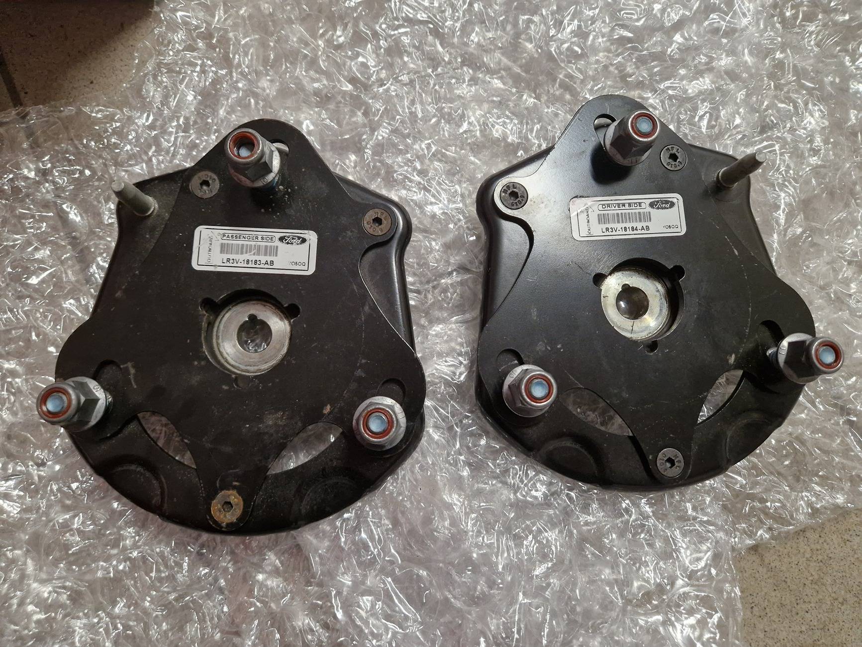

I ordered new takeoff Ford camber plates of a dark horse / mach 1 vehicle. They finally arrived and I will be installing them soon. Half the price of new ones. These + camber bolts will hopefully get me to -3 front camber without cutting.
Just remember camber bolts (to add scamber) move the wheel towards the strut, so they can cause problems if you're trying to fit a wide front tire.

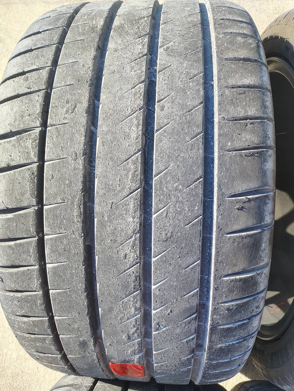

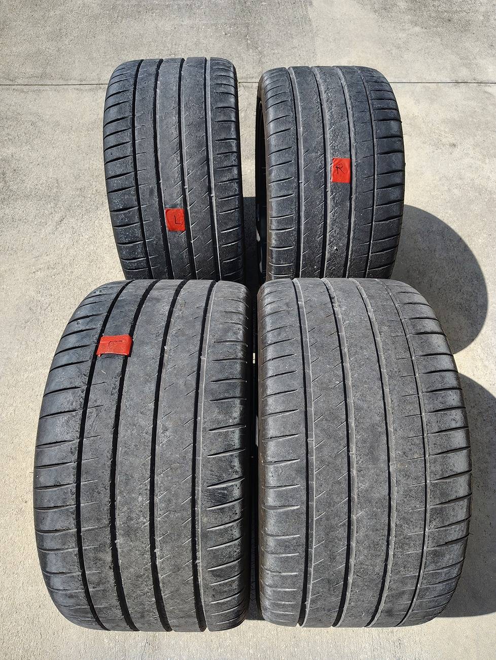

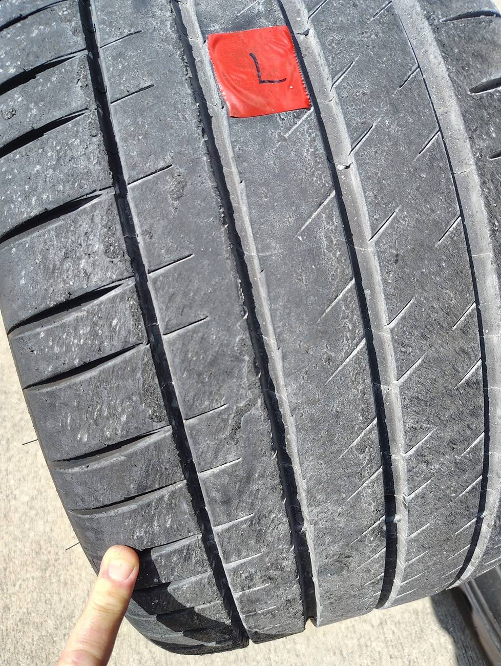

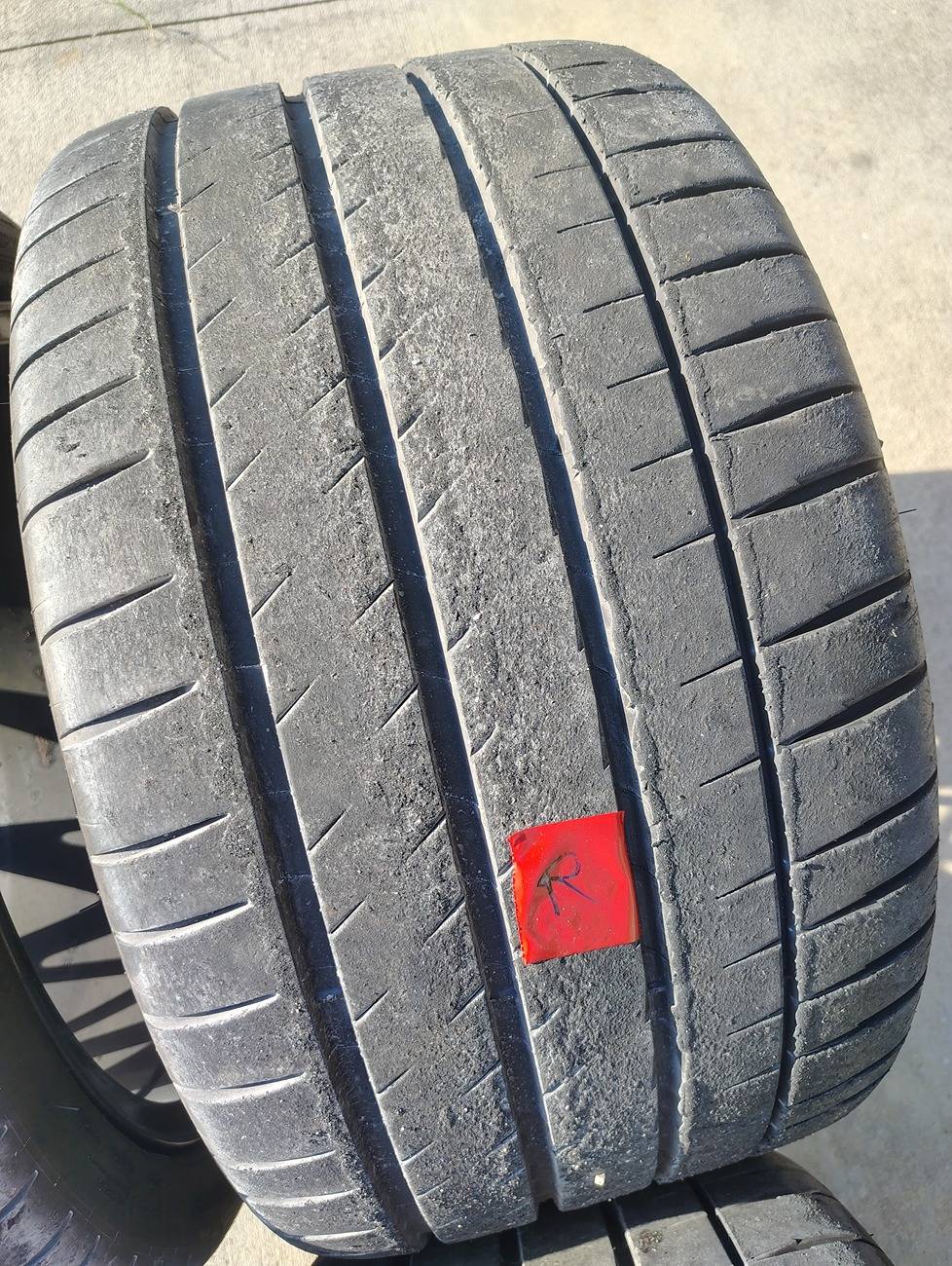

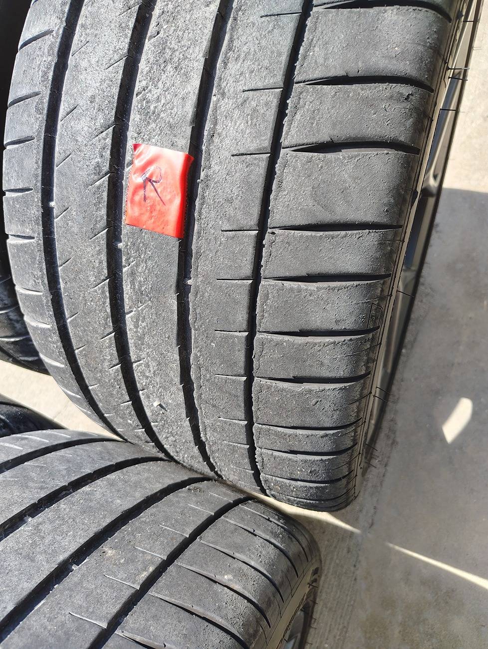

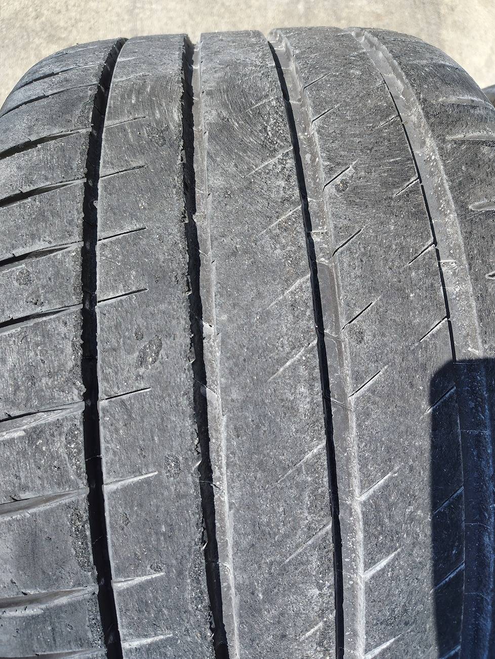

This is my tire wear from 23 laps around Daytona International. 15 of them were hard. The first 8 were easier.
Here's the write up I did.
SCCA Track Night at Daytona International 6/19/25 | 2015+ S550 Mustang Forum (GT, EcoBoost, GT350, GT500, Bullitt, Mach 1) - Mustang6G.com
the 4 tires (picture) are where they were on the car. The fronts are chewed up more than the rears. What are these tires telling me?
I ran last September the same course in the GT with 285 Potenza's square. They looked like every day wear when I changed them out. None of this rash.
These Michelins look melted :(

Looks fine to me. You got em working, but they're not chunking and the evidence of heat ripples is minimal.
Better tires are going to look more 'melty' but that's just the tire working for you. The small accumulations of rubber at the edges of tread blocks is pretty normal.
Yeah the fronts take more abuse than the rears (front heavy car, and you can brake harder than you can accelerate)
What tire pressures are you running, and what sizes are they?
Your tires are too new/unworn to really show any wear pattern trends.
