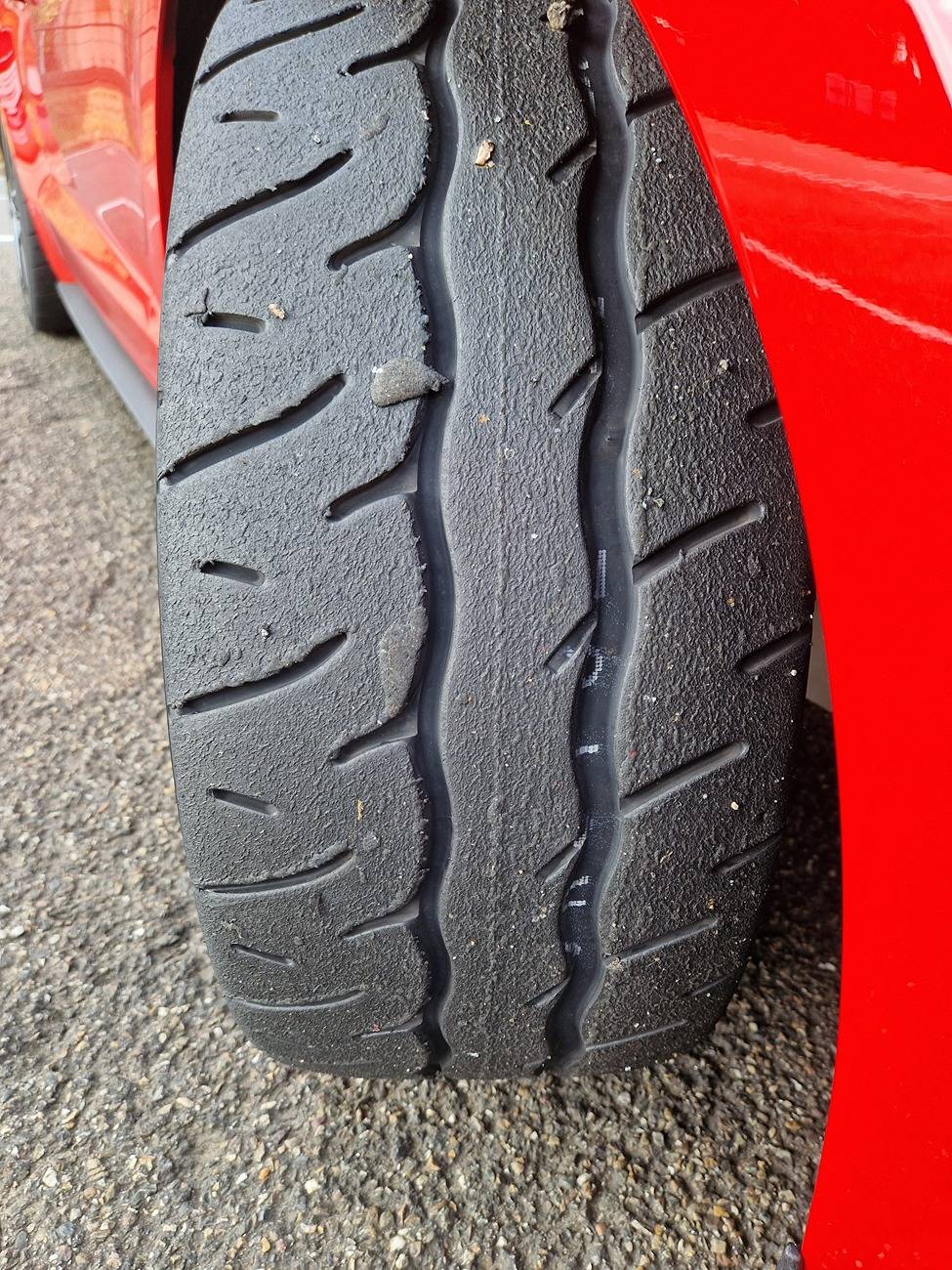

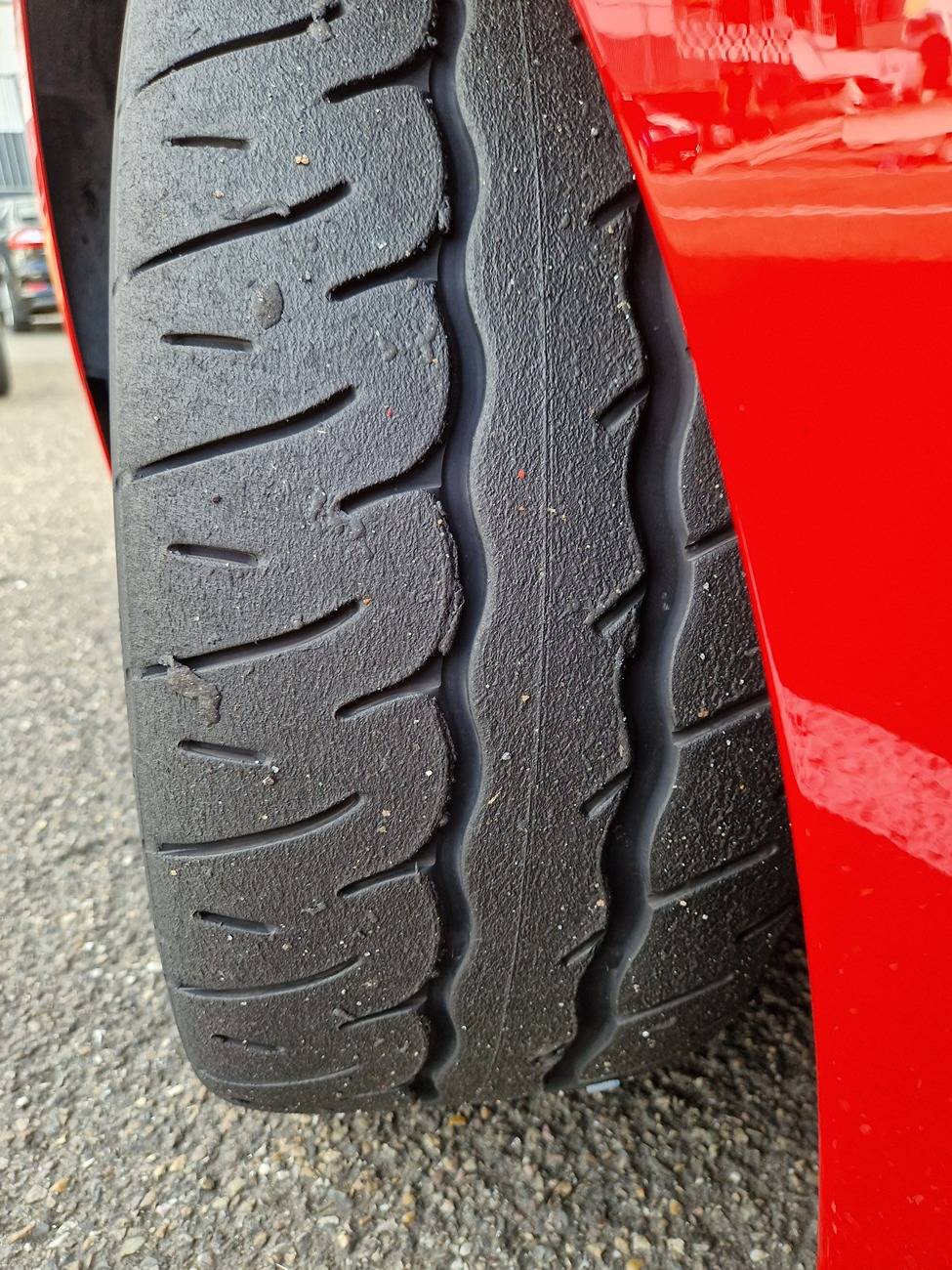

Different car, but my wear looks like this after my most recent trackday. The wear is right up to the indicating arrow, where it is supposed to be I think. Still seeing slightly more wear at the edges so could probably do with more camber, but I think it is fine for now.
I can't get more anyway without lowering the car or getting a different brand of camber plates.

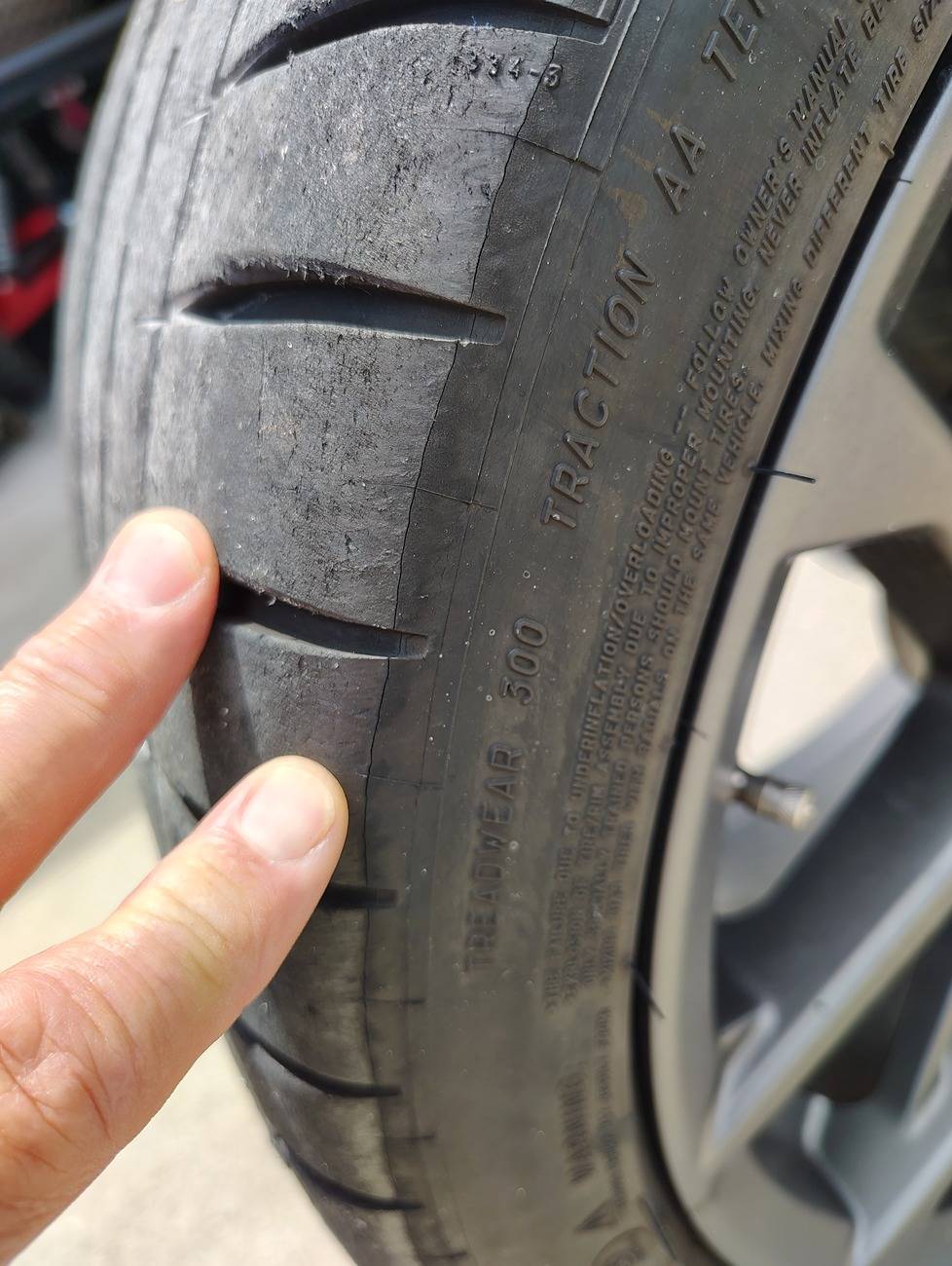

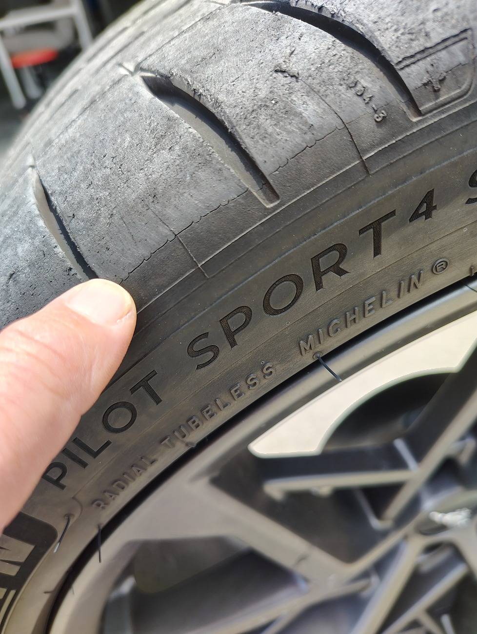

I found this hairline crack on my LF tire. Pretty much all the way around. The other 3 look OK. Daytona has 2 hard left turns in the infield. This tire shot?
Definitely replace those, don't risk it. Blowing a tire at high speeds on a track might cost you your car and your health/life and that of other drivers.

That’s not uncommon on that tyre type - mine are screwed (five years, low mileage), my brothers were (not old, but replaced to due mileage wear), and so are my cousins (a few years old, low mileage).
I suspect that first crack yours have is a joint in the moulding / compounds. Soon after the sidewalls will start to ‘crazy pave’
Perhaps it’s something in our local environment that just dislikes them ?
I put uniroyal’s on my daily at the same time I bought the stang. Same wash chemicals, same environment, park next to each other etc etc. The uniroyal’s sidewalls still look like new.
Did you or the previous owner drive these in sub 40° temps much? MP4S really don't like being used in cold conditions, and cracking is the result.
As for using those on the track. IDK man. If you do, you need to inspect them thoroughly all the way around on all four tires after every single session. When the cracks turn into chunks the chunks can rapidly propagate around the entire shoulder. Safest thing is to not use them on track.
The other place we see MP4S chunking is when the tire is brand new, hasn't had many heat cycles, and then its driven hard on a very heavy car (mustang or heavier) with not enough camber. That tends to overheat the new soft tire and it chunks. With camber or with some miles and heat cycles to harden up the tire a bit they're usually ok on track.
Old hard tires used in cold conditions get cracks. New soft street tires used too hard too soon overheat the shoulder.
This is why if you're driving hard you want correct track camber, track brakes, and track tires which can take the heat. Using street camber, street brakes, and street tires can be expensive as you get failures and stuff disintegrates prematurely. You can save money in the long run by having consumables which are dedicated to situations they're designed for. You'll use up whatever tires you buy eventually, so why not have two sets? Same with brake pads.

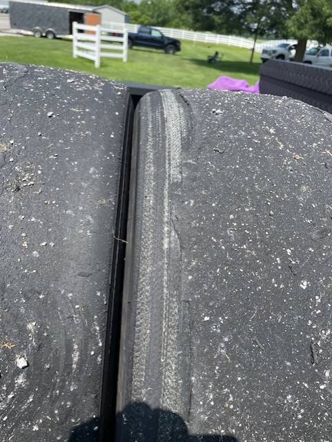

Love this thread, I just had a post about better wearing tires then I was out at our local road course this weekend with some slicks and pow took of at least an inch of rubber off the front drivers side on my last lap of a early session. My camber and toe settings were done as part track, part street settings (I have the paper somewhere) which I see now is inadequate. My local track is mostly right turns which has you going heavy on the left drivers side a lot. Reading through the posts here I see I really have to get my camber and toe to track settings. I have the Steeda plates but didn't cut the strut tower, wondering if the camber bolts would be a better option. thanks for the deep dive, next I have to work on better track awareness and skills.
