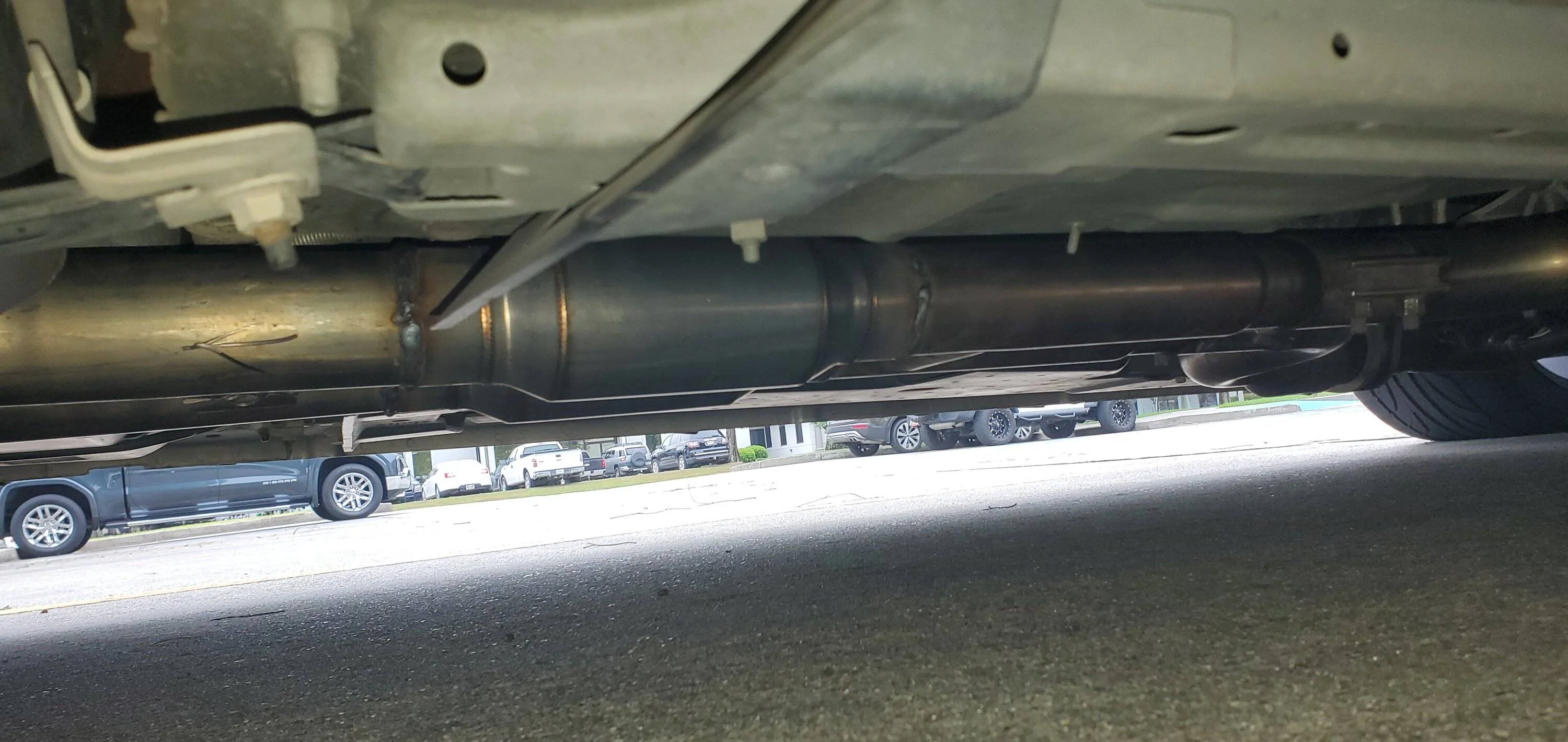

Finally installed it over the weekend. First impressions are that the exhaust is now more boomy at idle and while driving in track mode, inside the cabin I hear this new kind of hollow/howling sound. Did not wind it out and drove only for a few miles, but I think I lost some of the pops and the mids at higher RPM may actually be a bit quieter than stock. Comparing cold starts with a sound meter app shows negligible increase (a tenth of a dB). Overall, just gives it a unique sound. You be the judge. Attaching two sound clips of cold starts (you get some bird sounds as a bonus). First is the stock. There are some sound artifacts as I converted from FLAC to MP4 and uploaded to site. Would I do this all again? Not sure.
I (my exhaust shop) just installed my Accelatech Resonated mid pipe, I too hear a definite Howling. CJ pony parts is suggesting it could be an exhaust leak. I called Gibson Performance exhaust who manufacturer's the part, the phone tech said he had heard of this issue before and replacing the part with a new part solved the problem for the last unhappy customer.
I have an appointment to take it back to the exhaust shop and check all the fittings/connections to be sure there are no leaks. If that doesn't solve the issue, I'll have to work with CJ Pony parts for a replacement.
Yeh
Mine started a little bit and got worse each day. Weird howling ufo metallic sound.
also noticed power loss in the mid range too.
got all the power back when I installed the switchfire.
Have them install it backwards. You don't want all the "cheese grater" things grabbing your exhaust flow. In the 70's 80's some glass packs were like this. Putting them on backwards helped flow and sound.
Best bet is to get a better muffler. Dyno Max, Magnaflo, Vibrant, Stainless brothers, there are many made correctly for flow, power and sound.
Don’t think it’s possible to fit it the wrong way.

It would take heating the pipes up & manipulation to install backwards. TBH it looks like a design flaw within the 'chamber'. Took mine a lil longer but got the weird sound & power loss. The supercharger whistle was louder as well. Took it off & threw away. Didn't even contact CJ Pony Parts. The MF Tru X was a nicer piece.

The last unhappy customer that recieved a second accelatec is me. and guess what? the second one wasnt as bad but it was still bad. i even wrapped it in exhuast wrap. straight trash.
