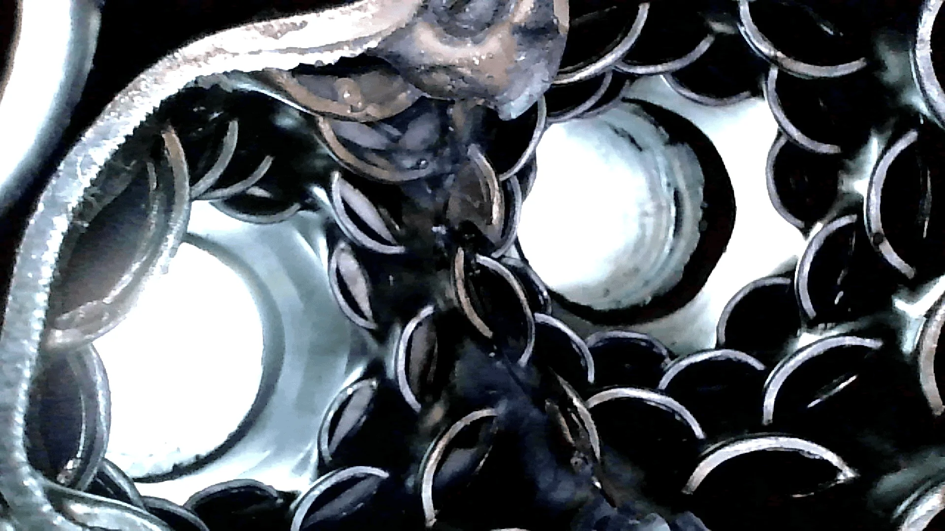

Try the jubilees first. Put two on. One at each end ( 1/4 from each end ).
I think that might do the trick for you.
get them nice and tight with a socket wrench.
I think they will remove that vibration noise.

Thought about this. Or exhaust wrap. But would only be a temporary bandaid. If they don't warranty it then I guess I'm going to have to do more to show them that it's not right. No way they can say thats how it's supposed to sound over a phone clip. In person it's just bad.
Yep
I’ve got the metallic UFO sound as well now.
it hits at about 2.5-3000rpms on light acceleration.
Just emailed pony parts….
Wondered if you had any luck with the jubilee clips or something similar???

Im working on having a warranty replacement but after hearing this doesnt have me optimistic. maybe there is a reason for the price drop.
I dont think a jubilee is going to work although in therory it should. i think all the tension will be placed on the outter edges of the suitcase and be loose fitting against the belly and top of the suitcase causing even more vibration.
However mine vibrates all the time. the higher the speed the louder it gets. i can here the resonance in my damn sleep.
