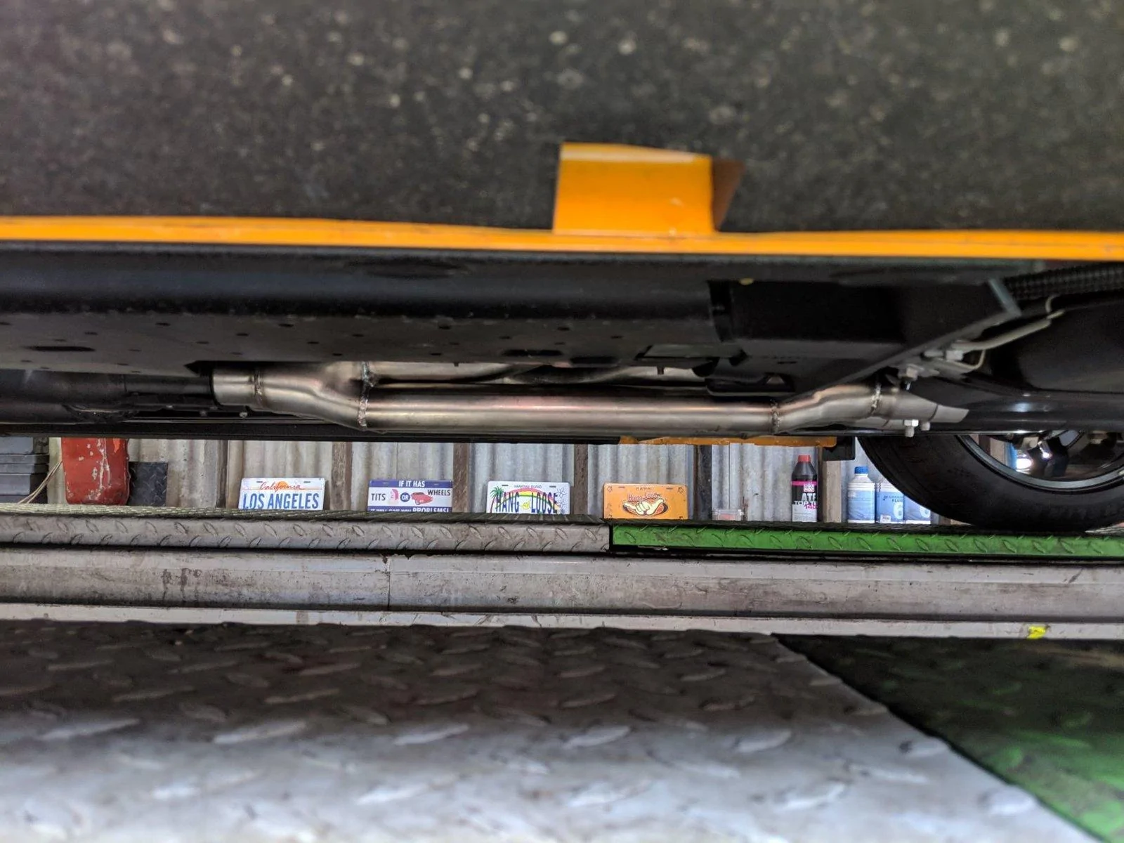

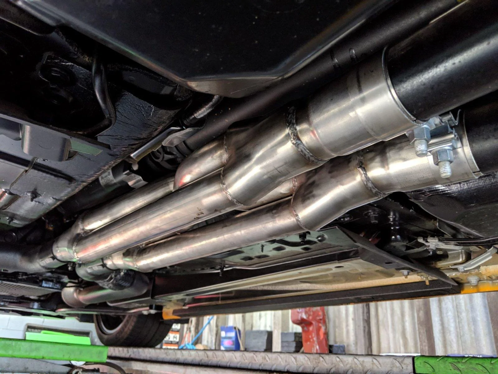

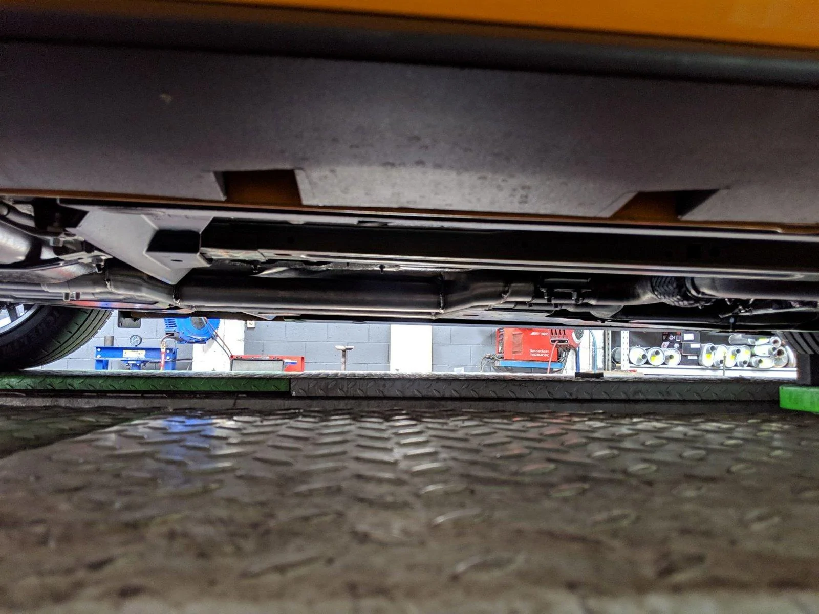

Finally fitted. Only took the shop less than an hour. The existing resonator pipes are best cut insitu and not how the instructions said to take the entire exhaust from the resonator clamps back to the tips and lay on the floor to cut. The new X pipe seems to be about 10mm (if that) lower than OEM resonator. On the road they make the "normal" in active exhaust sound like "sport" and "sport" sound like "track" and so on. I took it for a 20klm drive and it seems a much deeper note overall with no rasp at all and no drone. I need to experience it more though. Now I have to work out how to post videos.
Fitted and plenty of clearance
Thank you for the pictures.
