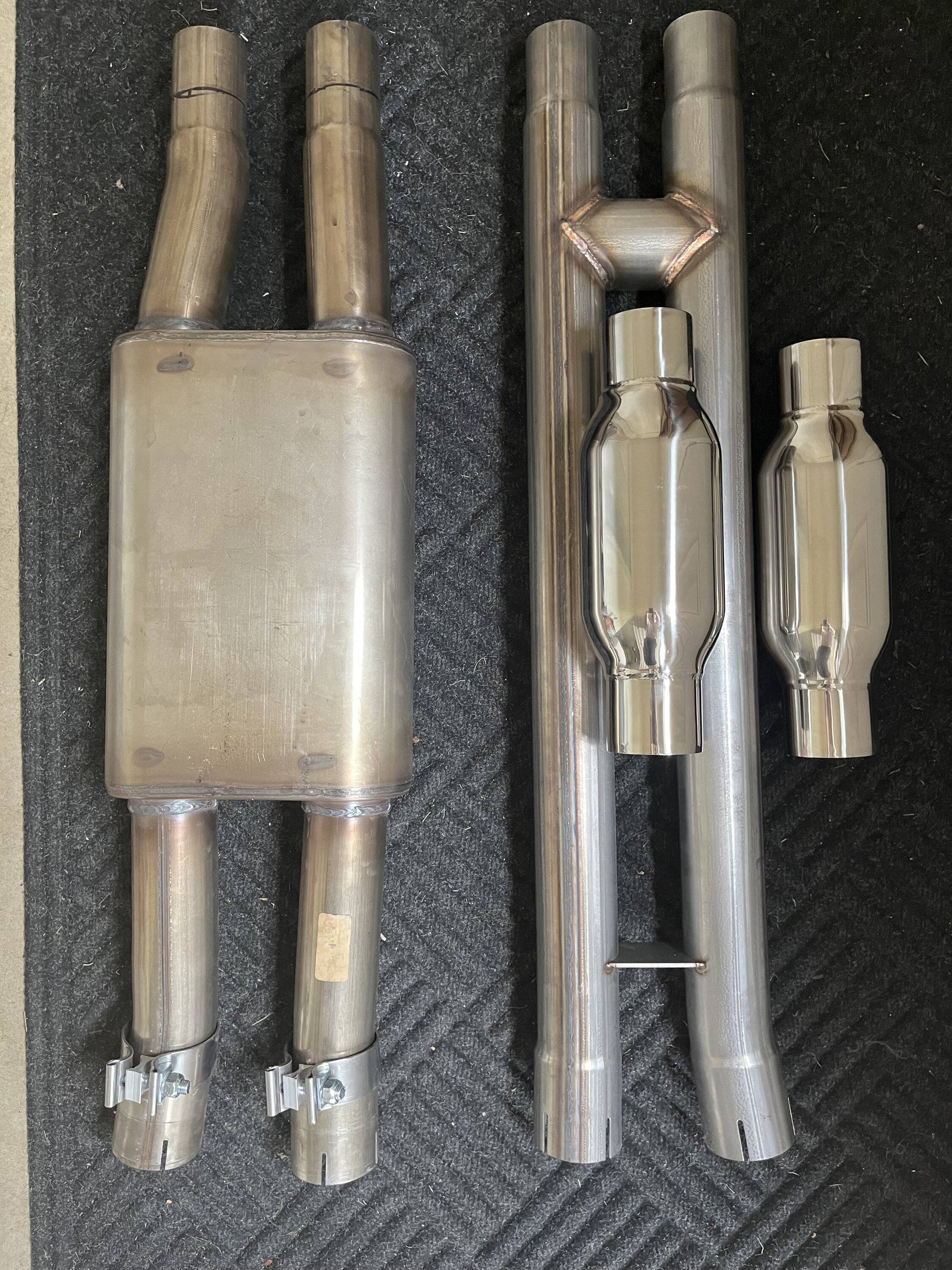

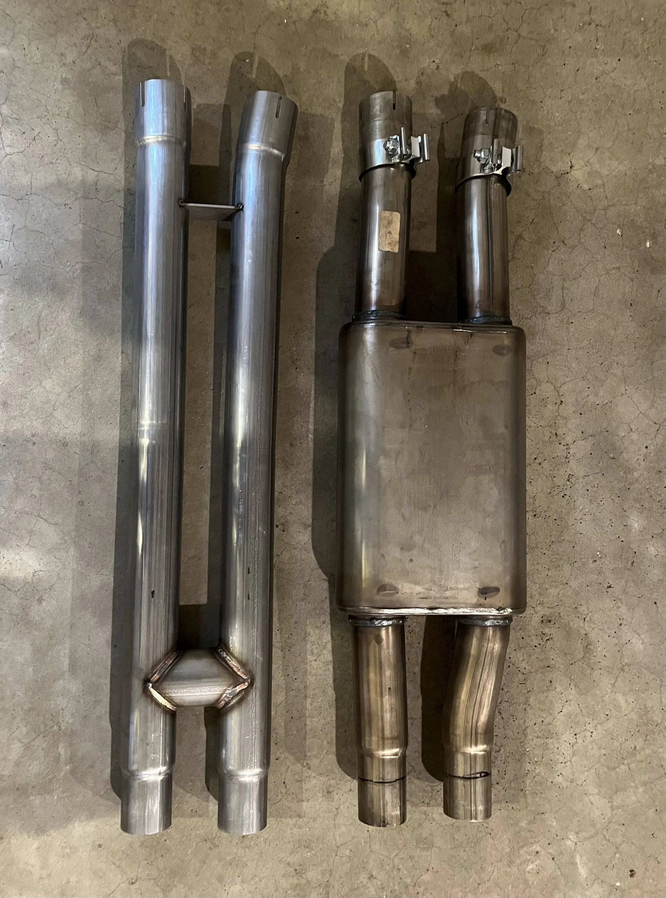

My H pipe arrived to day and I removed the Accelatec . Just waiting on the Vibrant resonators, looks like they got delayed as they were supposed to be here today.
the Accelatec and the C&L H-pipe are exactly the sale Length. As far as I can tell the 4ā€x12ā€ vibrant resonators will fit side by side but it will be very tight fit

Resonators arrived! Looks like the 2 resonators Will definitely fit side by side, with a 1/4ā€ to 3/8ā€ gap remaining between them.
off to the welder!

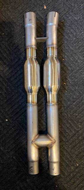

I got the replacement for the Accelatec resonator from my welder yesterday.
The 4" diameter x 12" long Vibrant resonators fit in the C&L H pipe very well.

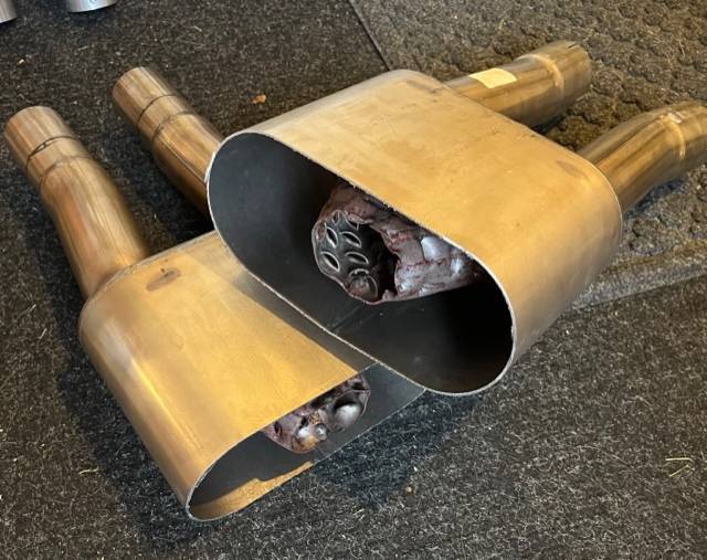

Also, I got a message from CJ Pony that they would refund the purchase price of the Accelatec mid exhaust resonator, but I needed to send them pictures that is was destroyed beyond use as they did not want it back. I appreciate CJP being "Stand-up" about the issue and refunding the purchase.

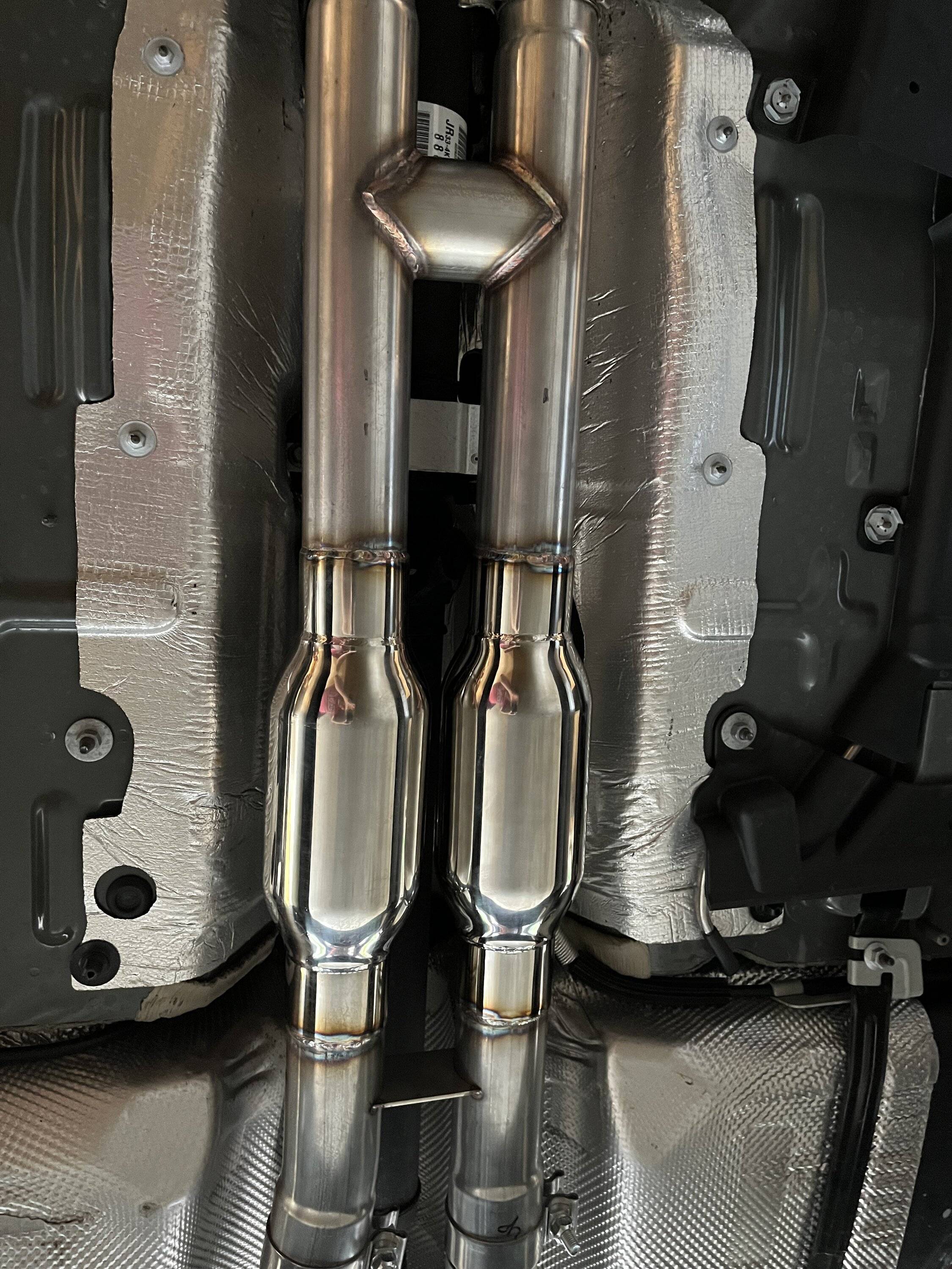

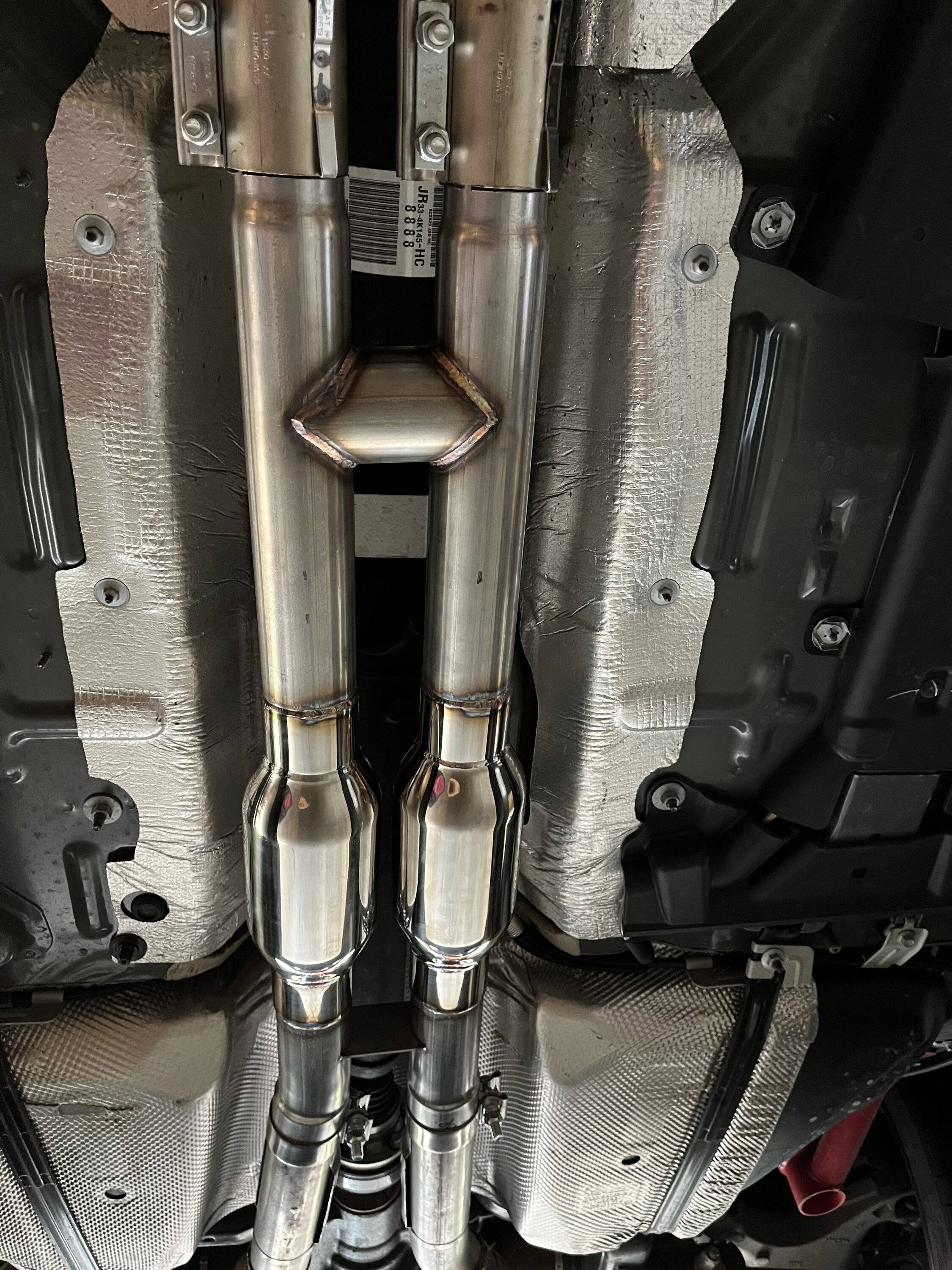

Heres a pic installed. It actually fits in the space better than the accelatec. The accelatec drooped Down and it was actually welded that way. When you set the resonator on the ground with the resonator weld seam down, the pipes were close to the ground. When you flipped it over in the weld was up attachment pipes were further away from the ground.
