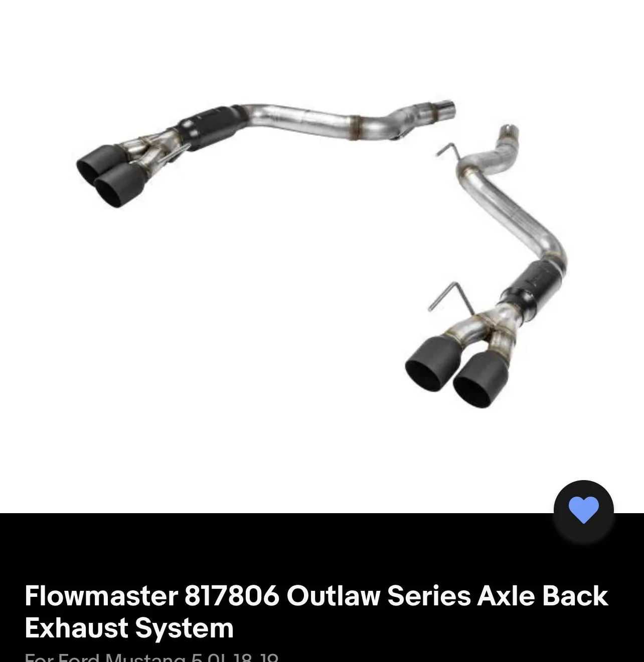

I’m doing stock manifolds w/ cats, H pipe and Flowmaster Outlaws.
Are you putting the Flowmasters after the H pipe and before the axle back exhaust or eliminating the axle back?

I didn’t think of that, but now im wondering if thatll help with the drone?🤔
then run a straight pipe back.
