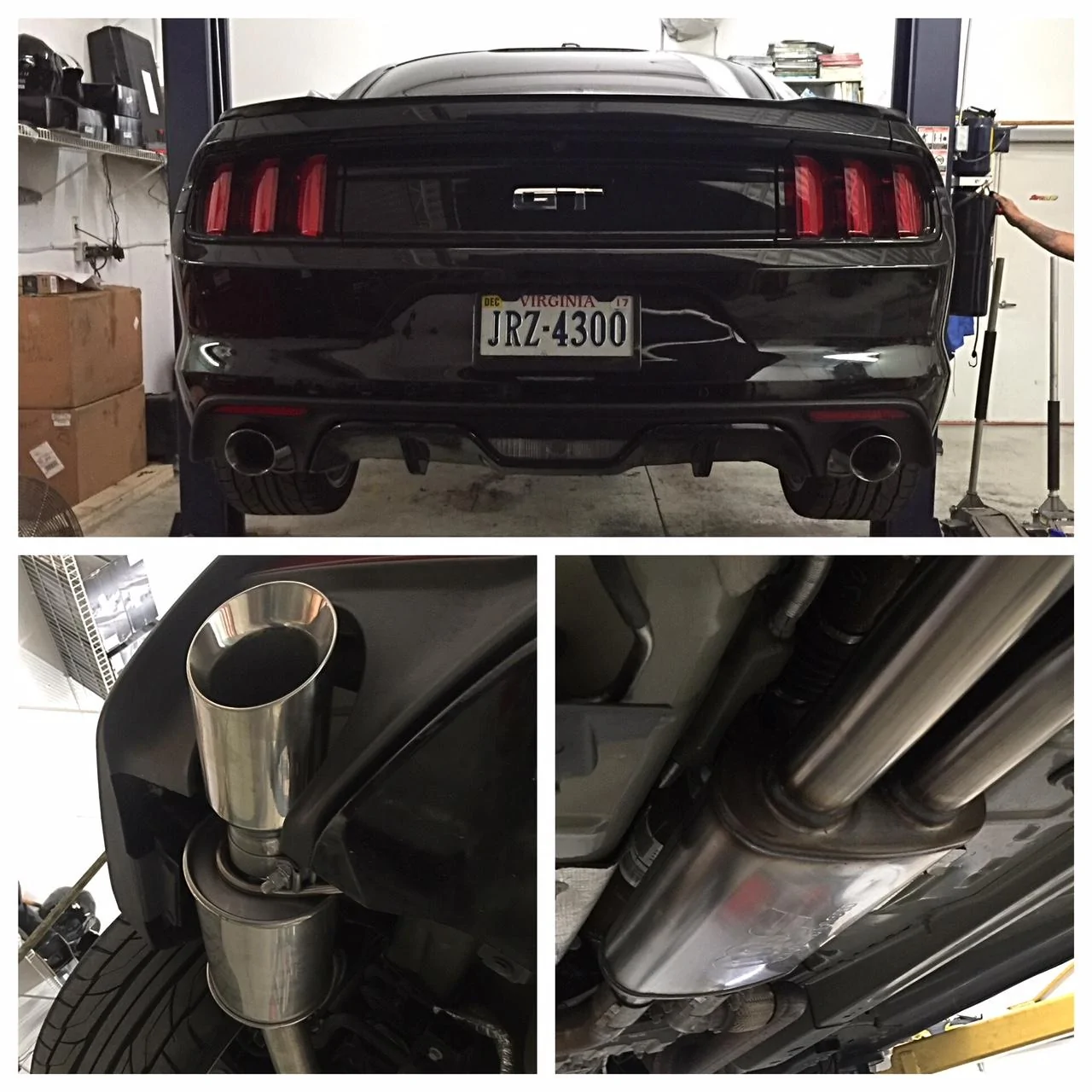

I run the SLP LM2 with MF resonated X-pipe. You wont get the 'rasp' up top you're looking for with the set up. You wont get much more volume than you have now, but it is nice and deep which is what I was going for and hard to get with this motor. You may get a bit more 'burble' low speed which make me giggle from time to time. :D
I can't detect any resonance (drone) from the set up, but my hearing isn't what it use to be (too much time spent racing motorcycles with no ear protection years ago).

Would you happen to have a video/sound clip of your exhaust note?

I don't but let me see what I can do about changing that.

You're the man, thanks for putting that together! It sounds awesome, I'm going to give the catted X a try.
