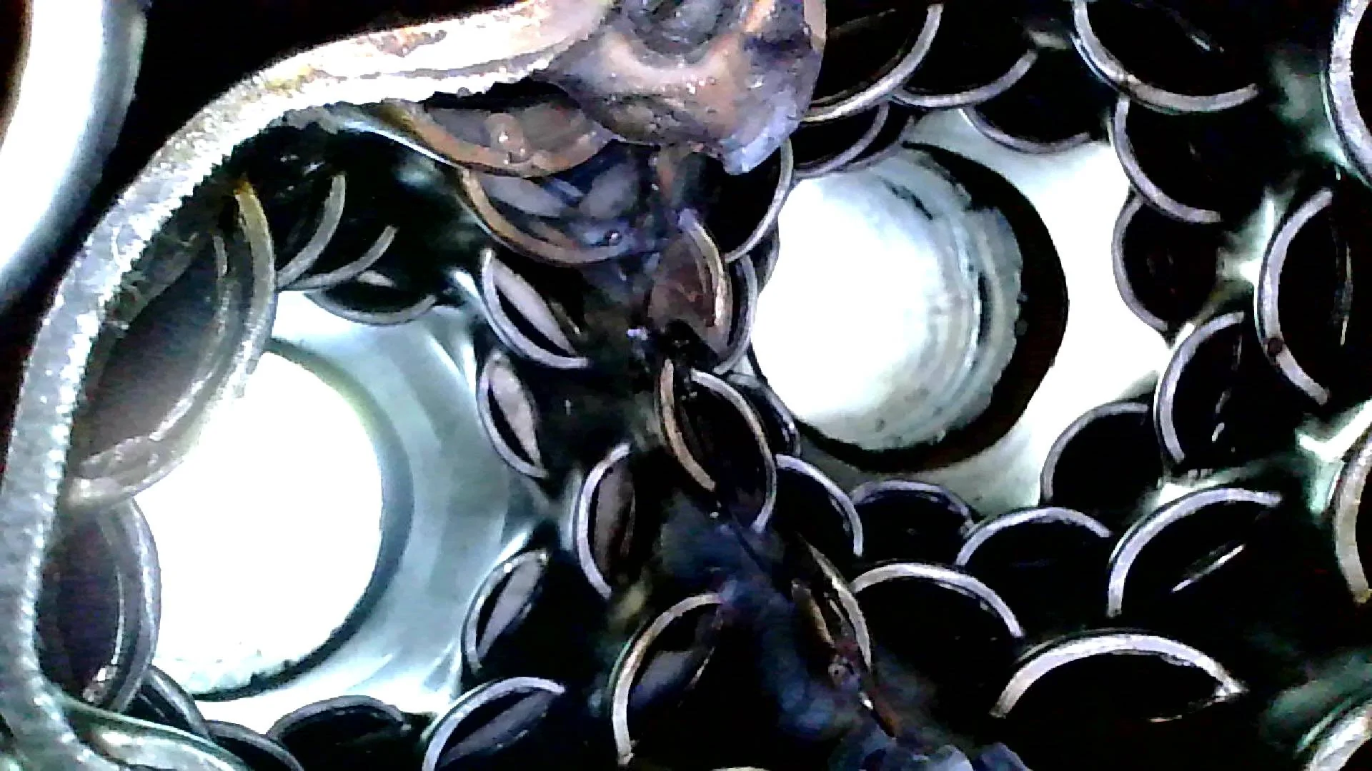

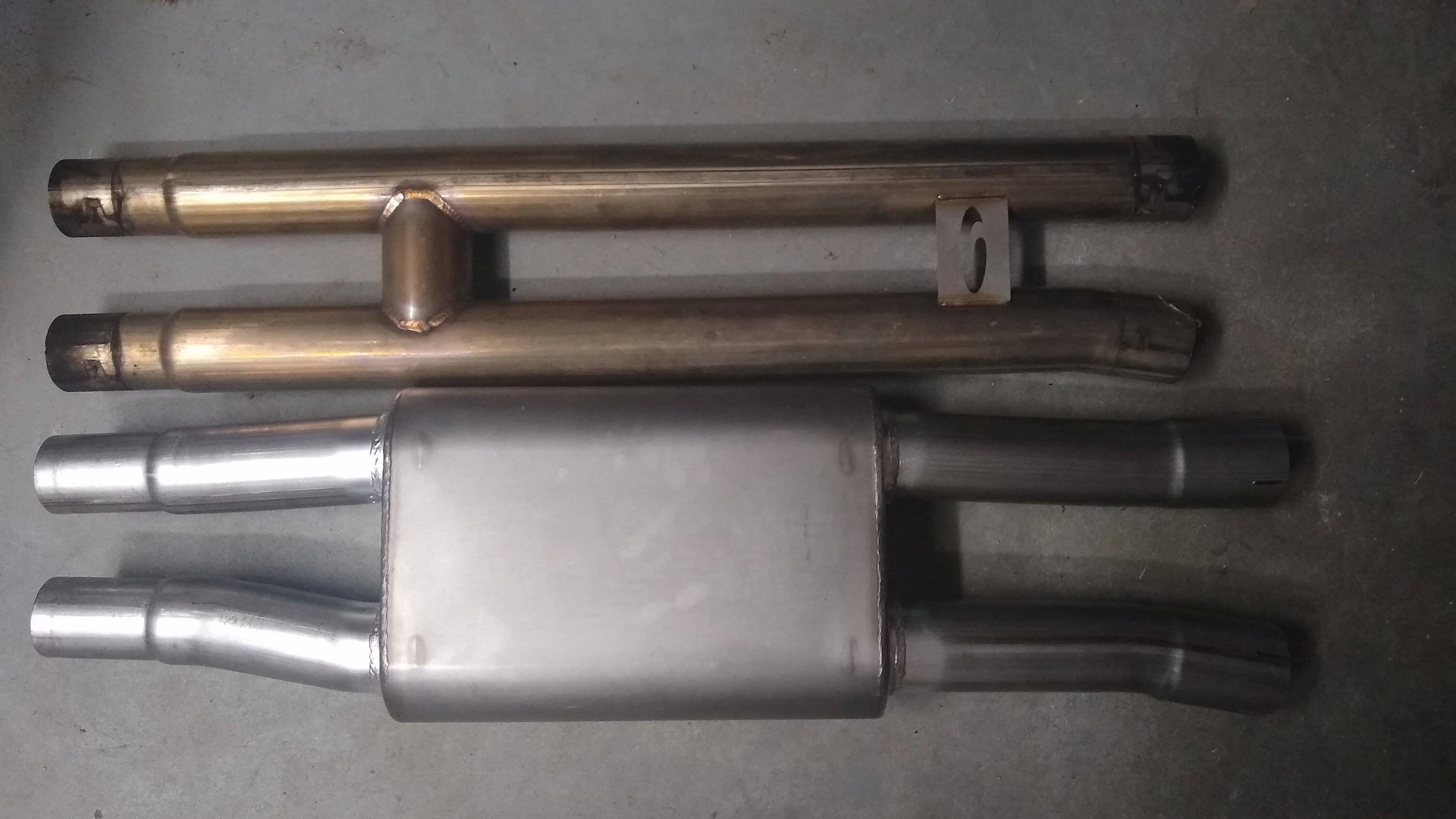

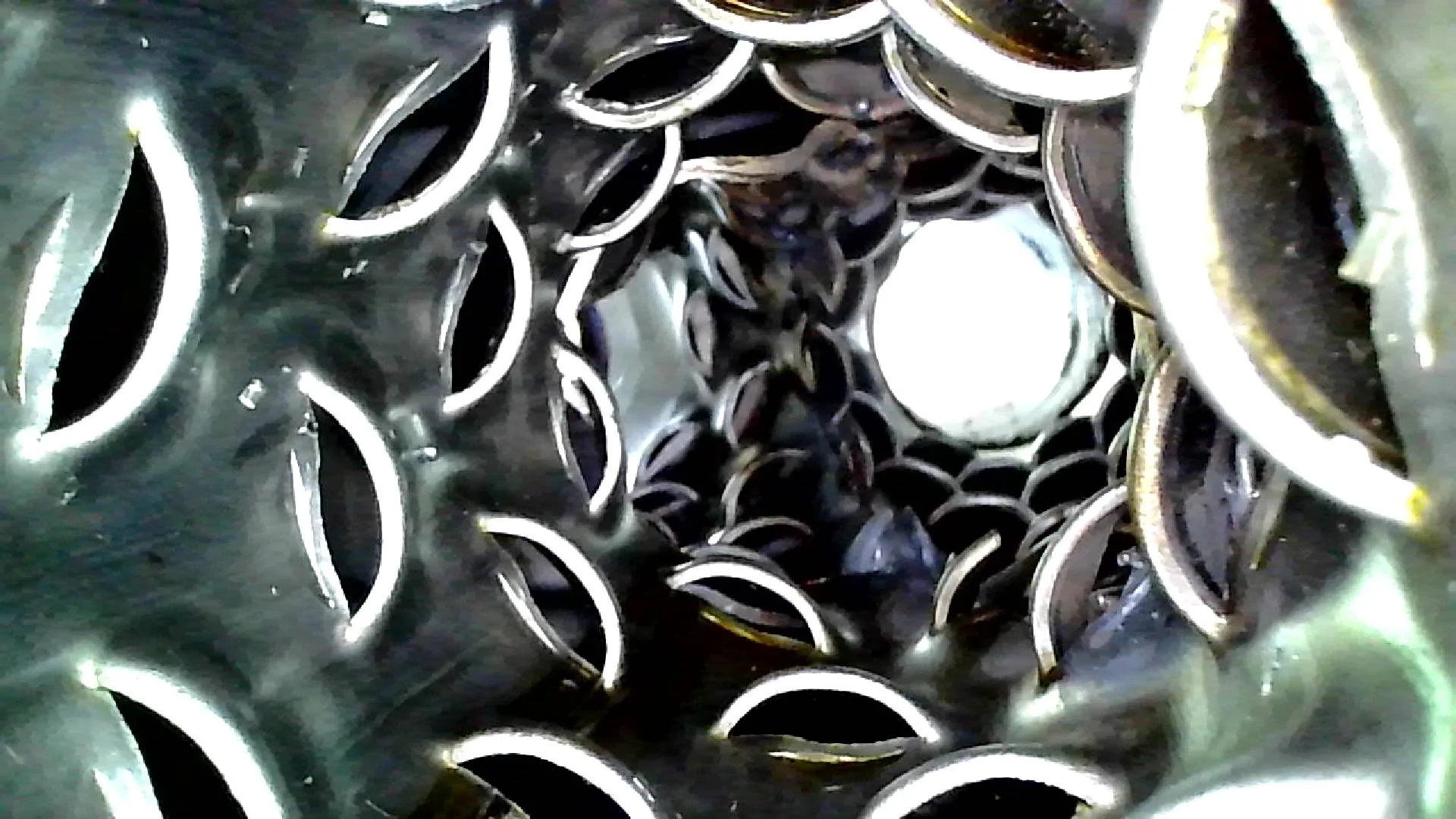

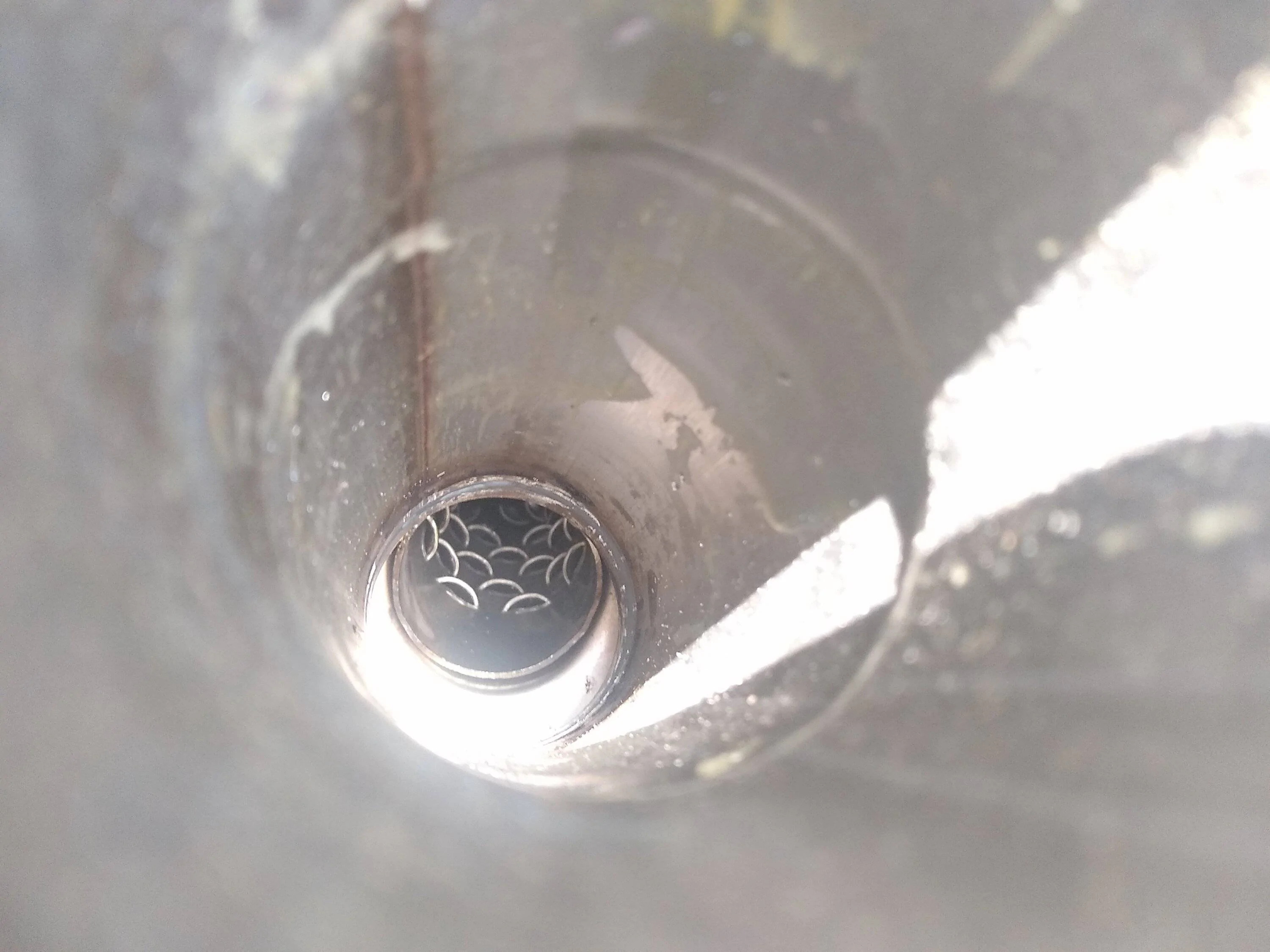

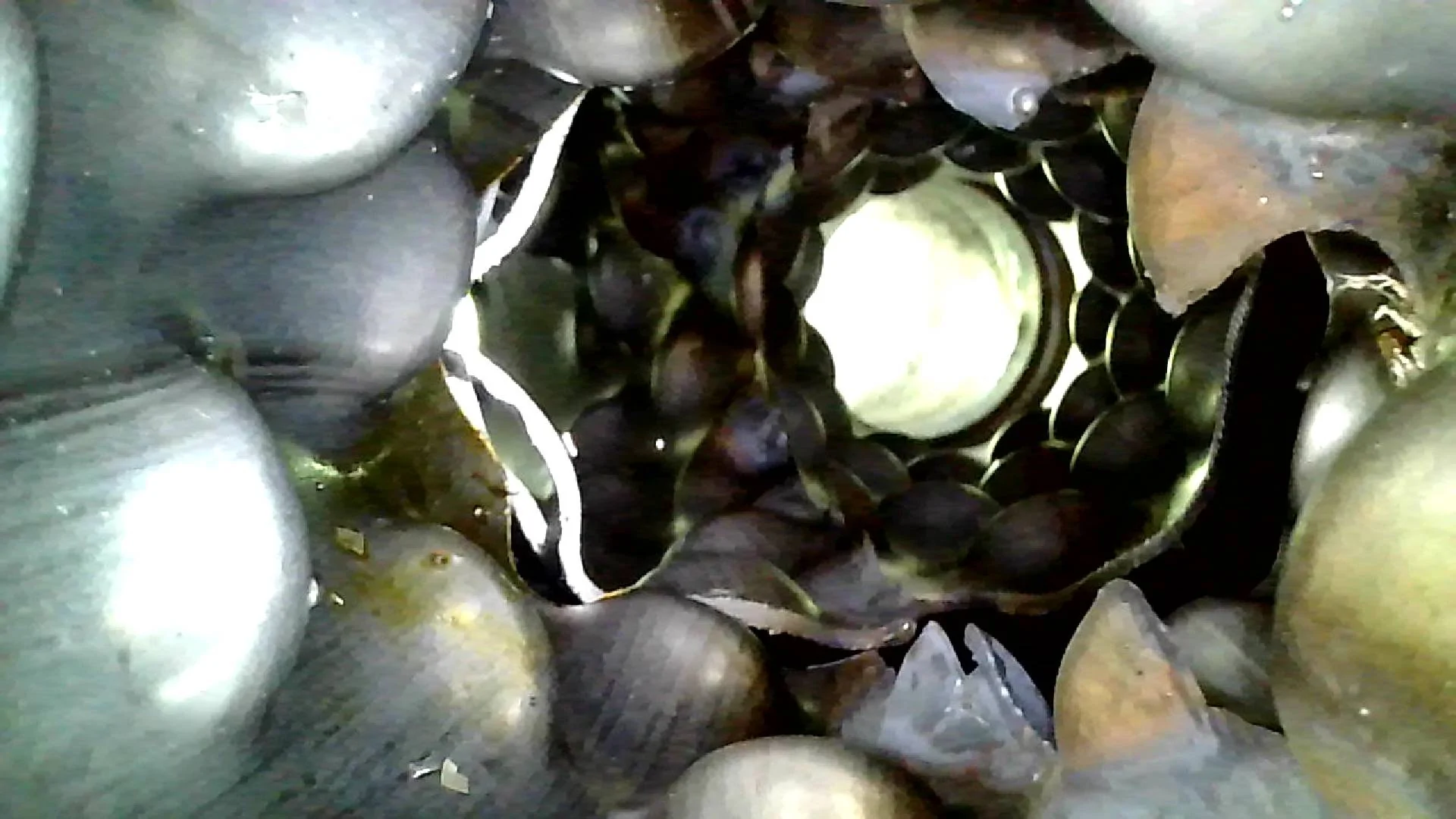

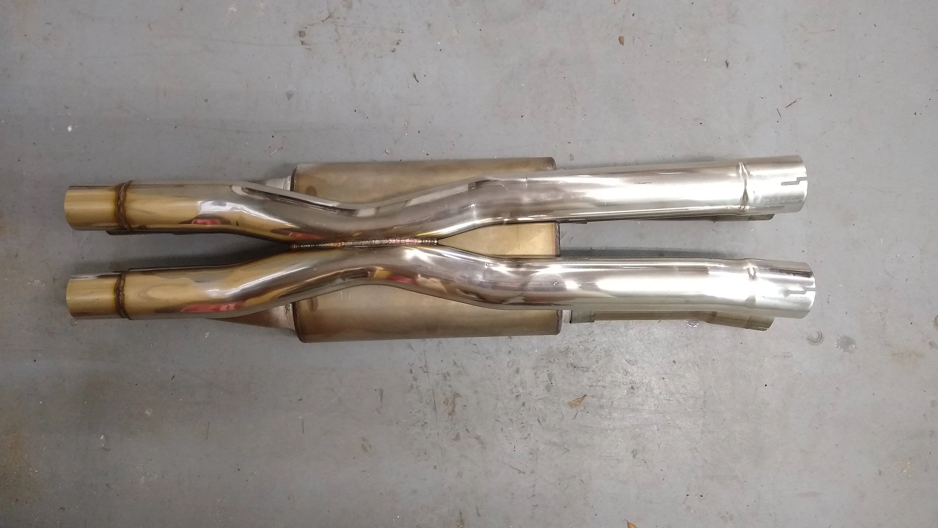

Got the Accelatec today. It looks exactly like the Gibson design with chamfered pipes in an X configuration inside an empty (no fiberglass) muffler like casing. The chamfers open towards the inlet side. In some ways, probably is more restrictive than stock resonator, but does give a very non restrictive way for one side to cross to the other. Here are some picks comparing the length to a Steeda H-pipe and from the inside using a scope. Still on the fence about cutting the stock resonator.
A look on the inside, at the cross section of the X from the inlet side.
Slightly away, up into one of the inlet sides.
Looking down into one of the inlet sides from the top.
A view from the inside, looking down from one of the outlet sides.

Finally installed it over the weekend. First impressions are that the exhaust is now more boomy at idle and while driving in track mode, inside the cabin I hear this new kind of hollow/howling sound. Did not wind it out and drove only for a few miles, but I think I lost some of the pops and the mids at higher RPM may actually be a bit quieter than stock. Comparing cold starts with a sound meter app shows negligible increase (a tenth of a dB). Overall, just gives it a unique sound. You be the judge. Attaching two sound clips of cold starts (you get some bird sounds as a bonus). First is the stock. There are some sound artifacts as I converted from FLAC to MP4 and uploaded to site. Would I do this all again? Not sure.
Edit: After driving it for some more, track mode sounds quieter compared to stock. Normal mode seems louder as I hear more sound come out around the resonator area, which is most pronounced around the 2k range. Revving it, it kind goes quite (compared to what I remember with stock).
Overall, this resonator gave it a unique tone. From inside the cabin at lower RPM, the exhaust sound is more pronounced. At higher RPM, quieter than stock. Have no idea if it is more restrictive or if the internal X configuration gives similar benefits to a standard X-pipe, but that's for someone else to figure out.

I went to an Accelatec x-pipe a few weeks back. Wanted to go back to something louder and I missed the more pronounced crackles and pops on deceleration that I had with the stock resonator. It was a direct replacement and for reference, measured about 32.75 inches from one end of the inlet pipe to the end of the longest outlet (the two outlet pipes are not exactly the same length). Not 40" inches that the support at CJ told me. One of the reasons I went with Accelatec again, as I thought they had a different size, but turns out 32.75" is fairly common for the ones with the expanded connections.
