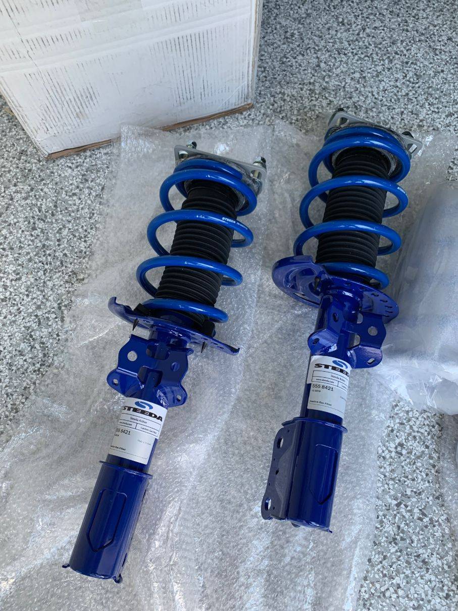

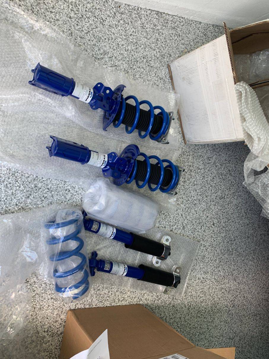

For the OP's question, get the camber plates as planned. I did the same thing recently, but went with one of the Steeda kits. I got the Pro Active shocks/struts, fully assembled with the camber plates. I also got the G-Trak K-member brace, but that doesn't matter, can be added at any time. The only bad thing is to install them you will have to disassemble the struts. Maybe you have time to call Steeda and make the change?

I really don't get the complaints on confident handling. My stock PP1 handles amazingly well, track and street. The faster you go, the better it feels.

These Pro Actives better be darn near magical before my wife sees the credit card bills.
they do a decent enough job IMO. Start with 1 turn out from closed (fully CCW)
