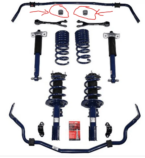

I'm about to install the FP Track Handling Pack and the only issue I'm having is the bearing / bushing removal. Do I have to swap out the old one or can I just use the one's in the car with this package? Has anyone not replaced it? Can someone shed some light or insight as to the benefits of doing so or if I'm "OK" just going with the performance Toe Links (M-5972-M), and not changing the bearings (M-5A460-M). See below. Thanks in advance.

You don't have to change them, no.
They'll help the car behave more predictably at the limits, but if you're having trouble or don't have the right tools, you could easily leave that part alone.

The FP toe bearing is about 0.020" wider than the stock bearing, so are the mounting ears on the FP Toe links. This 0.020" isnt really an issue. The toe link mounting ears will bend slightly when you tighten the bolts onto the factory bushing so not an issue.
TLDR: It'll work just fine without swapping the bearing

To answer my own initial question; The performance Toe Links (M-5972-M) were the same one's which came with the car (same P/N) so I didn't change that nor the bearings (M-5A460-M). - 2021 GT Premium.

DO NOT REMOVE ALL SUBFRAME BOLTS AT ONCE! You run a really good chance of throwing off the frame alignment, which is different from the suspension alignment. Take two bolts of the subframe out on one side, remove the sway bar first it’ll help a lot. Apply pressure to the bucket (I pushed on my rotor) and you can get the spring out.
the track handling package is a night and day difference and that bushing made zero difference to me. I know it’s used for the “extreme” but honestly wasn’t worth the hassle.
