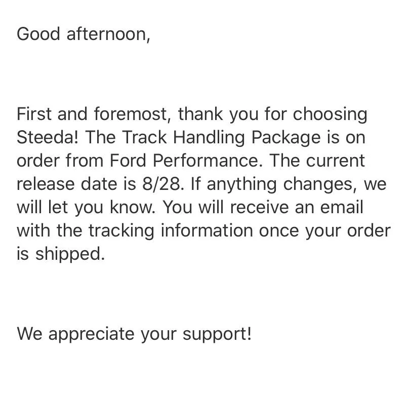

I guess I’ll have a while to think about the supporting mods. Just got an email from Steeda that my Ford track handling package won’t be released until 8/28. (Steeda still charged my credit card before shipping though....not sure I love that practice *sigh*)

It is what it is. Just thought it was an in stock item and there was no indication on the site of the delayed ship date. More time to research the rest of my supporting mods I guess.

I got a similar notification from a local vendor when I ordered the Track package as well. Going to be a long 5 or 6 weeks :(

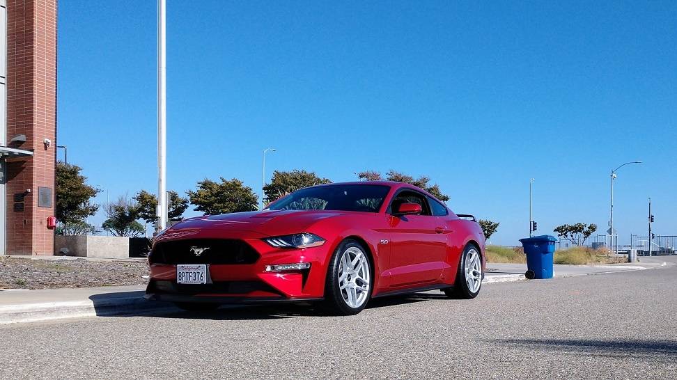

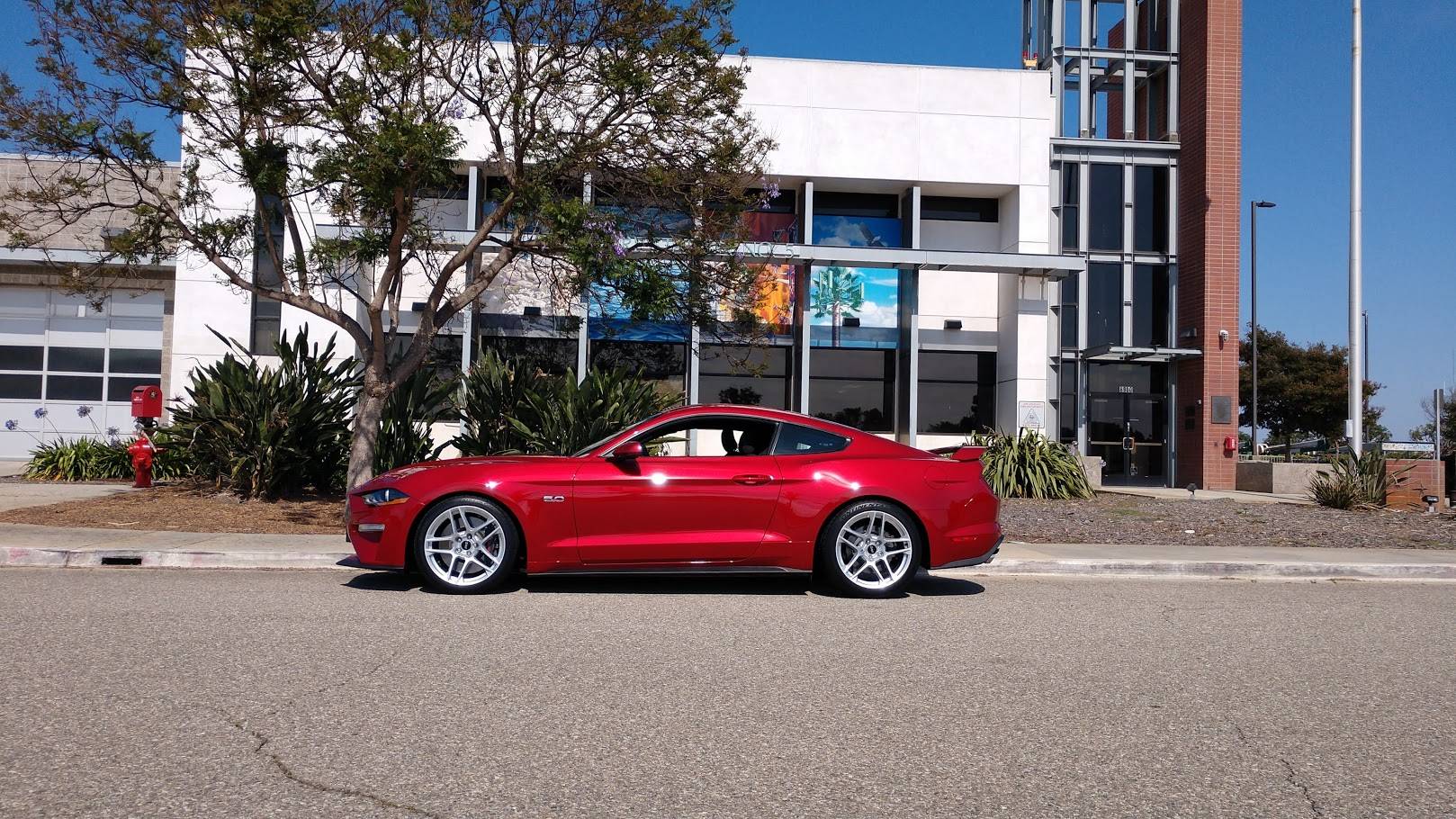

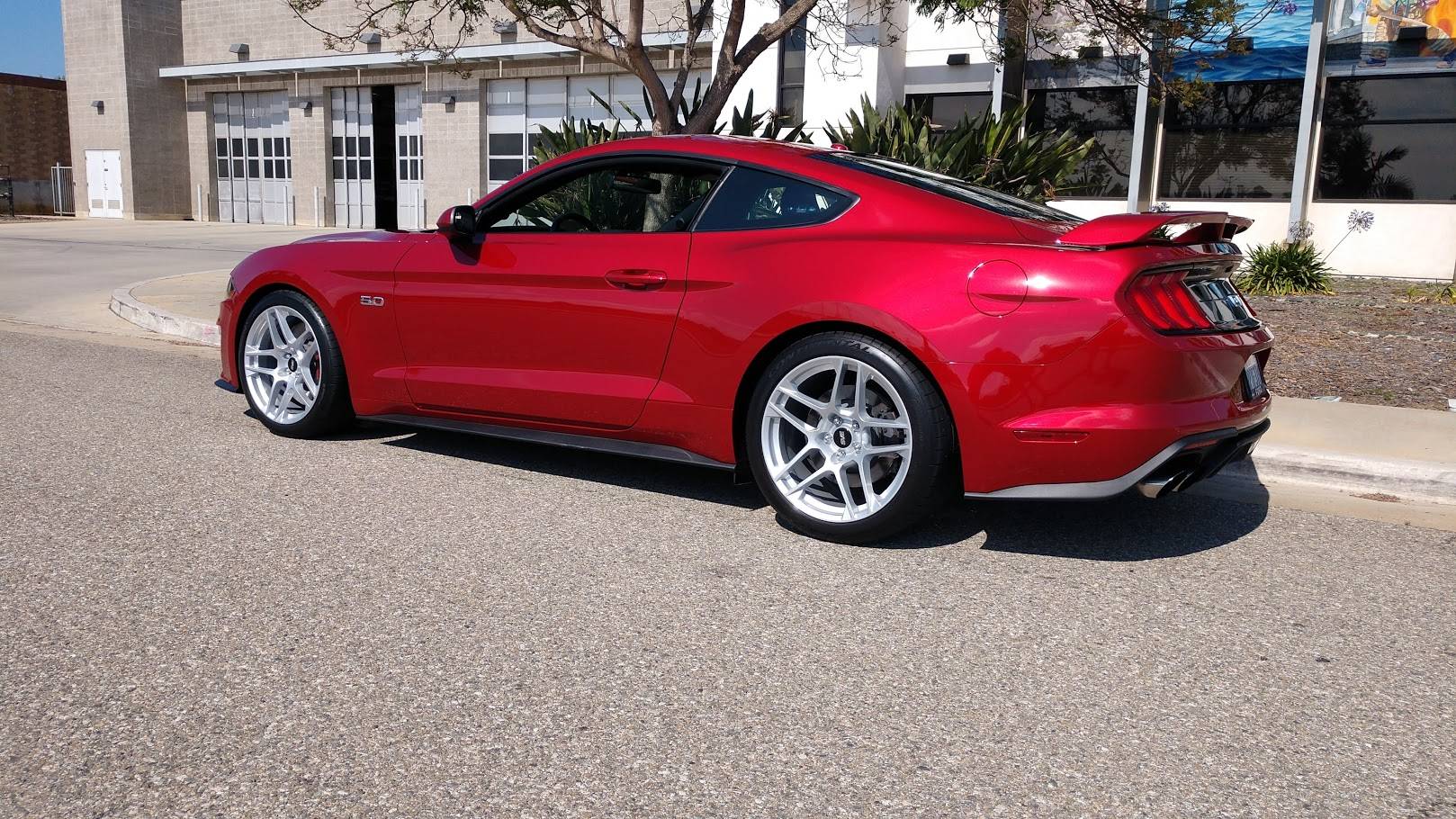

I installed the FRPP track kit about a month ago, so glad I did it. I was originally just going to do Steeda minimum drop lowering springs as that would best match them with the OEM PP1 struts/shocks. I changed out the stock PP1 black wheels for wider, lighter new wheels with 275/35/19 and 295/35/19 ContiSportcontact Extreme tires. The wheel gap was even more pronounced as these tires are .5" shorted in overall diameter. Found this kit brand new/used (uninstalled) for a great price. Jumped on it and so glad I did. Since you already have a PP1 car you won't need some of the parts but install the rest of the kit and you will be extremely happy. Maybe at a later date you can install the bumpsteer kit, but to be frank I haven't tracked the car yet but have hit a few of my favorite roads including Angeles Crest Highway and I didn't notice any bumpsteer. The car does sit lower by 1.5" due to the kit and lower diameter tires but it should have came from the factory this way. In short unless you are going to get serious with tracking the pony I don't think you need to do anything else. If you are going to track this car seriously you probably would want to move on from this kit as a whole and go on to something else anyway. Regarding Caster/Camber plates, my car was able to hit the recommended alignment recommendations that FRPP suggests without them. If you need more than -1.5 deg front then get the plates.

A few pics..
