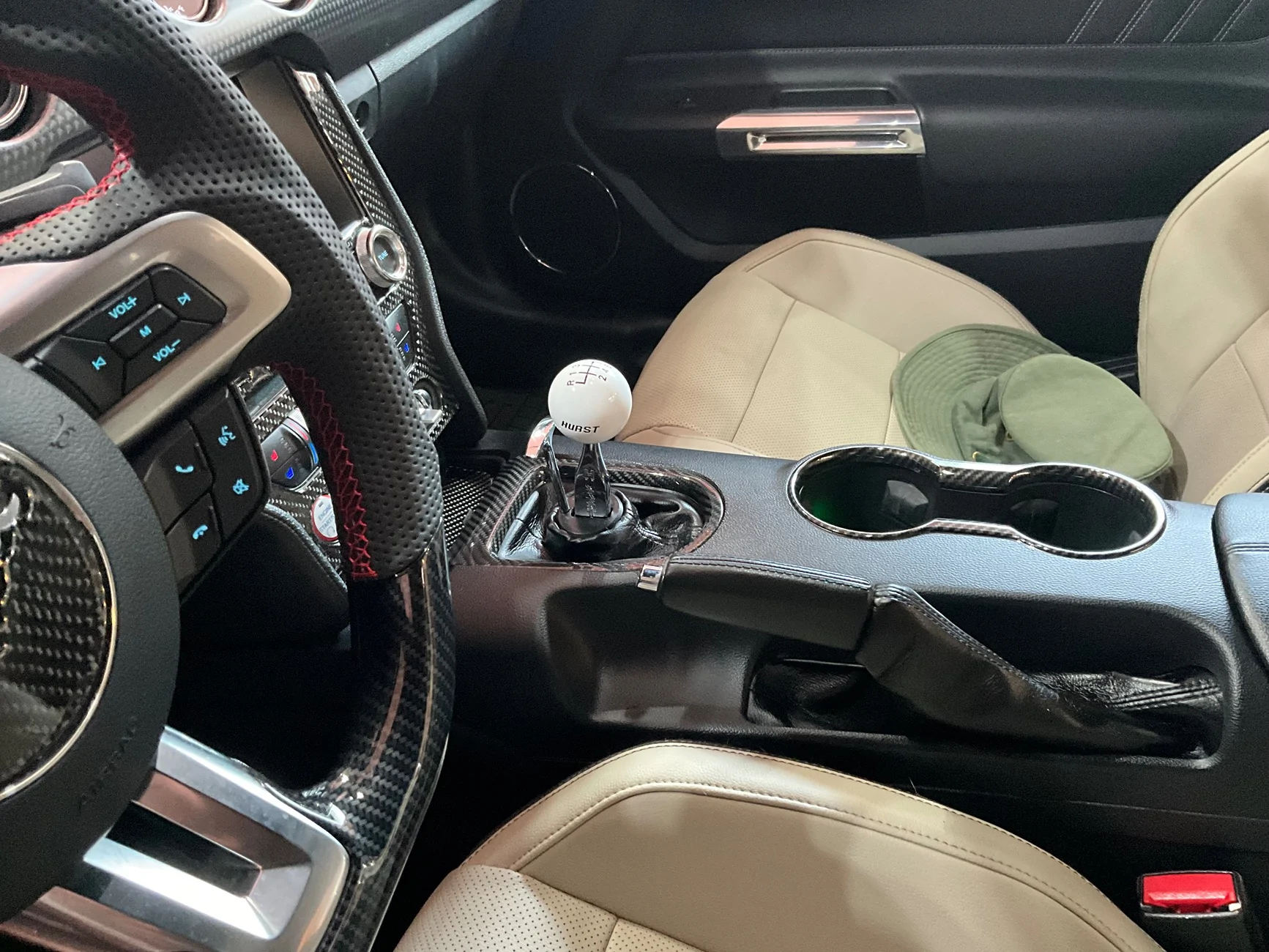

I used to have the Steeda short throw with their mount, it was good but still had lockout. Went MGW and haven’t had problems since, absolutely love it. I also didn’t mind stock, the only reason I started changing things was because of the lockout. Also added a weighted shift knob from Billetworkz. Beautiful piece, they painted it to match the Ruby Red paint
