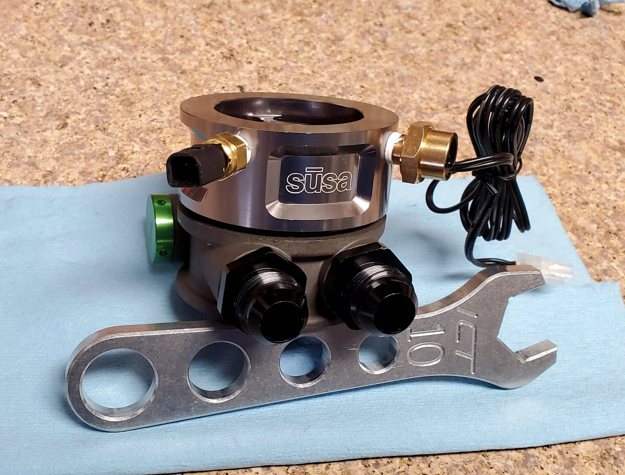

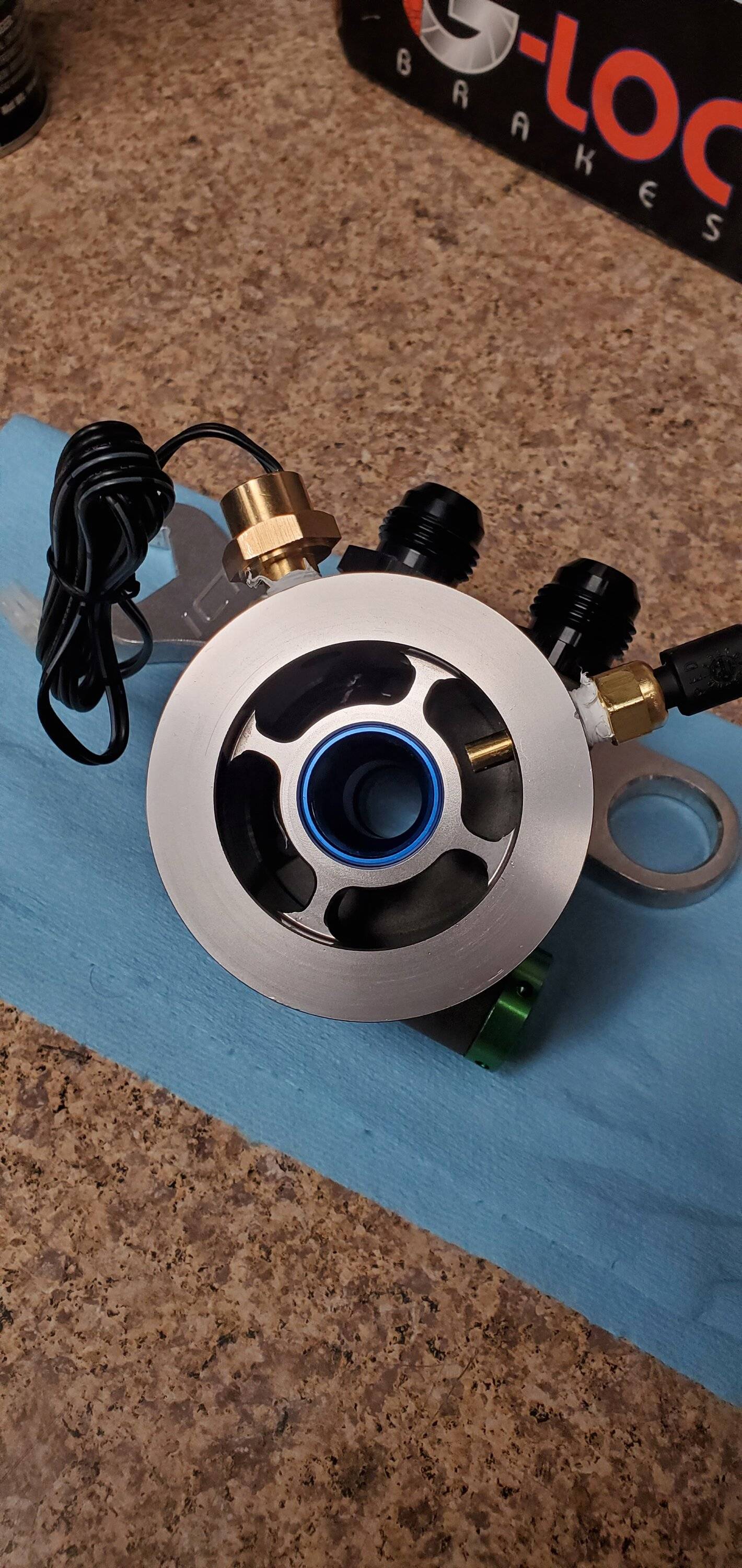

Im not sure where the guys with factory cooler setups pull temps but I have a thermostatic sandwich plate and spacer with sensor ports on my car.

I first T'd off the oil pressure switch to get actual oil pressure and temp, but that was a mess of fittings. I did not like how much leverage is on that little T with 3 sensors.
I then went the Susa route with a stack like like Ryan_s550 pictured above. I don't like the stack much either, but I like it more than a mess of fittings.
I was leery it would all stay tight, but I have quite a few track days now with the Susa setup and it seems to be working well.
If I was going to do it again, I think Susa has 1 fitting on the Oil Cooler Sandwich plate available and I'd get the Susa M22 90 with sensor port that's available. Thread that on my Setrab Cooler inlet. That would allow you to eliminate the Susa sensor spacer from the stack and be able to run both oil temp and pressure.
