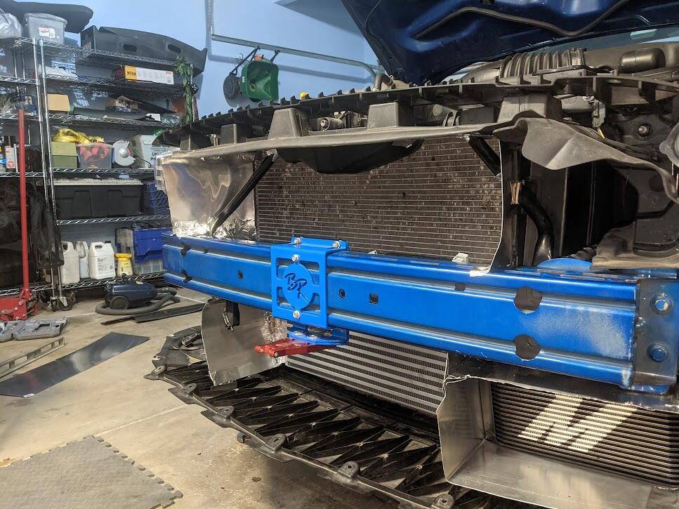

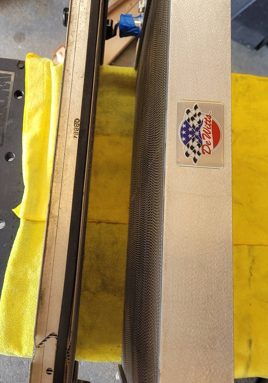

I went with De Witts radiator - https://www.dewitts.com/. Top notch quality and flow. Here are some side by side comparison pics with a PP1: https://www.mustang6g.com/forums/threads/ewheels-road-course-build.123490/post-4113692
That thing is massive
Which one did you get? They list a HP and a Pro. Says they are direct fit but the radiator in your pic looks too big for direct.
How did it change your coolant temps.
I went with the smaller one 😄. I have roush SC, and even with extra intercooler radiator and ducting and SC belt on the other side I was able to fit it with some minor mods. I'm pretty sure it will fit even better for stock engine. I don't think the bigger one would fit the supercharged setup without more substantial mods.

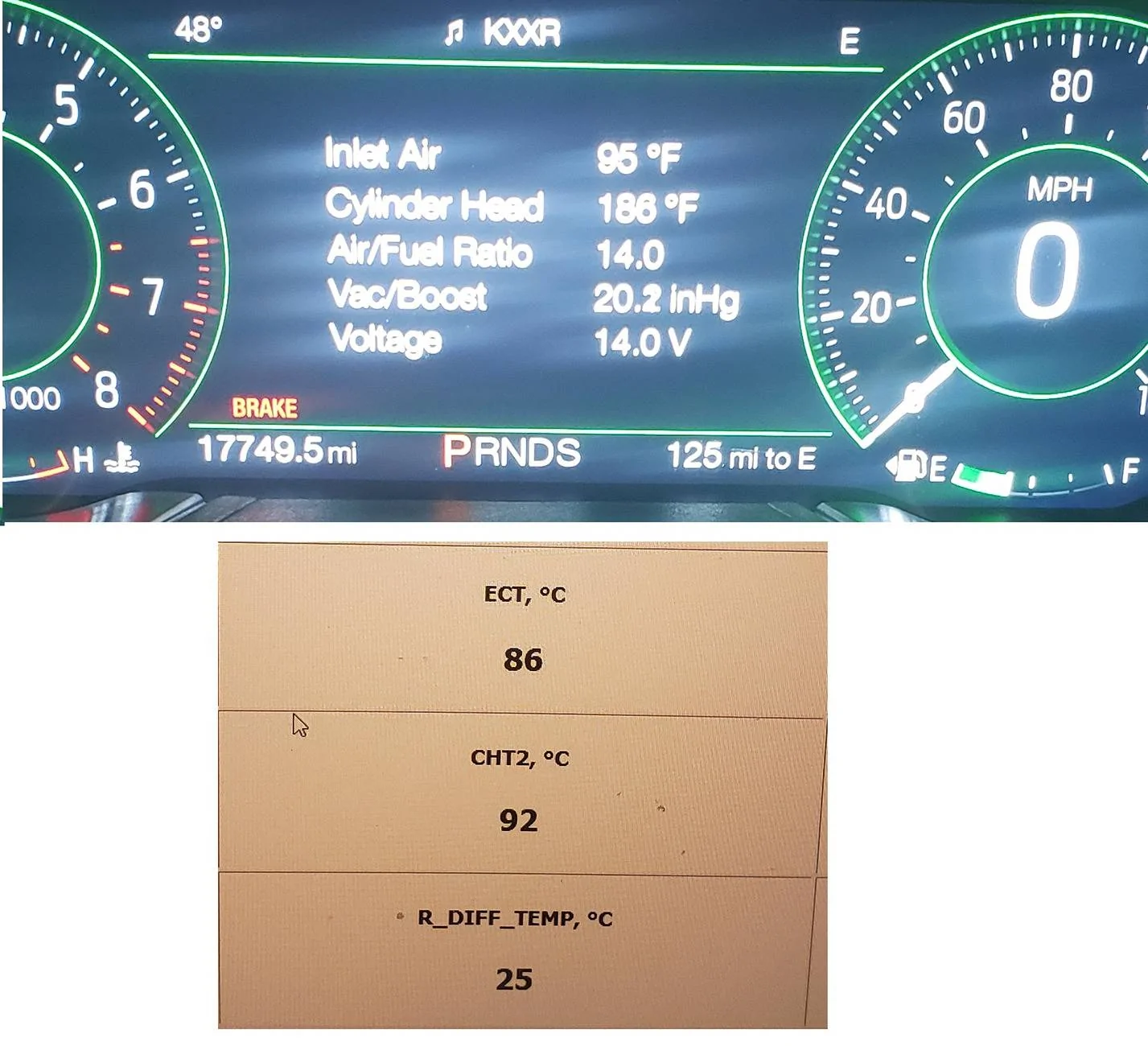

Also, are you sure it's ECT and not CHT? At least on a GT, there is no coolant temp sensor and it's a calculated value, so monitoring it is not the best.
i wasn't monitoring ECT on my tuner, just background logging. but it was listed as ECT on the device. i have compared ECT vs CHT on the display in the past, and they matched. i do watch CHT on the dash while on track though, and i have seen it over 240.

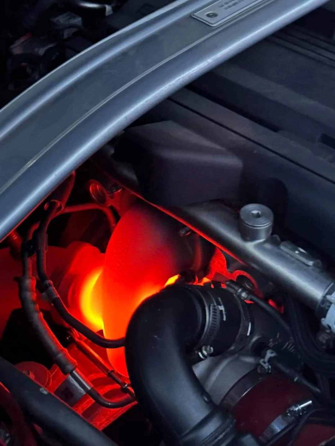

I would pick easiest try removing fake hood vents and see what logs say. Theres so much room in EB engine bay airflow through the bay out the back of bay is not an issue.
A turbo blanket would likely help a lot.
