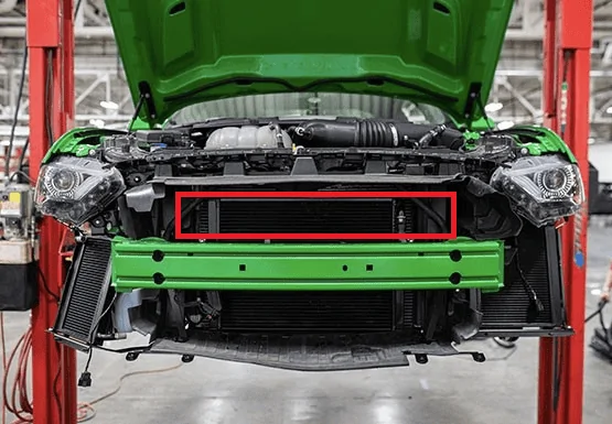

Like in above link, I'd like to preserve the factory water-oil cooler, which the Harrop option does not seem to allow. And just my guess is that that cooler alone might not be sufficient. it's based purely on the fact that people have to install much bigger oil radiators to make it work.
I don't know why you'd want to retain that water/oil cooler which is a grenade ready to go off. The Harrop is significantly bigger than the one Ford puts in the Mach1.
Agreed. I dont see the advantage of keeping it myself. Your overall cooling of both systems are the same whether they are joined or segregated. The dedicated oil cooler lowered my coolant temps significantly, more than the upgraded radiator. Either way you are likely going to have some problems keeping everything as cool as you would like without a serious cooler.

Think of this, your overall cooling capacity is limited by how much heat your coolers can reject. Keeping the water to oil cooler will just make your radiator have to reduce coolant and oil temps. Im not saying it couldnt work as a pre cooler before going through your air to oil cooler but your overall system capacity is the same.
That is a good point, I didn't think of it from overall heat capacity perspective. The amount of heat produced does not really change, so with everything else being equal, water-oil cooler may not do much as long as everything else is sized properly. I'll give it some more thought.

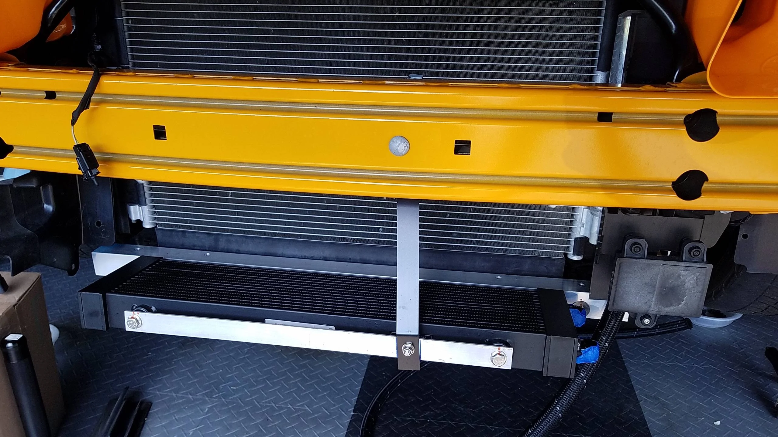

@tosha thanks for the mention.
You can go to my post in the link above, and then look for my other posts after it. So far my solution seems to be working well. Temps are under control and steady up to 30min sessions, but only tested around mid-80s ambient so far. I have not sealed off my air leaks yet. I run A10 and paddle shift at redline 3rd to 7th. However my tires are only 275 MPS4 square, so that helps.
My logic was to keep the oil/water cooler, because I thought that every little bit helps. I guessed that that cooler had to be worth at least 20kBTU/hr rejection.
Note that I chose the Setrab Com cooler which at 2" thick is thicker than the Harrop unit, and rated over 50kBTU/hr. It is pricey at around $700. It took a lot of trial and error figuring out how to get it to fit like the Harrop setup.
So if my solution gets me 50+20=70kBTU then that is about as much as the much larger Setrab units that guys have placed in front of the stack.

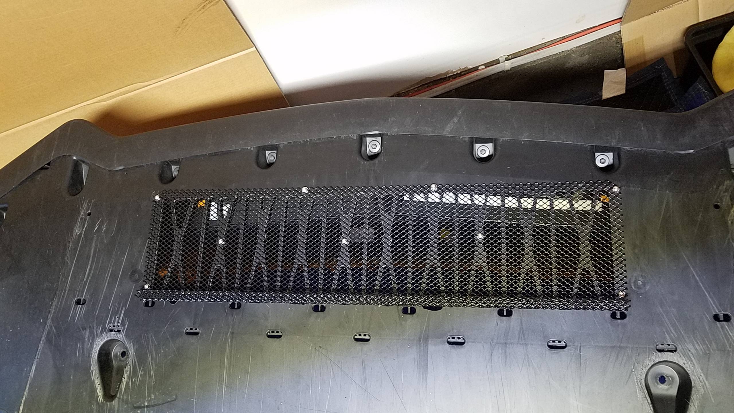

I opened every cell in upper and lower grilles. The lower plastic shield above the belly pan is lifted up to force the lower grille air exclusively through the cooler and then out the holes I cut into the belly pan. No extra hood venting yet.
Only 3 aluminum bracket pieces were needed to suspend the cooler, and 4 rubber grommets from Improved Racing isolate vibrations.
I can put together a nearly turnkey kit for anyone if interested.
I have heard it is nearly impossible to keep a SC Mustang cool on track. I am running OEM PP radiator with original coolant. I run 0W40 Euro oil for track season, and 5w30 off season.

That looks really nice. Setrab makes top notch parts. I used there thermostatic sandwich plate on mine, and might eventually get one of their coolers that has similar dimensions as my current setup. Not all cores are equal.
It isn't impossible to keep a supercharged car cool on track, but it takes a lot of work. There is a reason that you don't see many supercharged cars on track, especially fast ones (I've seen exceptions). The exception being for sprint/time attack type setups. Its not difficult to make something last for a lap. I don't have significant problems with ambient temps under 80. That generally gives me a window to go to the track between late October through April.
I think you are correct that the factory cooler will add some heat rejection to the oil system, however its that much less heat that you can remove from the coolant system. Nothing necessarily wrong with that since both contribute to cooling the engine. More than one way to skin a cat.
I like everything about it, except the price 😄 . Wonder if you or anyone considered this as an option: https://www.improvedracing.com/mhx-245-high-efficiency-oil-cooler.html
They claim double capacity compared to similar size Setrab units. No BTU ratings though.
What's also strange about Setrabs is that they should hold a lot more oil than indicated in specs. They one you picked should have over 3L of capacity based on core dimensions, yet it holds only 1.1 Qt. Not that I don't trust the specs, I just don't fully understand why.
