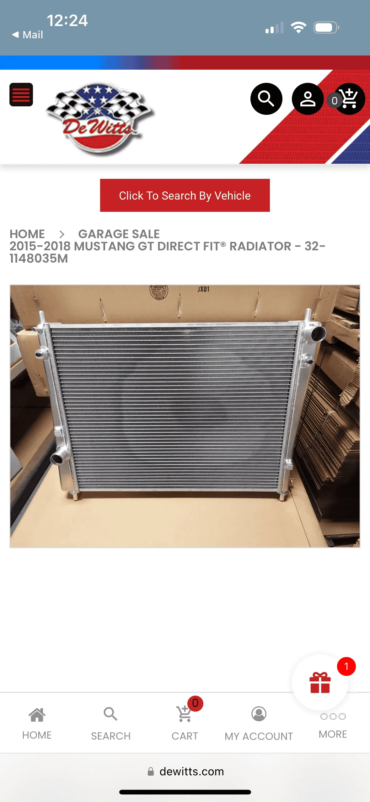

Just pick up Dewitt’s HP radiator was week for $300 from there garage sale.just had a stain on the core.the fan should cover all of that

We’ll just found out the Dewitt radiator doesn’t fix automatic cars.it sucks I got a great deal on and its a really nice well made radiator.The stain on not that bad and the fans will cover. I’m going to call them tomorrow and see if they will that it back.Don’t think so because it was a garage sale & was as is.might have to try and sell it.I’ll be look at other rads and they all seem to work with automatic cars. I just should have ask that when I call them ,but it does say for manual on they web site.I like the C&R but it’s pricey !!!

We’ll just found out the Dewitt radiator doesn’t fix automatic cars.it sucks I got a great deal on and its a really nice well made radiator.The stain on not that bad and the fans will cover. I’m going to call them tomorrow and see if they will that it back.Don’t think so because it was a garage sale & was as is.might have to try and sell it.I’ll be look at other rads and they all seem to work with automatic cars.I like the C&R but it’s pricey !!!
What do you mean by " doesn't fix automatic cars"?
I'm sure you could find a workaround if the issue is simply fitment with the separate OE trans cooler.
