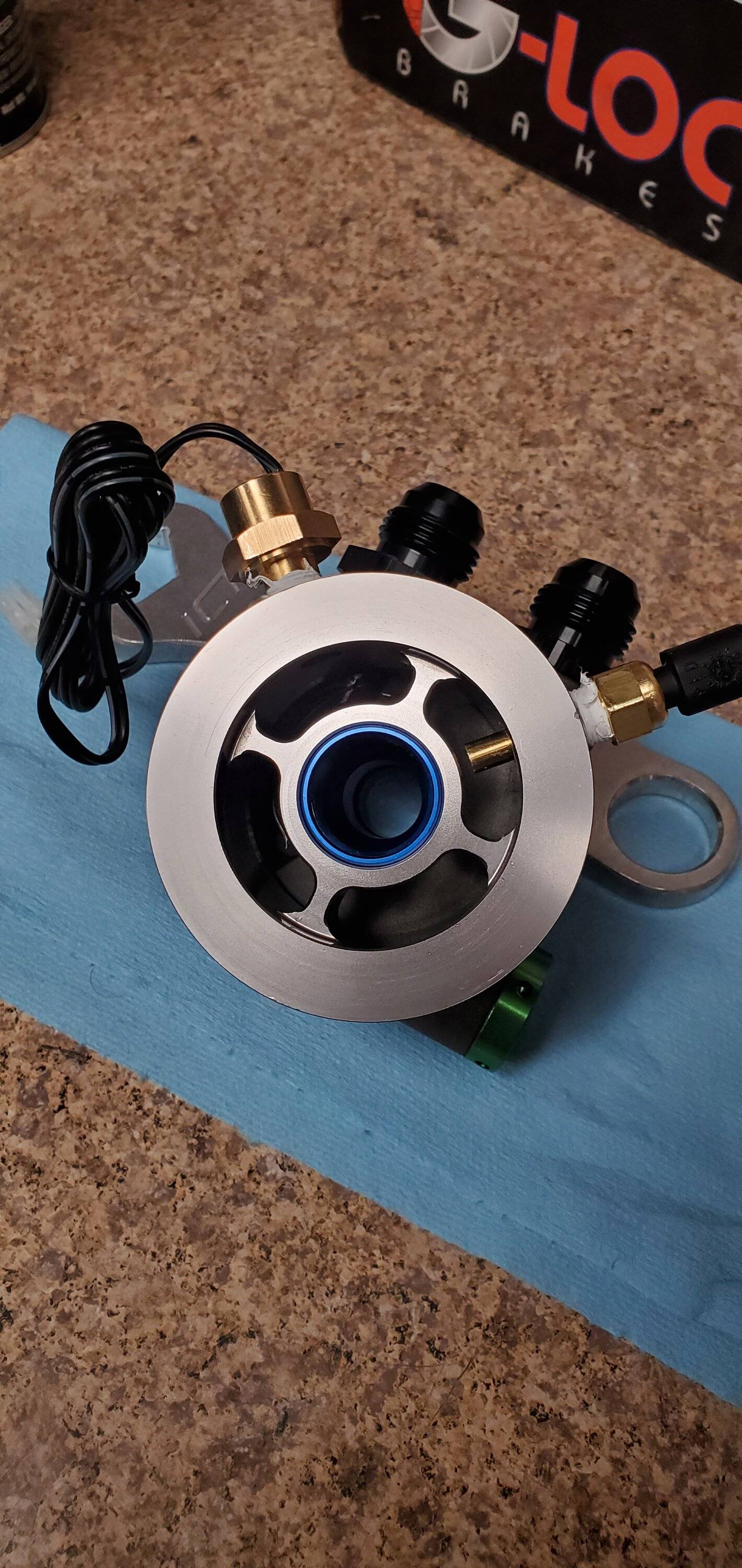

Id like to make a suggestion.....an oil cooler will lower your CHTs more than an upgraded radiator. Your radiator is doing double duty trying to cool both your coolant and it circulates through the oil cooler. If you are serious about running your car on the track for extended intervals, boost isn't usually the answer. With that being said, Ive been running a 16 GT Whipple car for years now. I'm very conscious about temperatures. I've done several things to make it work. I only run it on the track in sub 80 degree temps, and ideally cooler. The upgraded whipple heat exchanger keeps IATs in check. I upgraded to a mishimoto radiator from a standard GT radiator. The GT500 hood gets a lot of heat out of the engine bay. I also run the car on e85 which helps keep cylinder temps a little cooler and ensures I don't see any knock. I usually see CHTs sub 205 degrees, and oil temps are usually around 230. Running all out Ill see oil temps creep up to 245+.

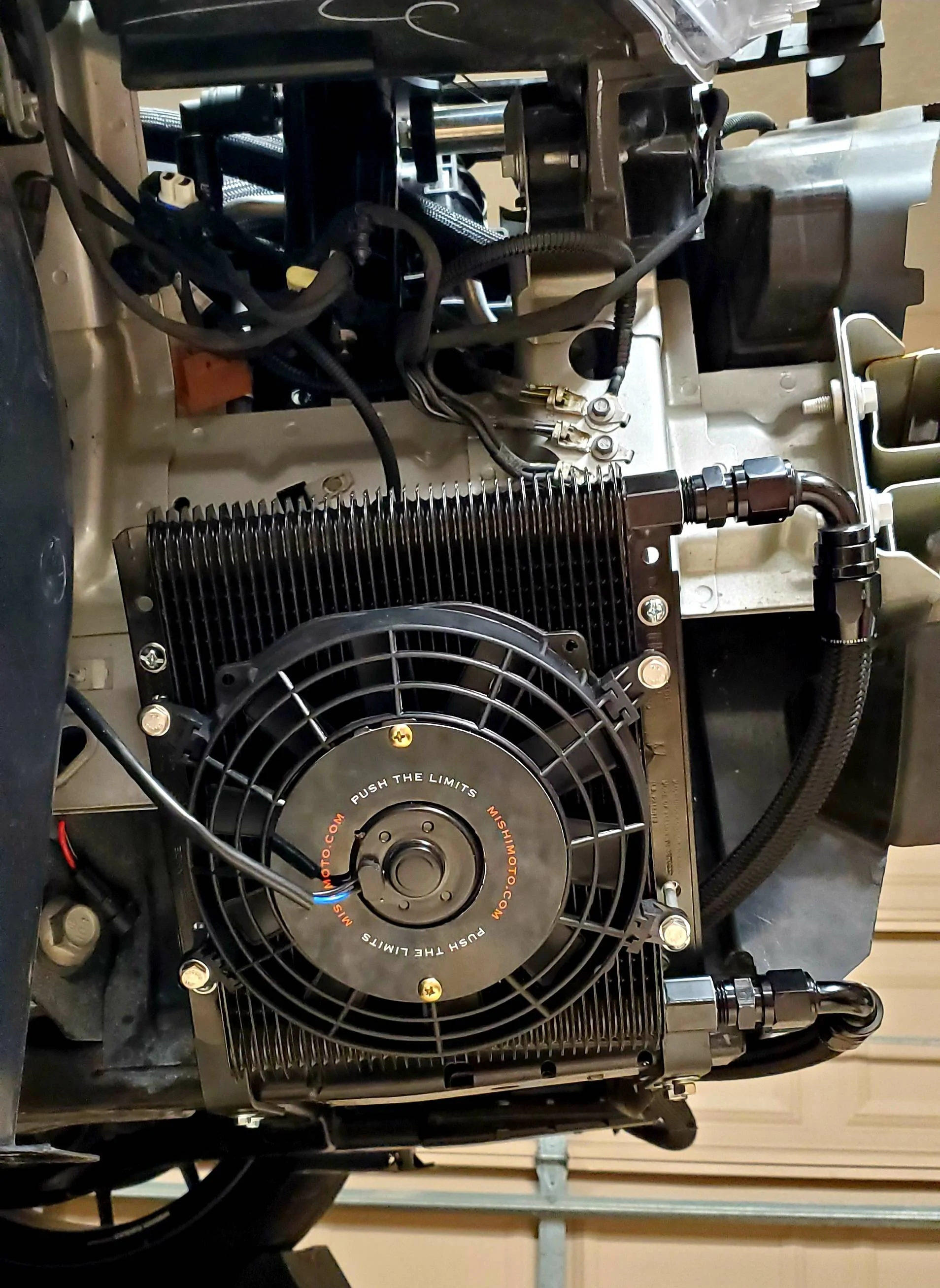

The most significant mod was by far the oil cooler. Due to the size of the Whipple heat exchanger I removed my washer fluid tank and installed a cooler in the fender behind where the fog light was. Id highly encourage you to install one, otherwise your are going to keep chasing these temps with minimal results.

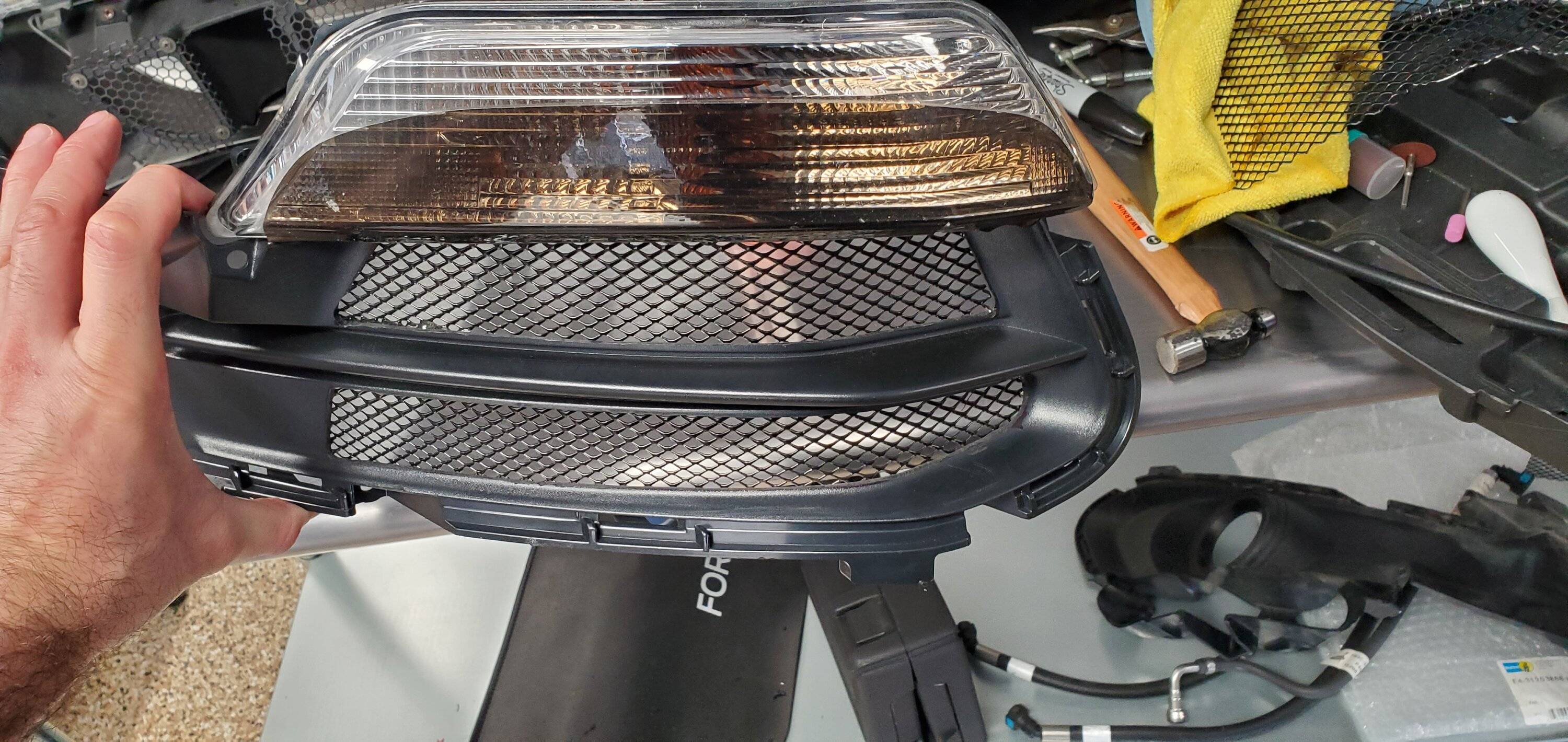

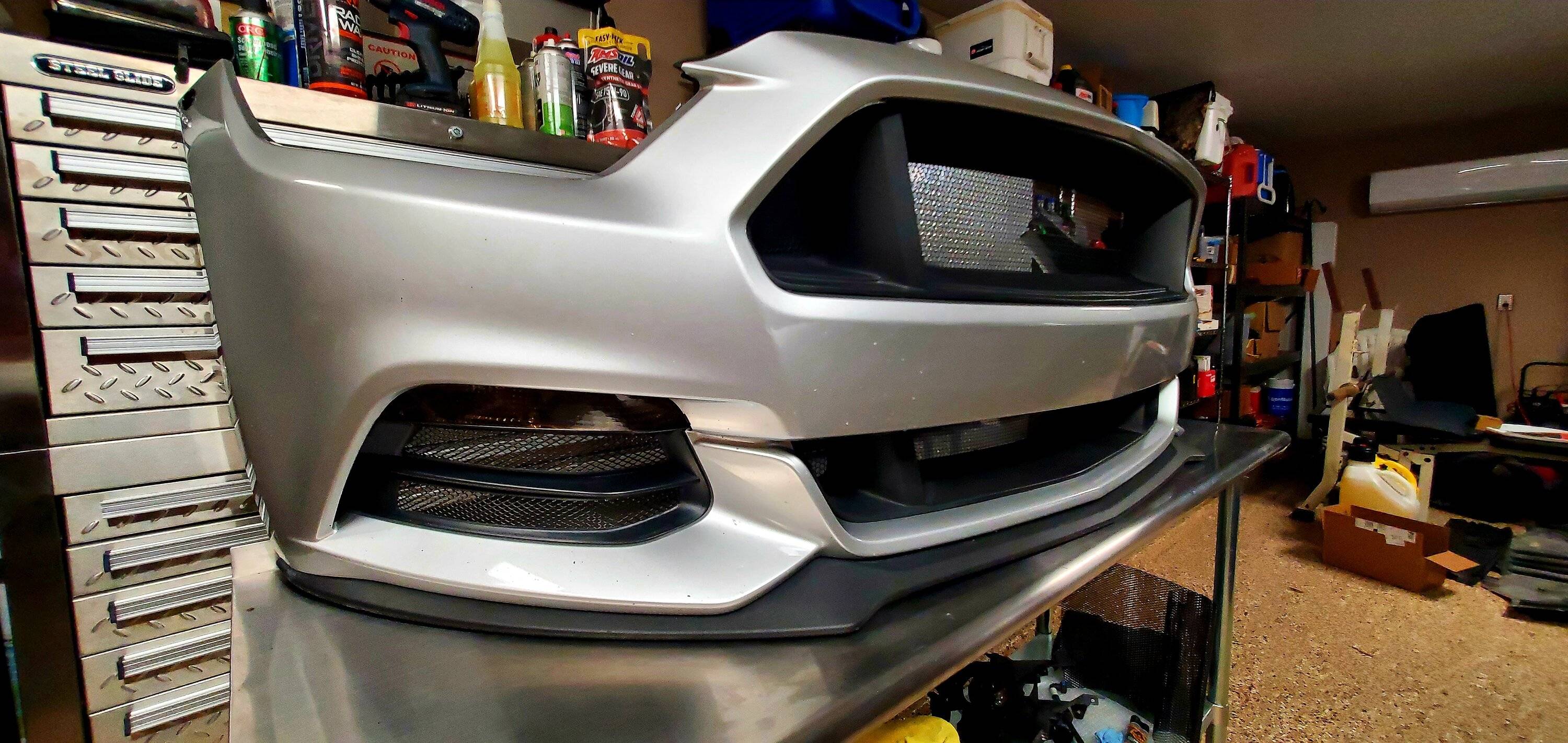

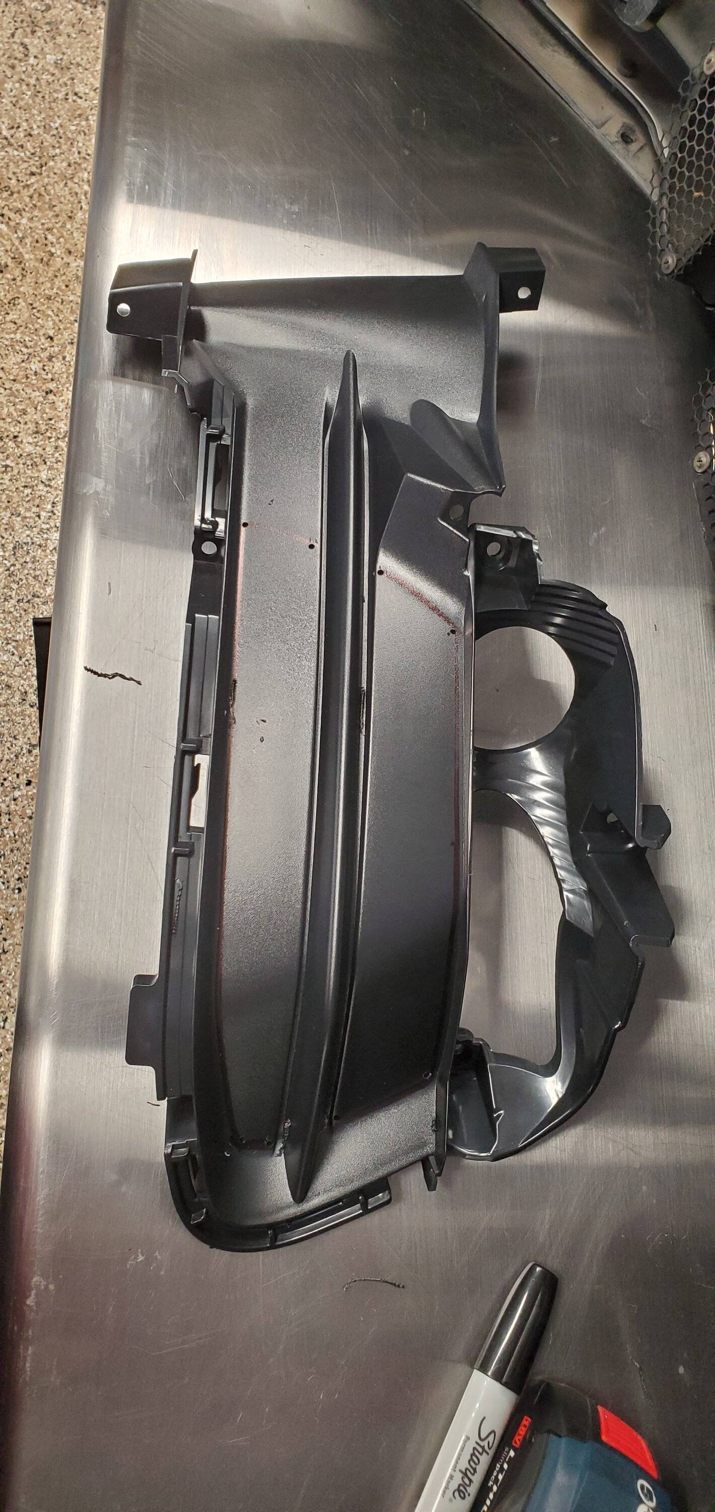

which oil cooler did you end up using and how did you open up the bumper for air intake?

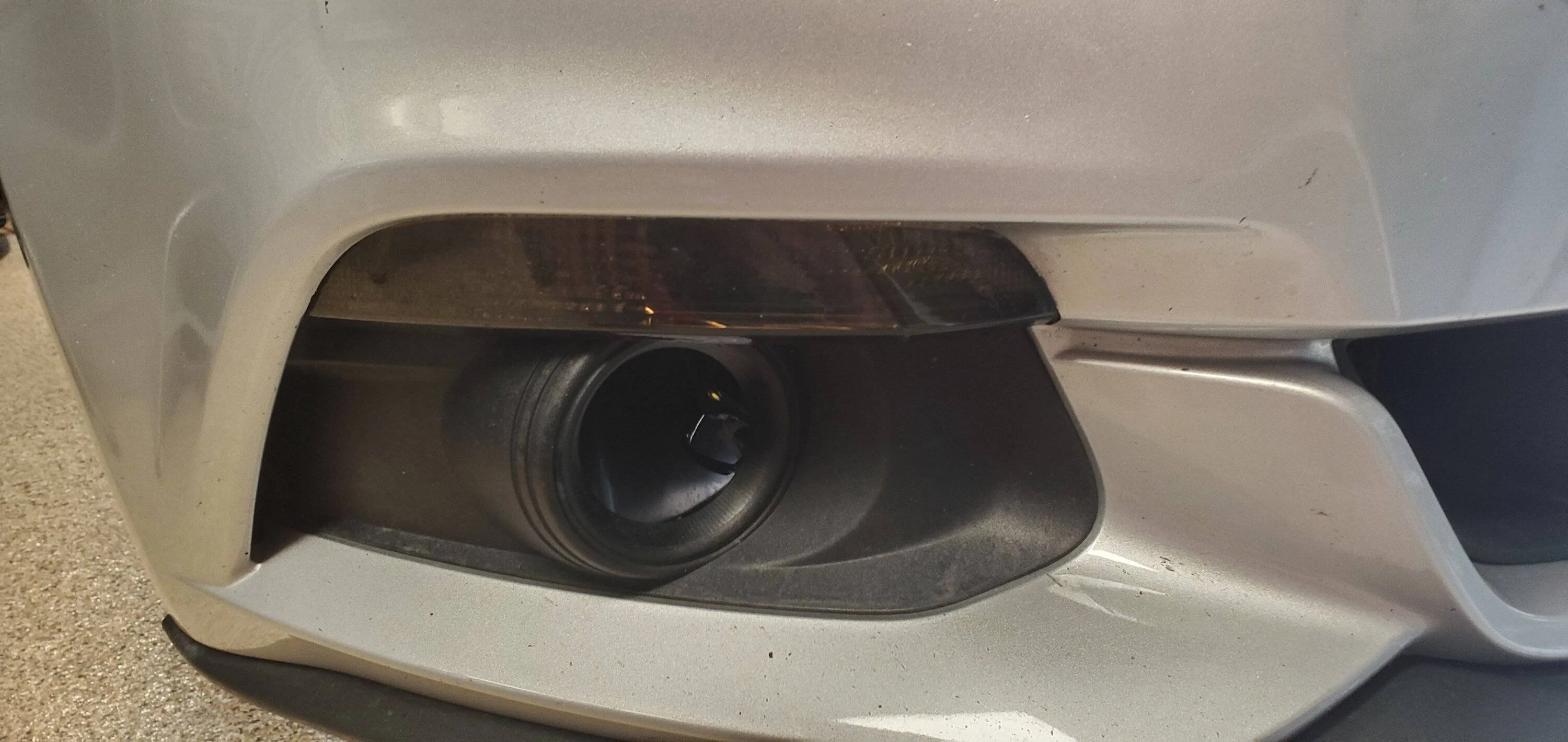

Its different for a GT350, they already have openings under the fog lights. I removed the fog lights and replaced them with V6 Muatang trim pieces. I opened them up and added wire mesh to get air to the cooler. The cooler doesnt get forced flow across it so I had to add a thermostat controlled fan. The cooler was just something I had laying around. None of the kits available would work.
