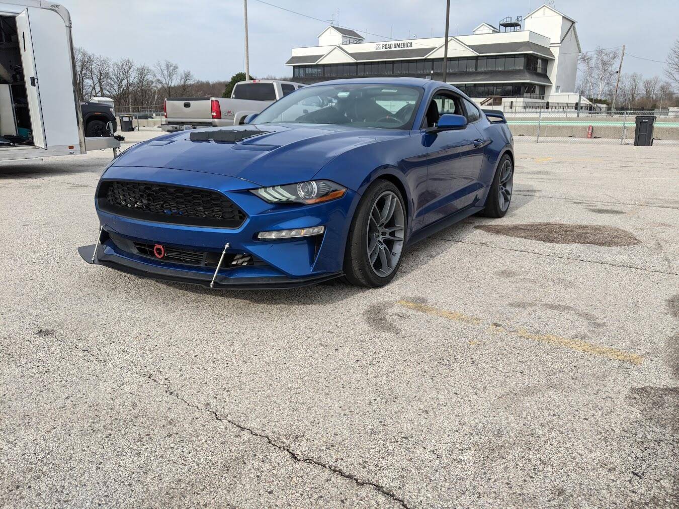

another ecoboost user here did ducting, trackspec vents, and a oil cooler and didn't last the whole 20 min at road america.
Is there a picture of his bumper by any chance? Curious what he used as a grill for that side oil cooler

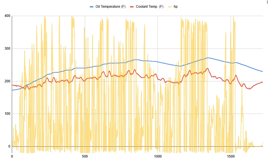

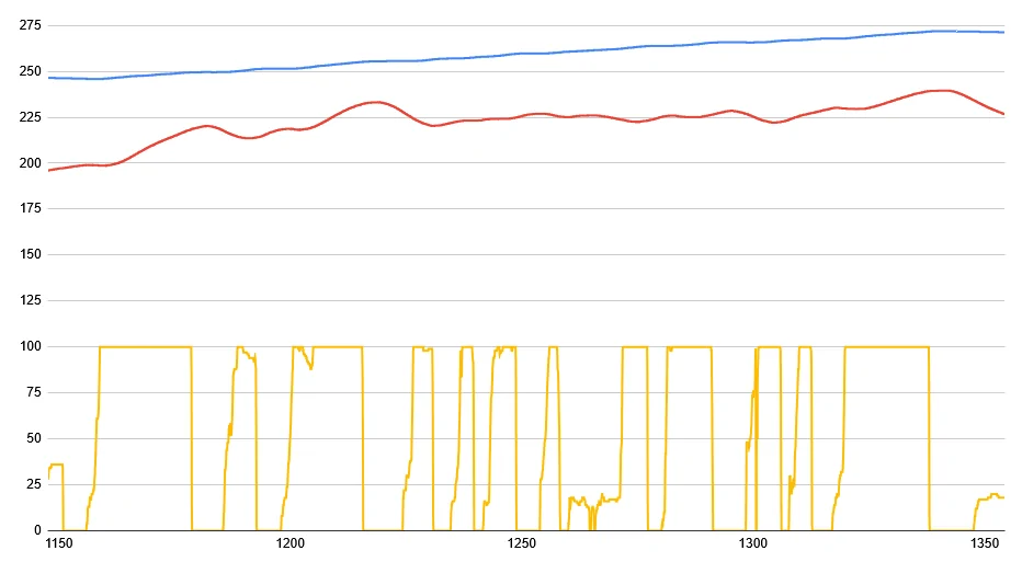

the average was 227 with a spike to 247 at or after the end of the lap. i tried my best by picking out corners by the throttle trace. what's next after a radiator; hood vents or oil cooler. i will probably try and open up the upper grille
i imagine the turbo and head-intergrated exhaust dump a lot of heat into the cooling system.

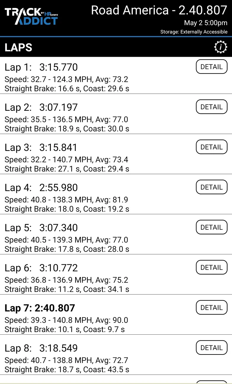

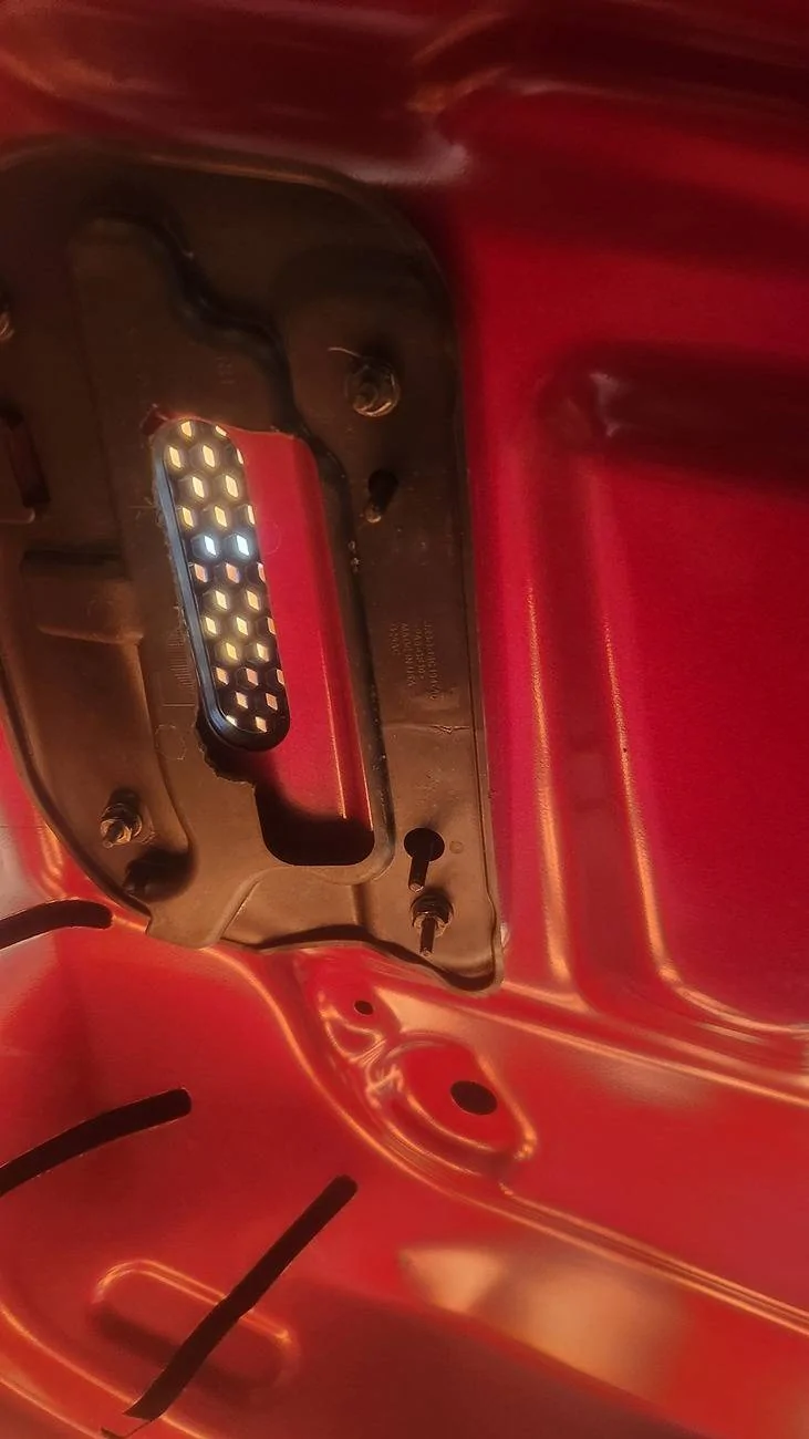

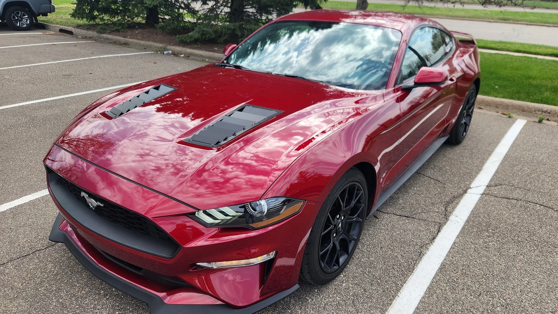

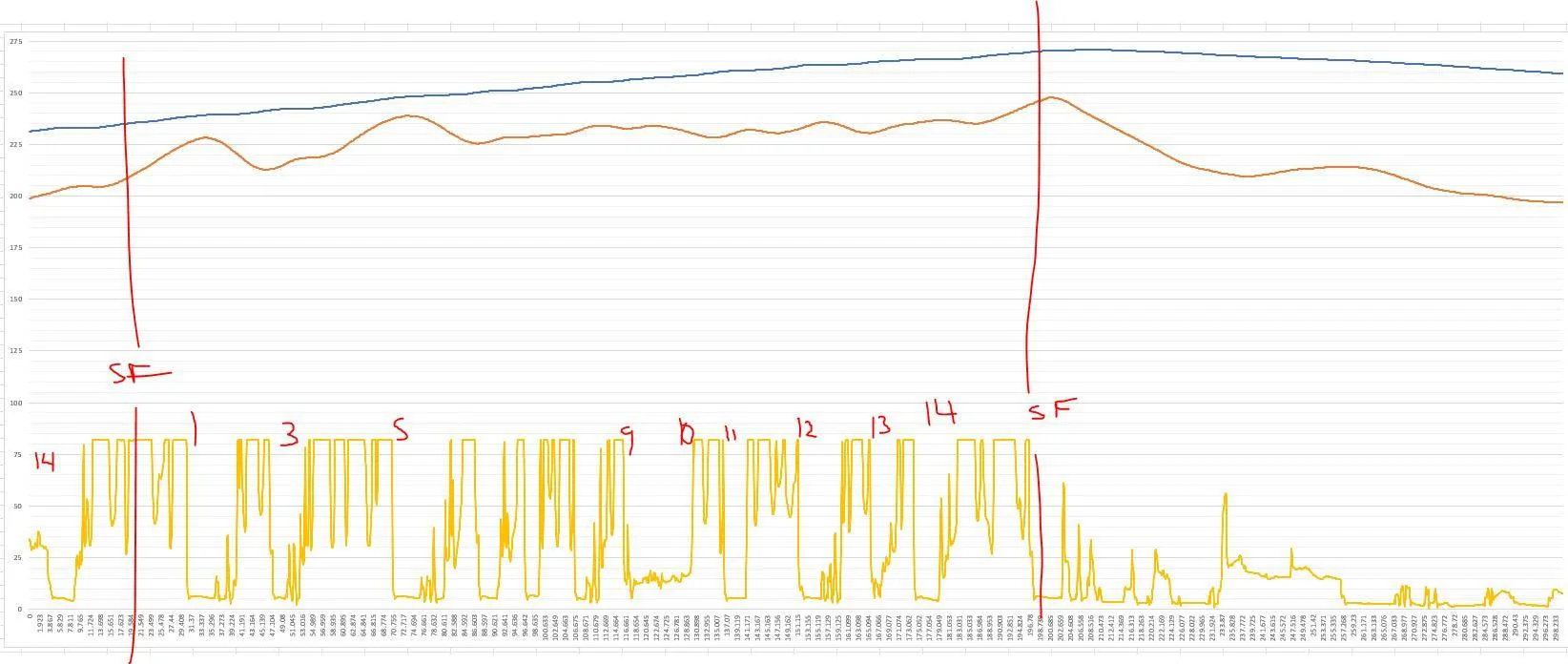

follow up after this year. I added @GTP hood vents, along with a larger turbo and a turbo blanket. i DID NOT get around to opening up the grille honeycomb. Not only were the temperatures more stable, but according to the datalogs, it was making ~80 more hp/tq than the stock turbo, but it also had less falloff over a lap. Both were on E70 pump fuel, although this year i mixed in a little fuel factory E85 to get it a couple points over e70. i believe both events were around 55F, and i still used defrost on full power. you can see in the laptimes i only went for 1 hard lap in this session because there was a stalled car on the outside of turn 1, but i did get over 135 on all laps on the front stretch. maybe i am giving it optimal conditions for a torture track, but i'm happy where it's at for my summer daily.
stock turbo in 7th
Start of lap: 300hp/330tq
finish lap: 300hp/310tq
NX2 turbo in 7th
Start of lap: 388hp/410tq
finish lap: 380hp/410tq
went 7+ seconds faster than last year.
