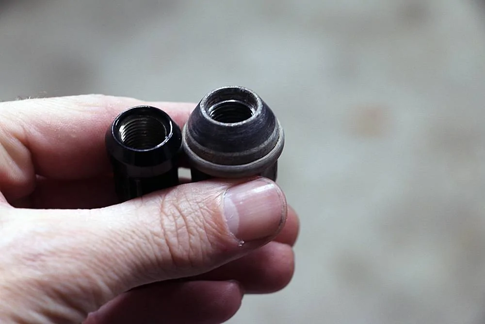

You are just looking at the taper. The taper could be bigger or smaller depending on how thick the rim in that spot is. And to be honest, that taper doesn't look like anything has actually seated on it, it looks really clean/untouched.
Look at the lugnut itself. The spot you are looking at may or may not get hit when torquing the lugnut, the time between when the lugnut touches the wheel, to when the lugnut centers the wheel on the stud. The lugnut itself is the best spot to look at what is actually contacting.
nothing has touched it because the lug nut doesn't touch, lol! the lug nut is in the picture. did you think that was a picture of a hole in the wheel?
I went through the same thing you are right now on several sets of wheels, for several different cars. You have to compare the markings on the lugnuts to see how much of each lug nut touches. What I found when I did this was the factory lugnuts touches just as much surface area as the smaller diameter aftermarket lugnuts.
Easiest way to do this. Paint the taper on the factory lugnut, and the aftermarket lugnut. Use a white paint pen. Torque one set of lugnuts on, then the second set. Compare the two. You will see how much surface area actually touches on each lugnut type. I have never had a factory lugnut that 100% touches. And on several sets, the factory lugnut actually touches less than the aftermarket, smaller diameter lug nut.
Or keep trying to hammer a screw. What do I know.😏
The standard ford nut measures :
Max OD (over stainless cap) : 30.75mm
Max OD (of the ford taper) : 27.10mm
Max OD (that actually contacts the taper in the wheel) : 25.00mm
I found the last measurement using dry wipe marker on a standard nut and torquing it up, it was also a good excuse to try out my new 24" breaker and socket that I got for birthday :
Diameter needed to cover the silver masked area on the PP wheels : 28.00mm (approx) :

Are you saying these two lug nuts on the same wheel wil1 have the same amount of contact? That seems impossible, but my next step was to spray plastidip in the taper and see how much touches the factory lug nut.

Fwiw, I have had 5 sets of wheels and 5 sets of lug nuts, in both large and small diameters, and the seating areas are not identical on all of those.
You can see where the contact has worn the metal bare. Large do offer a slightly larger contact area. Will a small diameter lug be unsafe? Idk probably not, but it looks bad and why not get some that fit better?

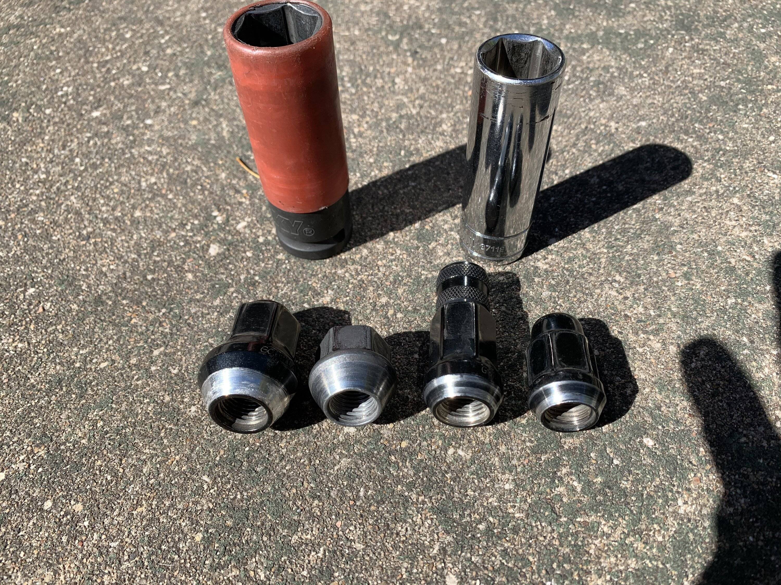

You're running tuner lugs. Tuner lugs are for aftermarket wheels with very small lug pockets. Its a style thing. The setup you have is totally safe but it looks kinda "hotdog down a hallway".
In general though, Gorilla is the answer. They have tuner and acorn lugs, they come in silver and black. They're high quality, and nicely made. There are a lot of knockoffs out there make sure you get genuine ones.
