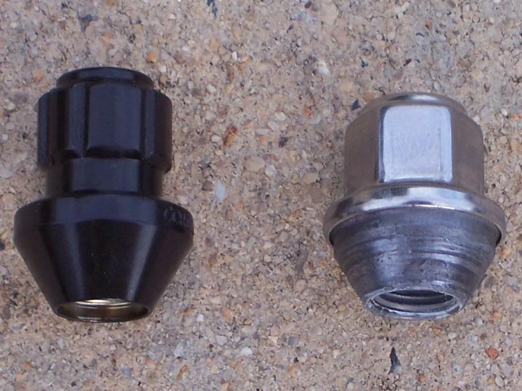

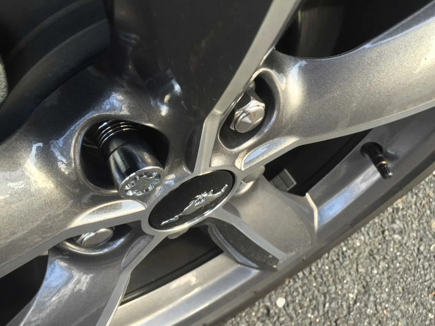

Be careful guys !!!
The key phrase here is: Conical Seat Type = Bulge
I'm using Gorilla Wheel Locks 96643BDX. With these you will not see the "Silver Ring" of aluminum wheel showing around the smaller standard conical seat lugs, meaning you do have the design full Conical Seat contact area !!!
I found them at:
http://www.summitracing.com/parts/gor-96643bdx
