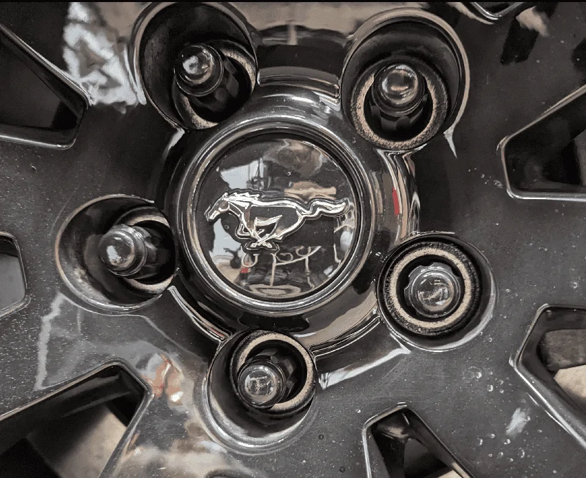

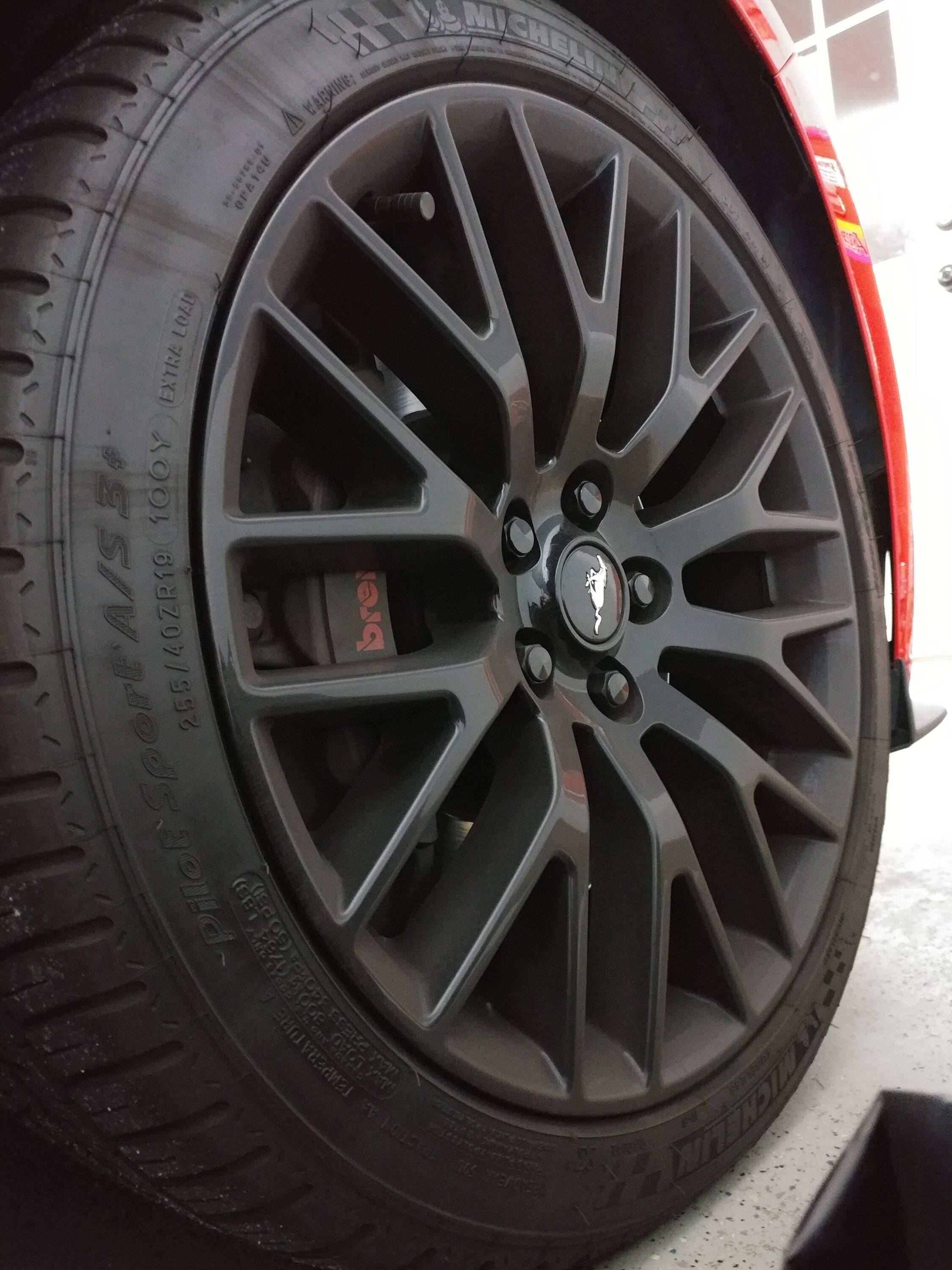

Maybe i'm over thinking it. Can you see the taper on your wheels with them installed?
You can, but I wouldn't call it super obvious unless you're a) up close and b) at wheel level
Edit: wow my wheels are filthy, lol
No offense but that seems very unsafe. There's a lot less contact surface from the seat of the lug nut cone to the concave cone of the wheel.

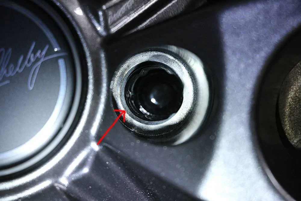

OP, look at hte contact patch on the factory lugnut vs the ones you installed. You will probably find it's the same size as the small diameter lugs you put on. That was the case on my GT350.
I installed OP open lugnuts. makes life much easier than the closed end lugnuts. And just my opinion, the yellow looks awesome on black wheels.
You can see the contact patch of my stock lug nuts in the picture, it's huge! you can also see how much of the taper is not touched by the small diameter lug nuts, but here's a red arrow pointing to it. it's a couple of mm worth of seat not being used.

yours look about the same as mine maybe a hair more engagement. i have 06 small diameter spline lug nuts. 06 uses 1/2 inch, i think yours are 14mm. clearly this isn't an issue or there'd be a lot more wheels falling off, but it doesn't seem like a great design either.
You are just looking at the taper. The taper could be bigger or smaller depending on how thick the rim in that spot is. And to be honest, that taper doesn't look like anything has actually seated on it, it looks really clean/untouched.
Look at the lugnut itself. The spot you are looking at may or may not get hit when torquing the lugnut, the time between when the lugnut touches the wheel, to when the lugnut centers the wheel on the stud. The lugnut itself is the best spot to look at what is actually contacting.

going to try these. they are the same length and right thread pitch, plus they are 1 piece (nevermind, more than 1 bad review saying they strip out, wth?)https://www.amazon.com/gp/product/B09MTDDQB6/ref=ox_sc_act_title_1?smid=AIHVL468YWUM0&th=1 they are 23mm wide, the ones i have are only 20mm. There's only two kinds of tapers, 60deg and 45deg. I assume these shelby wheels are 60deg like most wheels. According to google only some racing rims use a 45deg taper.
