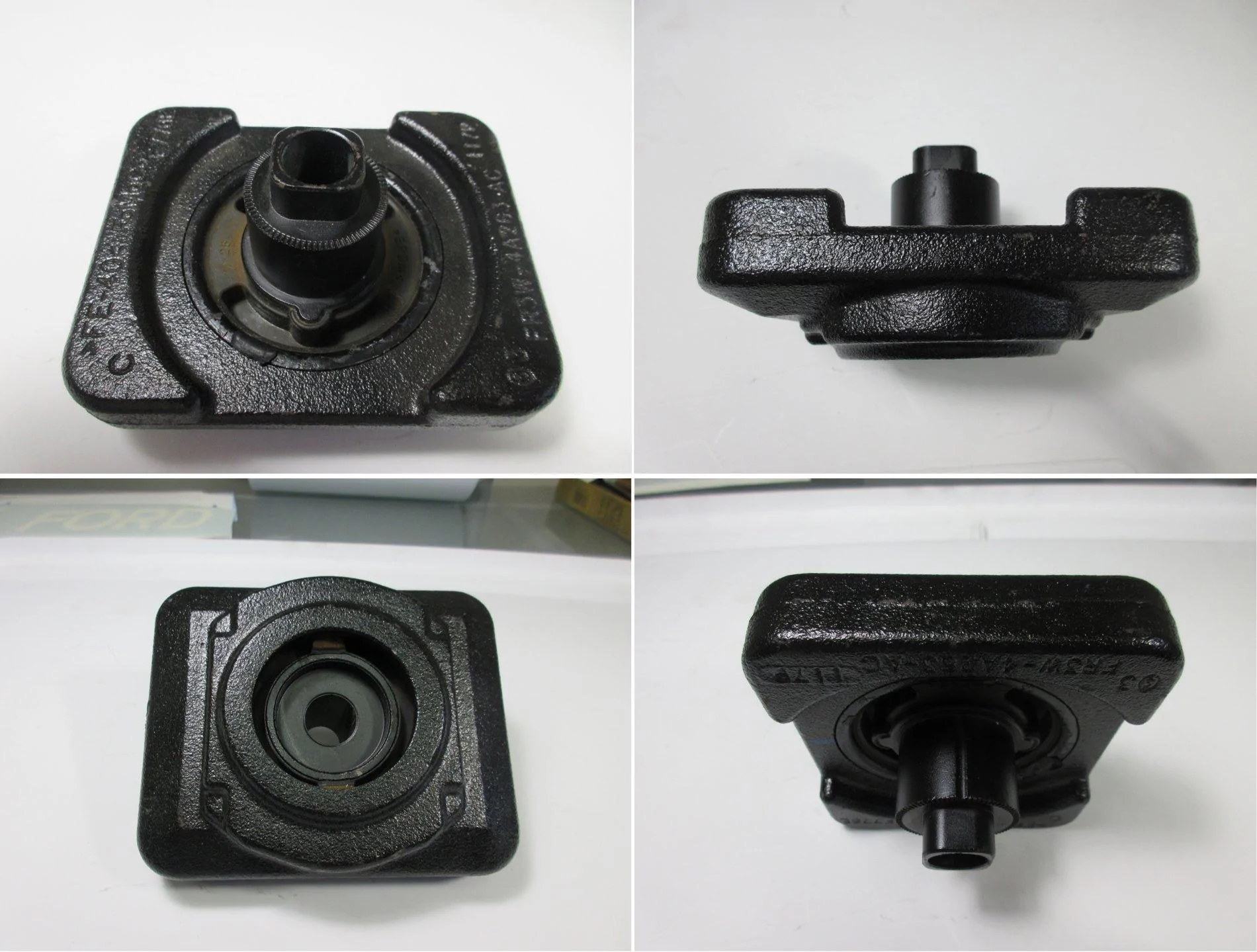

Well the results are in;
The factory steel sleeved right rear Diff. bushing needs a counter bore to allow engagement of the male portion of the damper center hub.
I may decide to machine the male nipple off the hub in the near future.
For reference this is the same for both Dampers.
15-17 Ford (FR3Z-4A263-A) https://www.quirkparts.com/oem-parts/ford-damper-fr3z4a263a
2018 Ford (JR3Z-4A263-B)
Wish I had better news.
The JR3Z-4A263-A Damper is used on the 2018 models
The FR3Z-4A263-A Damper was earlier models
Here is a close-up of the: FR3Z-4A263-A Damper
Weight: 4 lbs, 3.1 oz

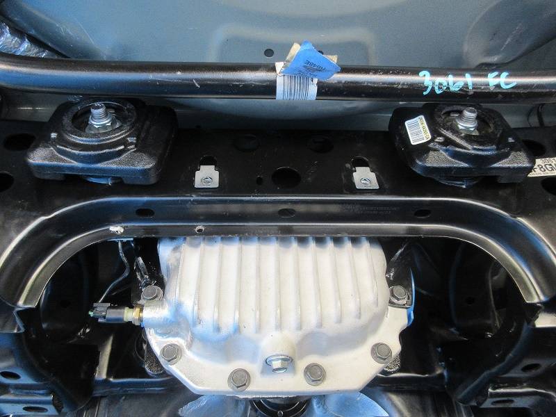

I have done some experimenting with these, I am currently using two dampers, attached to the rear diff bolts.

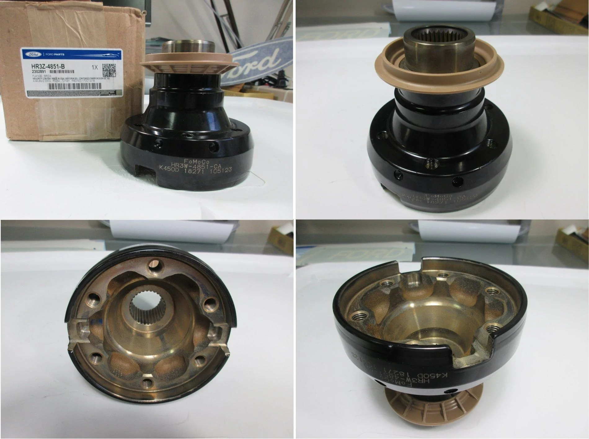

Here they are.
Here is a close-up of the: HR3Z-4851-B Flange
This is a lot nicer looking piece than what was used on the previous models. (They were un-painted, and rusted very easily/quickly)

I wasn't able to get my FR3Z-4A263-A Damper installed on my 17 GT. The spare tire well is in the way.
