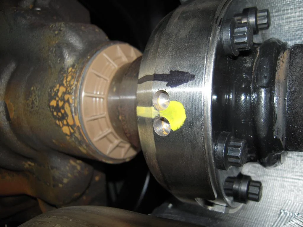

Had an interesting email conversation with an engineer at Dynotech this week. He says the yellow paint splot typically marks the heavy part of a rotation, and suggested putting the yellow spot of the pinion yoke 180 degrees from the yellow spot of the driveshaft, so the heavy parts would cancel. What was odd, at least for my stock driveshaft, the yellow spot of the DS was probably 15-20 degrees off from the yellow spot on the pinion. Now, was the factory fine tuning the assembly, or did someone just slap it in that way? Not sure, but I do know the factory assembly was silky smooth.
ABS550
Aug 4, 2016
50
Calgary, AB, Canada
2015 GT

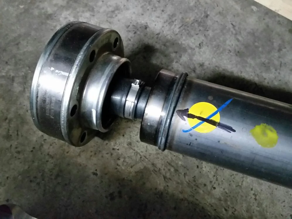

Mine looks very similar. Picture back on post 1773.
www.mustang6g.com/forums/showpost.php?p=1431200&postcount=1773
You can see that they tried to line up the yellow dots to the nearest bolt hole. Mine were off a similar 15 or 20 degrees.
It makes sense that they would mark them and try to line them up. BUT, it would make the most sense if they marked the LIGHT side of one and the HEAVY side of the other one, then try to put the dots close together. (line up the dots)
If they mark the HEAVY side on both, then the dots would need to be on opposite sides which is visually, less practical. (more difficult to do correctly)
Maybe the dots are marked incorrectly on some parts? Maybe some have the dots marked on the light side, when it should have been put on the heavy side etc.
Also if you look at my picture and where I had to add the weight, it was exactly in line with the dot on the pinion side. So maybe when the lined up the dots, they did it to the nearest bolt, but that was not good enough to balance it. If that is the case, then moving to the next bolt hole wouldn't work anyway. As mentioned in an earlier post, it may be possible to place a washer under a bolt, as a counterweight instead of using hose clamps.
If would be great if someone from Ford would chime in to shed some light on the factory assembly and balancing procedure etc.
That's exactly what I was thinking. Short of taking a dynamic measurement of the DS and the pinion, it's anyone's guess which is heavy and which is light, etc. Unless, of course as you suggested, someone from Ford were to chime in here.
I like that idea, but doubt a washer would be enough.
Anyway, I'm going to swap out the shaftmasters for the dynotech and go under the assumption that the mark on the factory shaft is the heavy mark, so that's the way I'm going to install the dynotech - yellow to yellow. The shaftmasters shaft really doesn't have a similar splat on it. (There is one, but it looks more for assembly of the slip tube to the main part of the shaft.)
Edit - after looking at the pinion yoke some more, it's kind of obvious what the factory did here - note the balancing holes drilled into the pinion? It's gotta be to counter the heavy side of the DS. Splat to Splat. Look how much more weight they had to take out of your yoke than mine. I'm guessing they've tightened up the tolerance on the DS weight imbalance. And since the DS splat doesn't line up precisely with the yoke splat, that tells me they pre-drill the yoke for a certain amount of imbalance, then line up the DS as close as possible to that spot. If the DS is out of tolerance with the amt of mass taken out of the yoke (either a lot more or a lot less), then your new stang is going to be more like a vibe rider they sell for harleys. The only perfect solution Ford could do would be to remove the *exact* amount of mass at the *exact* right spot of every yoke mated to every DS, and they aren't going to do that on a mass-produced car.

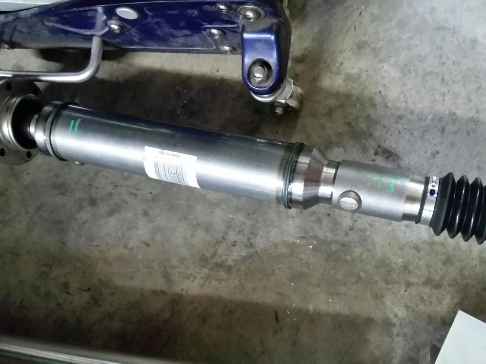

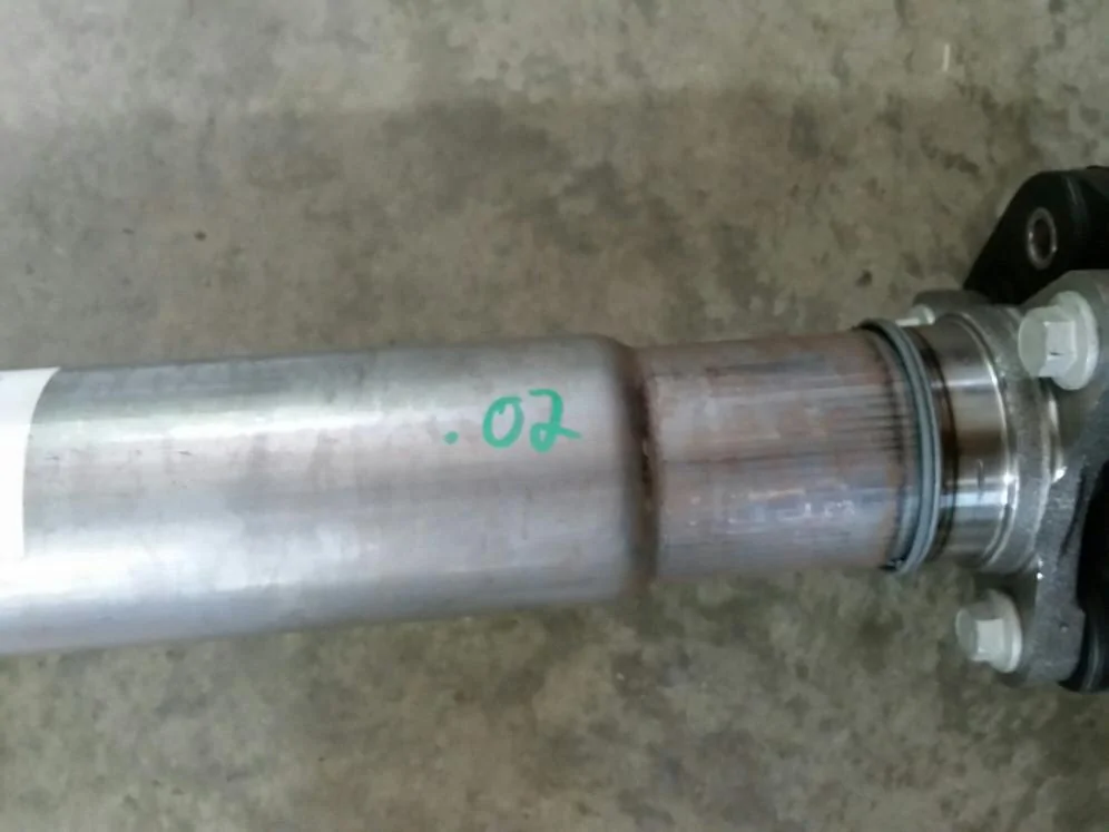

A couple more shaps of the factory shaft. Note the balance weights marked in green pencil. .11 at the tail nearest pinion. .13 at the carrier bearing and .02 at the guibo. Dunno why I assumed they were runout numbers, but bet they are balance weights.
I'd be dang curious to see the pinion balance holes/splat on the guys with problems compared to what their DS weights are.
You would be surprised how little weight it takes to create an imbalance or to balance this assembly. In my case, one hose clamp was too much weight. I had to add a second one and spread them apart (approximately) 150 degrees, which means they almost cancel each other out.
Look at my earlier post 1773. I tried one hose-clamp on the opposite side of the DS in my first balance attempt and took the car out for a drive. Once I got to the highway, I had to slow down and drive with my flashers on because if I went up to highway-speed it felt like I would shake the car apart. I limped home.
That is just one hose-clamp in the wrong location! Not a lot of grams there.
Others in this forum have reported using one or two washers under the correct bolt as a good fix.

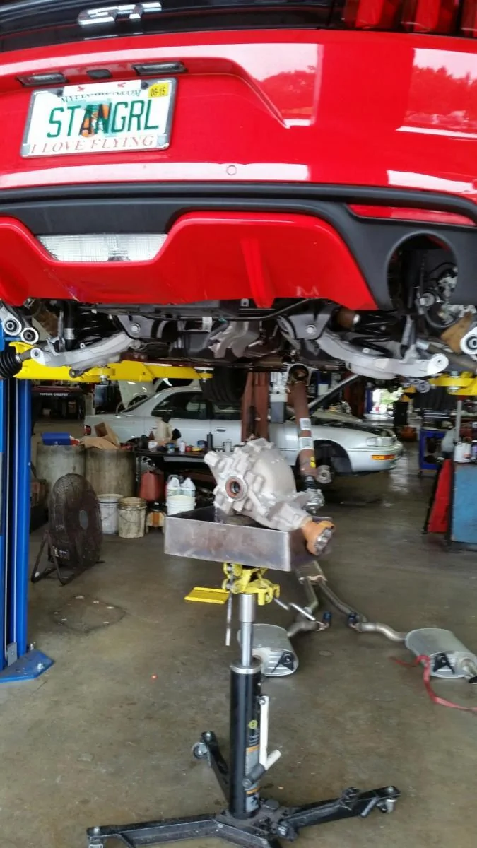

Another update - I have the car back, dealer has ordered an entire rear assembly from Ford, will arrive in a few weeks. They also test drove some of their own new inventory to benchmark the vibration against my car and discovered that their new ones have the issue, but worse than mine! They also put it up on a lift and noted that the vibration is definitely related to the driveshaft system. They seem willing to do whatever it takes to get to the bottom of it, fingers crossed the new assembly will fix. I'll update in a few weeks :)
BOBS550
Jul 16, 2015
207
155
Port St Lucie Fl
Bob
2019 Mustang GT Auto Race Red
My daughter had her`s replaced and that did the job no more vibration:hail:Good Luck
