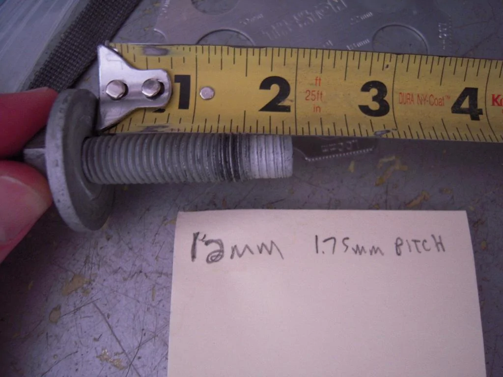

In case anyone on this thread wants to shim down their transmission crossmember- the stock bolt is an M12 1.75mm pitch with about 1.5" of threads. I was just under my car monkeying with this, and with .25" of shims, it is cutting it very tight (i.e. the stock bolt doesn't have many turns on it.) I'm going to swap the stock bolts with something longer this week.
edit - went to Lowe's last night and they had M12 1.75 in 60mm length in stock. $2.50 per pack of 2 bolts. Worked like a champ for over .25" of shim. Might be a little long for anyone doing less than .25" of shim. Lowes also sells a 50mm length M12, which might work better for less shim.
