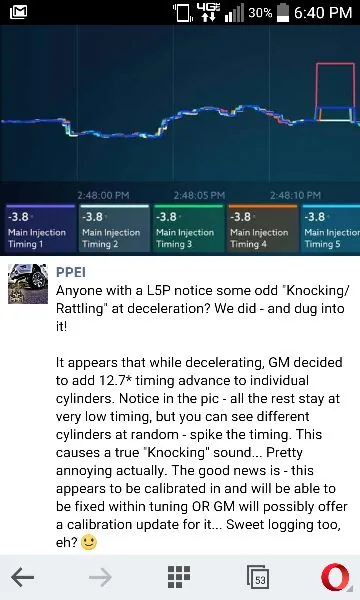

The new Duramax L5P has a tap sound mine does it sounds exactly like the coyote bottom end tap literally sounds like metal on metal. My tuner found out that its due to GM advancing 12.7* of timing to certain cylinders while others have low timing. GM now has an upgraded calibration that completely removes the knock/tap after I took mine to the dealer they flashed the computer and now its gone.
Also GM stated in a TSB back in 2003 I believe that the Duramax typewriter tick is from microscopic air bubbles in the oil exploding between the crankshaft and main bearings/rod bearings which causes the noise.
