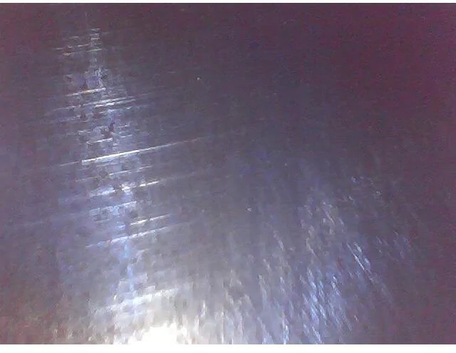

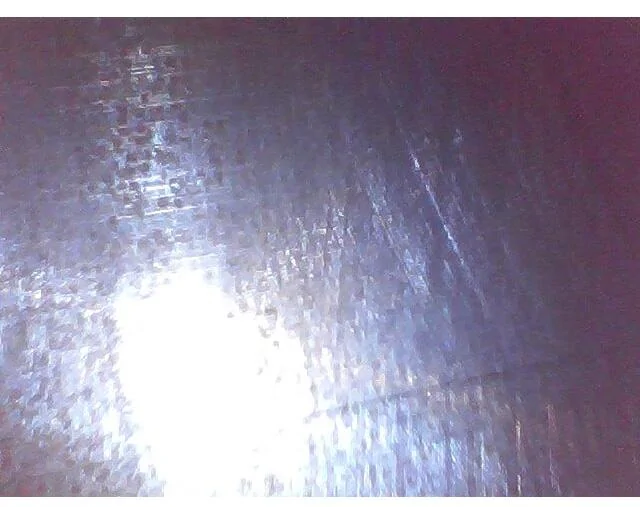

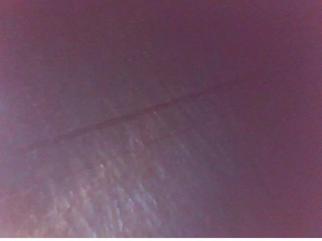

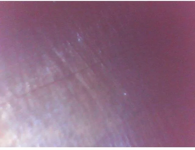

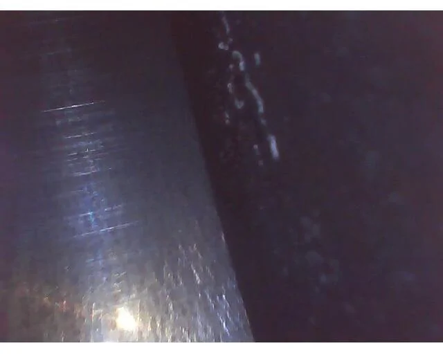

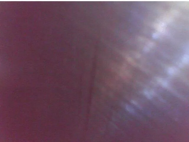

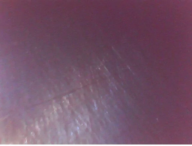

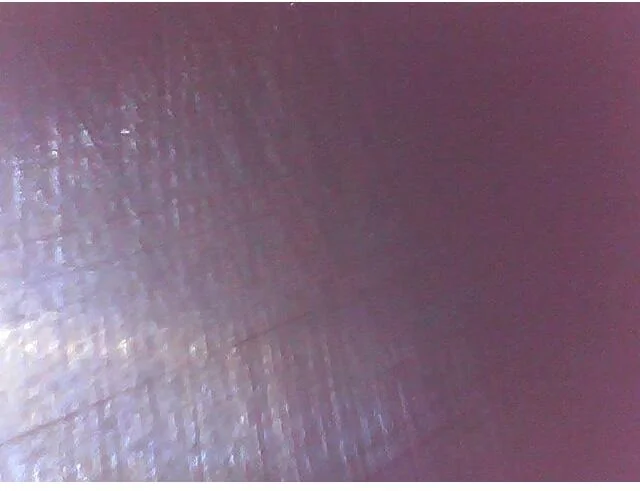

Some of the OPs pics:

whats in those pics? nothing but some odd marks...show me some vids of smoking tail pipes and bad oil samples and I will kiss your asses....yah gotta put 1100 hp to get em to blow from what I have heard on here …and just an offhand guess I think 2/3 are v-8 and company trucks aint babied

I don't want to throw a monkey into this wrench, but I am an engineer, and I wanted to get a second opinion on these pics above to reaffirm my own metallurgical knowledge and suspicion. So, I stopped by the local Roush dealer and talked to their Ford certified master mechanic. My opinion is supported by all of them that saw these pics.
The marks seen in pics 2,3 and most noticeable in 4 above, is NOT excessive scoring found in a 200,000 mile engine block. The most noticeable marks seen in pic #4 are absolutely normal wear marks found on almost every newer engine during break in. What looks like pitting is usually some carbon buildup on the cylinder walls. There will always be some wear marks, and those marks with only 10,000 miles appear to be completely normal.
That said, I do believe any piston slap "could" lead to a problem down the road, especially if poor lubricants are used. Thus, engine damage can result, but this is not the case in the pics above.
I also believe it would behoove Ford to come out, and publicly acknowledge the ticking issue, and search for a way and offer customers potential solutions before the bad press goes viral, and destroys the company. The noise is far too common to claim it as infrequent now. However, it does not appear, based on this design, that the minor tick/slap is indication of absolute imminent engine failure or even that it will affect its longevity.

I worked for a company that repaired plated engine cylinders that came in NiSiC, Chrome and electrofusion (similar to PWAT). Marks in the cylinders in the pictures above, usually could not be measured and were not an issue. Cylinder damage from a partial seizure could sometimes be cleaned up without any real damage to the coating by just removing the aluminum on the bore. Gouges from broken rings of course required the coating to be stripped, damage in cylinder tig welded, machining out the and the cylinder re-plated and re machined for correct piston to cylinder wall clearance. Porosity was usually not an issue as the pores in the coating helped to retain oil which is a good thing. The main problem with chrome plated bores in the past was they were too smooth and were not good at holding oil...Think of a waxed car hood and how it sheds water. What I would add to this conversation is the coating is a lot tougher than most people realize, especially in 4 stroke applications. It may be thin but it is much more wear resistant than cast iron liners. Heat transfer is much better, there is less friction, you can run tighter piston/cyl wall clearance and the finished product weighs less. Of course the cylinder geometry needs to be good, round with no taper, with the proper clearance.
What we need is for someone to completely tear down a "ticking" 5.0 and check all the critical clearances and find out where the excessive clearance is, if the tick is caused by this.
