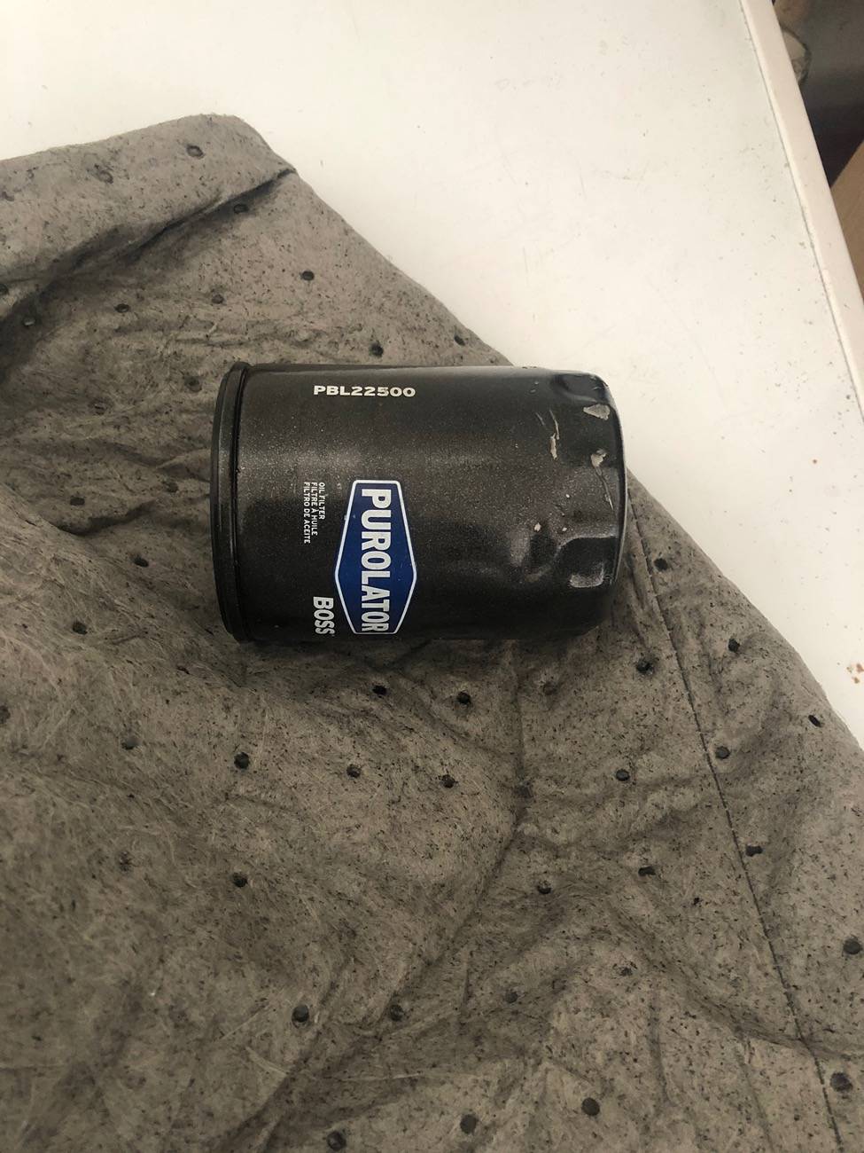

I have a 2020 pp2. It happened after the first oil change then a lady, at the dealer, told me to use the attached filter, 44,000 miles later it is still going strong. Are you talking about this in the attached video? If you are, mine was fixed by using this filter for every oil change.
Yes, it’s the same sound.
So yours immediately went away just by using different oil filter??
You didn’t do anything else to it? Not even changed oil to a different brand?

Nope, didn’t do anything else. During the course of the noise I filed a claim with Ford and was told that it’ll go away which it didn’t till the tech at the Ford dealer suggested that to use this filter. Was told by Ford it’s normal that it’ll not affect the performance of the car. Noise was annoying especially when sitting between 2 cars at the light.😞….if this is the same noise you’re experiencing, give this filter a shot. Good luck!

Sorry…the response to the first question is YES! It went away immediately.

Strange… I haven’t seen anything regarding this tick and oil filter anywhere… This is the first time I’m seeing an oil filter related to this.
