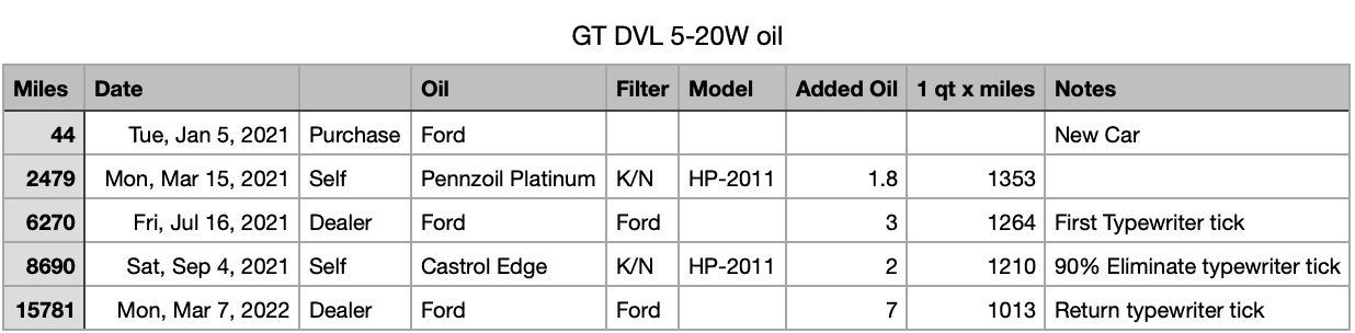

I posted this oil consumption spreadsheet on my post concerning burning blue smoke, which has now converted to a long block replacement.
What is curious and maybe worth asking is, Does the typewriter tick only happen when dealerships change the oil?
At home I Pre-fill the oil filter before screwing it on. Is it possible that after 5,000 miles there could still be air left in the filter housing, assembly, channels etc. causing the famous tick?
Could it be related to the OEM Ford filter, if yes, why does it not occur on Dealer lots, but does occur after first dealer service?
I have only changed the oil four times, so it can hardly be scientific, are K&N filters somehow related to eliminating the tick, What brand oil filters are being used and what is the result of typewriter tick?
Personally I am very interested in preventing any tick at all, especially if it can be done without the use of additives!
I dont think it has anything to do with the filter or oil changes at the dealership vs a shop or doing it yourself.
Notice that when you choose your own oil, it doesn't? I bet it is because Pennzoil and Castrol have more Boron than dealership Ford oil (which I believe is different than the oil used at the factory). That is what Ceratec contains.
