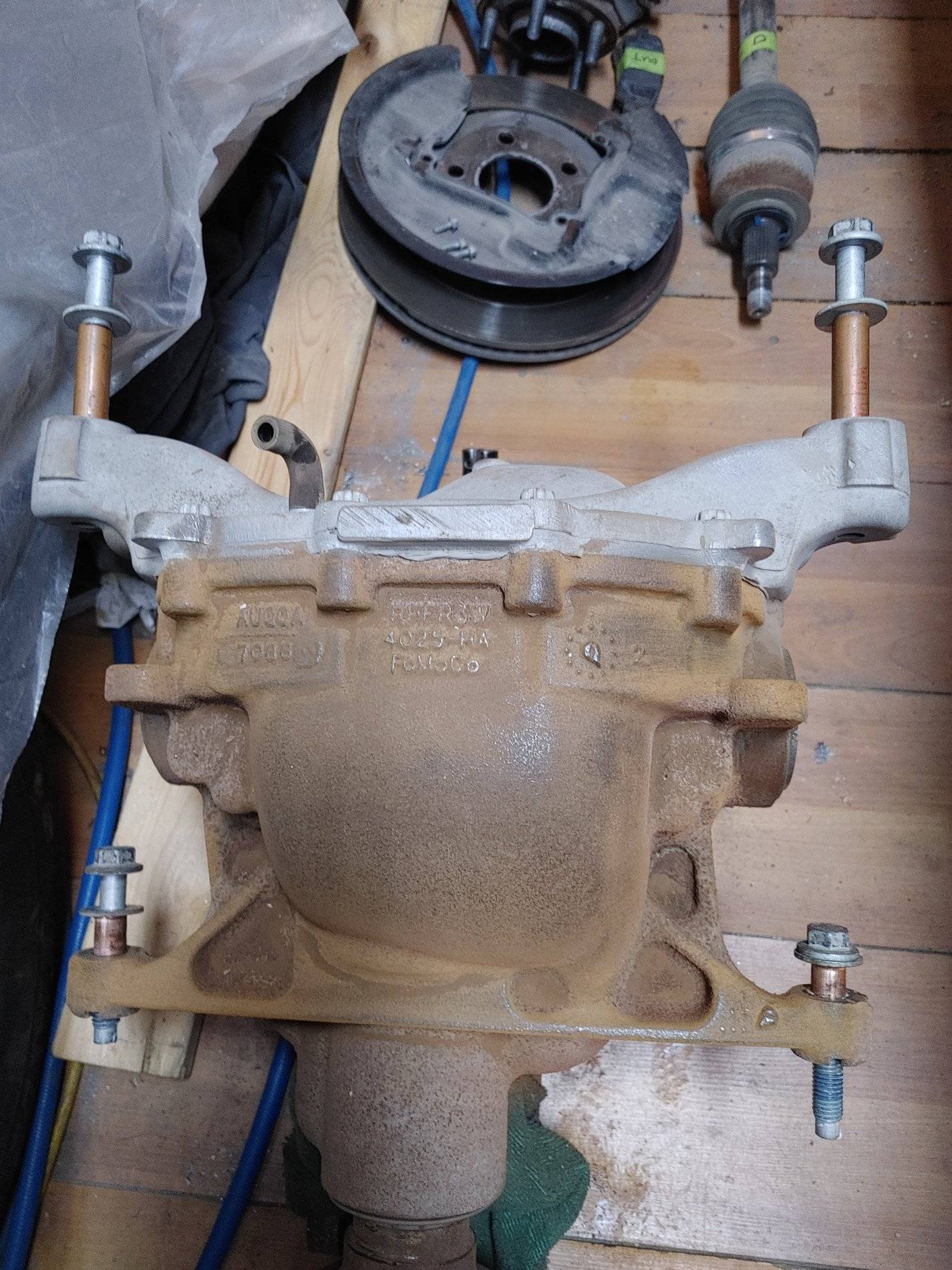

WildHorse
N/A or GO HOME
Jun 28, 2017
270
10,297
8,350
Home World: CLASSIFIED
Puddintane
'17 S550
My fix. Added sleeves. Bushing were mint.

That is definitely the ideal solution if your bushings are still intact.
Yes Sir. Just gotta find large enough washers for the front of the bushings to capture them. I mean, that's all really what the aftermarket does anyways. I can grind them down to the shape I need no problemo.

Has anyone used inserts and a sleeved bolt to repair torn bushings?
If the bushing is torn, you replace the bushing.
