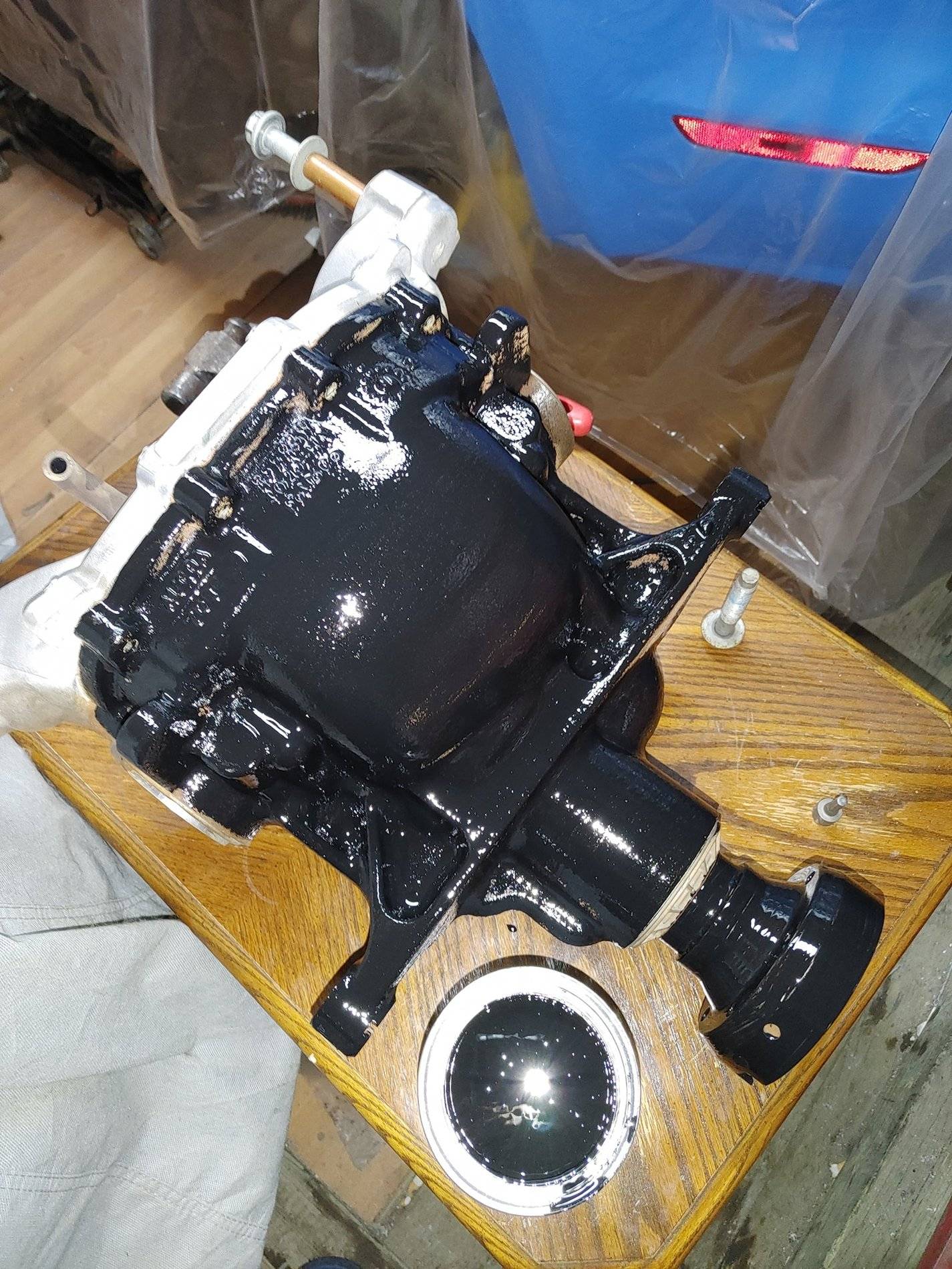

Pass. Locktight and proper torque specs is all you need with stock bolts. If your aftermarket bolts are coming loose then ditch em.
Edit. That's kinda safetied wired but not really. And Why do you have the bolts running through the backside ?

Smart move there TeeLew! You were eliminating the need to have to drop that cradle in order to check the bolts periodically. I wish I had thought to do that. I’m going to look into having an 18mm wrench modified to use for re-torquing without having to drop the cradle. What a PITA to do with no helper.
