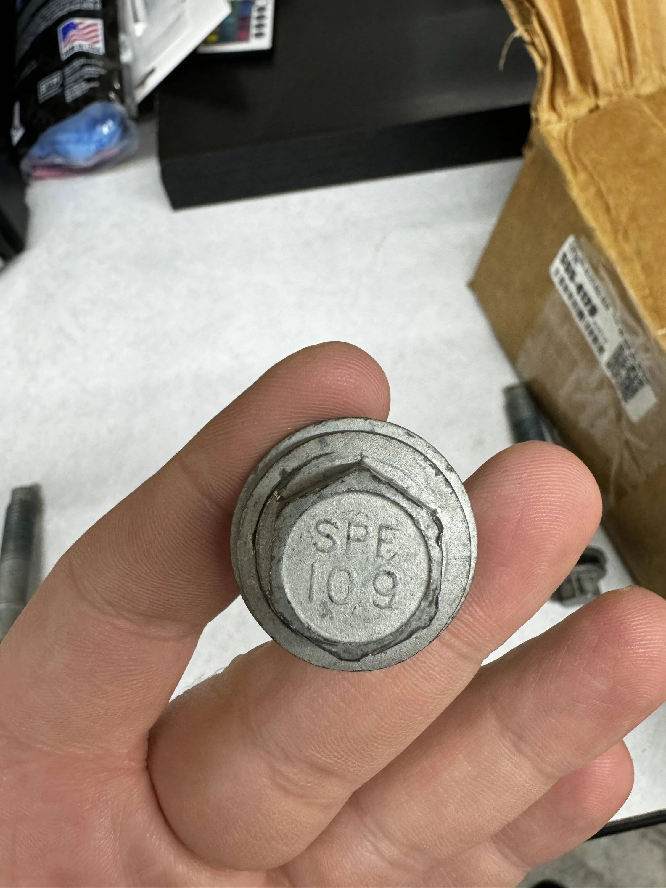

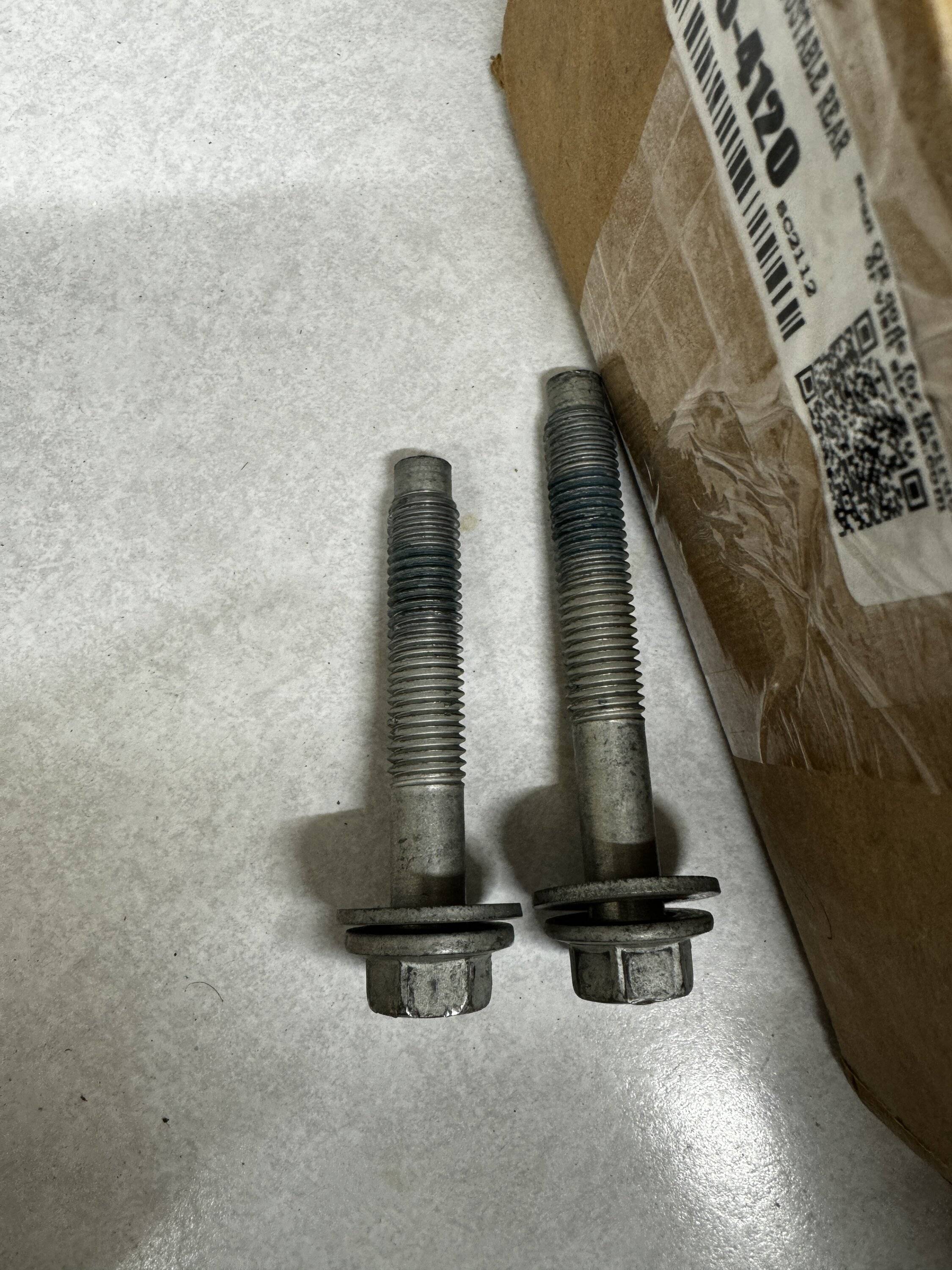

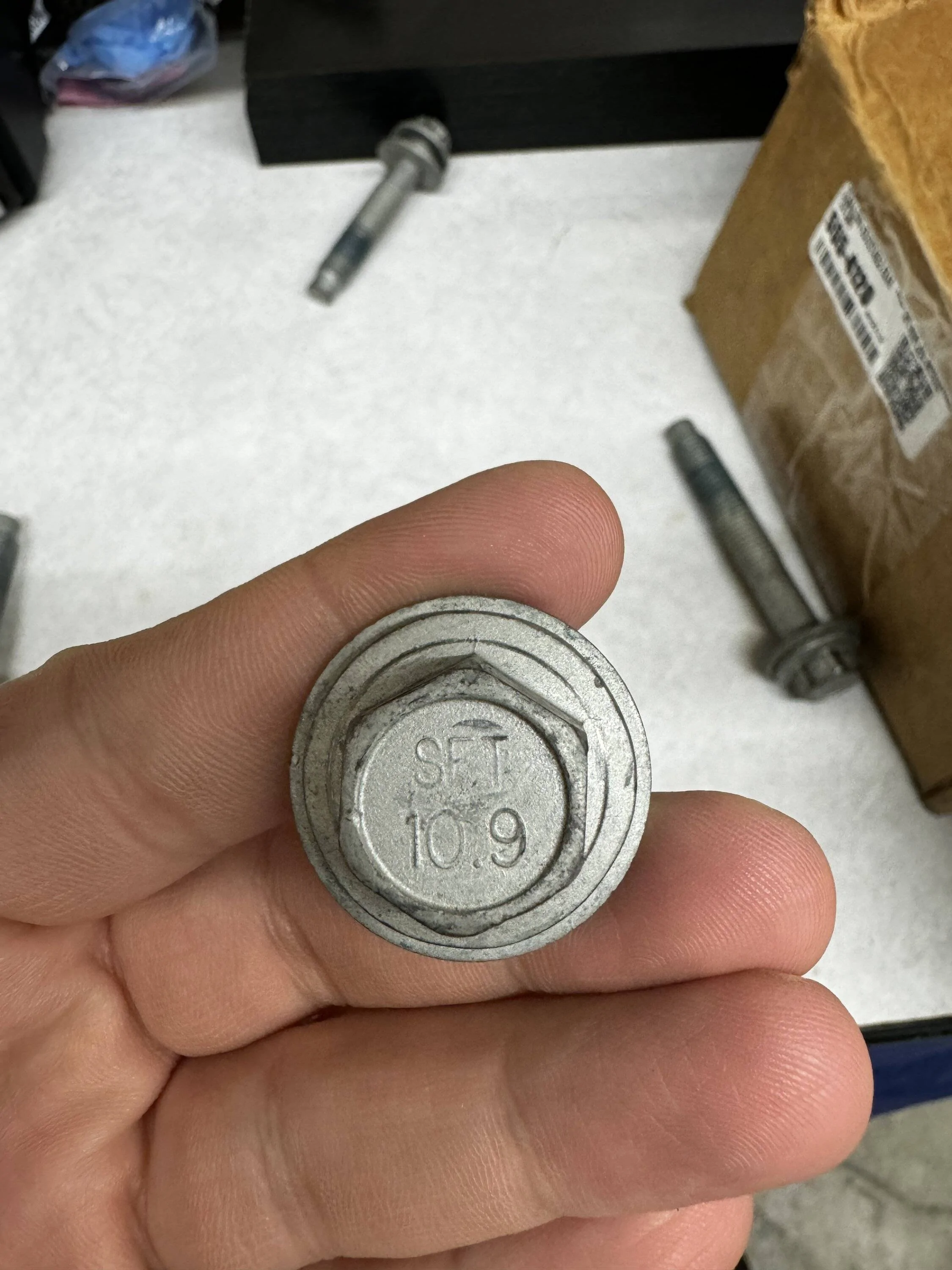

super random question but i am taking out my steeda diff bushing inserts cause of the crazy diff whine im getting and the rear end clunky sounds nothings wrong just an annoyance. however i dont remember which oem bolt goes into the diff bushings. i have two sets each with a different number on the head with two different lengths. same thread pattern. does anybody know by chance?

To answer your question, the long bolt goes on the rear passenger side with the funky doo-dad weight thing.
