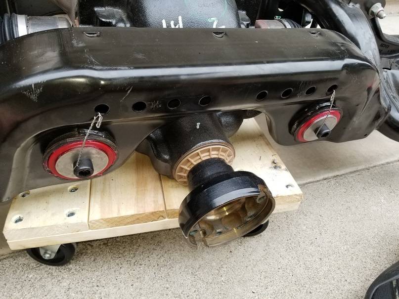

I sourced my own 12.9 bolts for everything except the backside of the front mount. Those have to be hex-heads (There's no room for SHCS) and I couldn't easily source a 12.9 hex head of that size.

+1 on the Loc-tite. I also safety wired them, pretty much because I'm 'that guy'.
